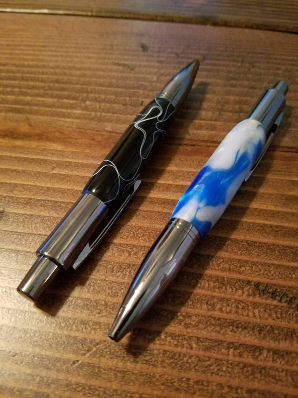

doesn't seem to exist. At least I can't find it. I want:
*Solid & smooth click mechanism
*Blk. Ti or Gunmetal. NO black chrome as on the front section of most all Sierras. A small amount of chrome would be OK. No gold.
*No longer than 5.25" long
Any suggestions?
Thanks inadvance
I found this photo on Etsy. Does anyone know what kit these are?

Thanks. Had not looked at the Chilton, I should add to my description that I want a single body pen. Long Clicker and (I suspect) the Long Boy are both over 5.25" long.
You're really restricting yourself by the 5.25" length.
My go-to clicker is the Sierra click in a nice plating - just about any plating without the black front ... but it is longer.
I also like the Long Boy, but there again ... over your length.
For a shorter length, try the Sierra Elegant Beauty (or maybe the Elegant Sierra).
Also check on the Aero Click (but I don't like the shape of the button).
I could live with a little longer, but Sierra is only 5.25, so is Virage. Of course they do not have click buttons sticking out the top of them. I just measured a Sierra Click at 5.75. I will probably have to do some compromising.

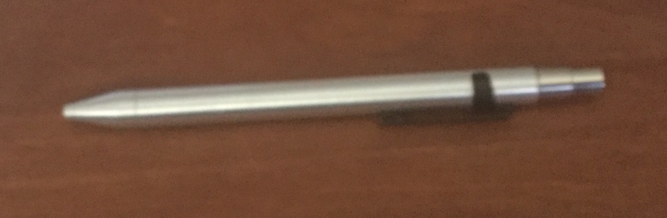

By far the best click pens are kitless and use the Schmidt click mechanism with an easy flow refil. It is super smooth and easily adaptable to many styles. My favorite is made with a piece if 3/8 aluminum tube. No need to drill, just tap. For these I use a space pen clip. You can make bigger and use othe clips but then need to drill before tap. Many materials work for this. I make the nibs from aluminum but have done them with corian, ebonite, and bronze. All can be done on wood lathe if no metal lathe available. You won't be sorry going down this path. I've made many and everyone loves them.

Usually from Richard Greenwald. I think some others carry as well. Google may come up with some others more local to you.
I've bought them from Richard Greenwald and also from Milans Pen Parts.
