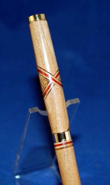

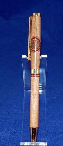

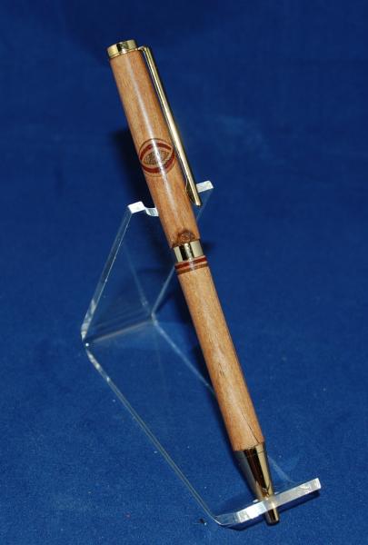

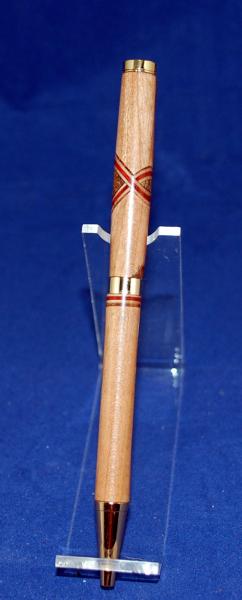

I decided to push the envelop.
Try a third segmented pen. sigh I should have opened a beer.
As you can see we had a few problems.
1. Pen was as not drilled correctly
2. Small blow out I tried to fix.
3. As I turned, a hole was revealed in the cherry next to the center.
4. When I assembled, a crack appeared near the nib.
sigh... Did you know I always wanted a house pen that looked exactly like this. (Extreme case of rationalization).
Well I, the first two were a good proof of concept. This open a learning experience. Any words that can help improve will be greatly appreciated.

If a crack appeared near the nib then use your parting tool and cut it down and add another segment to it. You can use your mandrel as a clamp if you want to. I really like that top segment it looks great.

I also like the pattern at the top. If that is the result of the off center drilling, then I wouldn't be offended at all by that. I think the proportion looks good.
I think your 'bad' one looks about as good as the upper end of my typical, so I have some more work to do!
