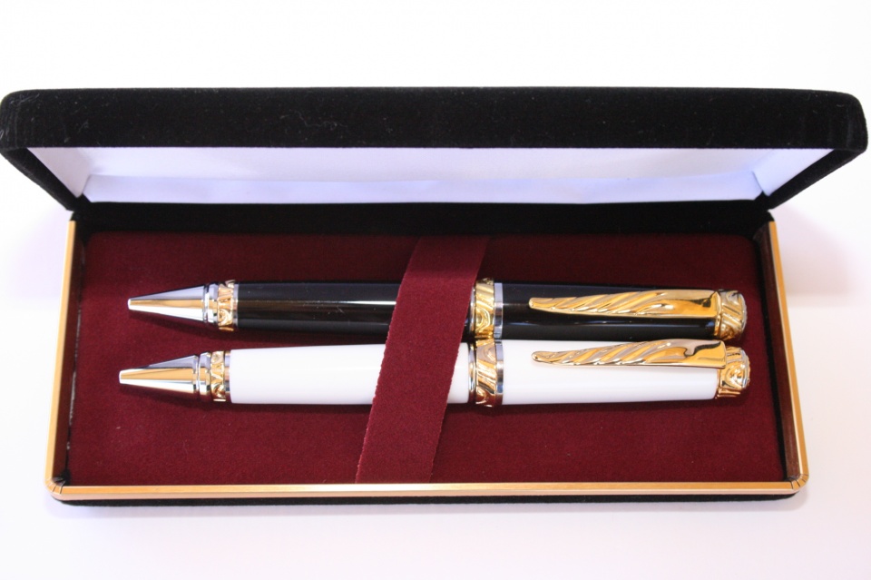

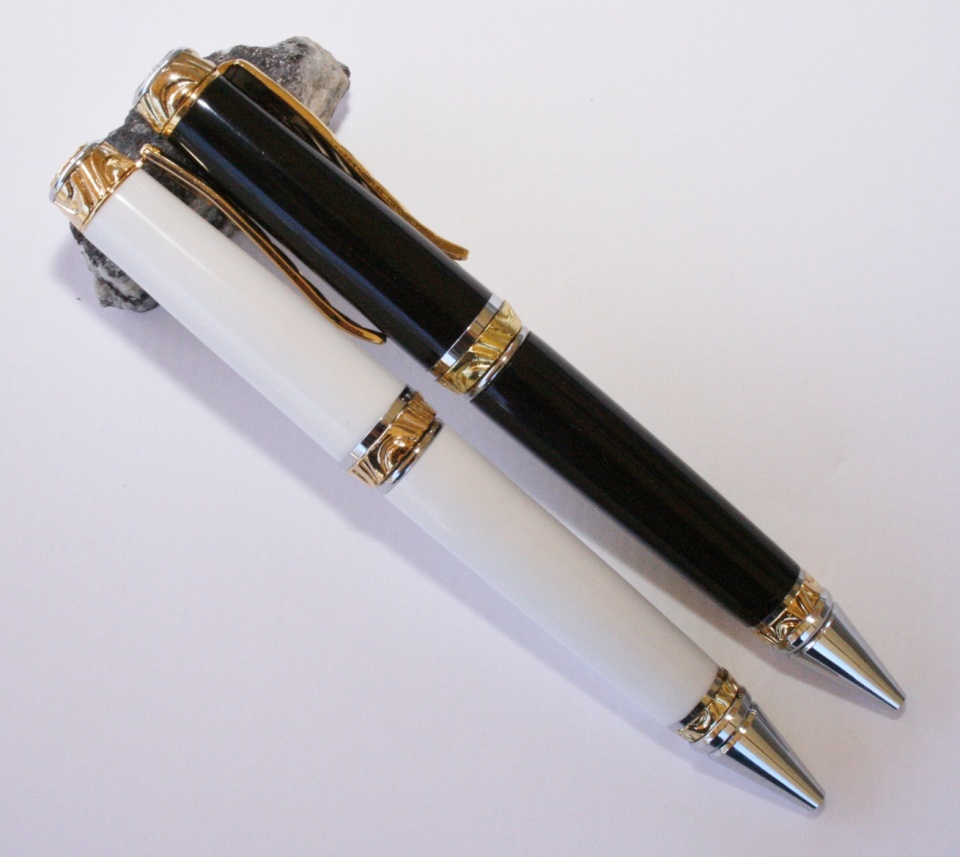

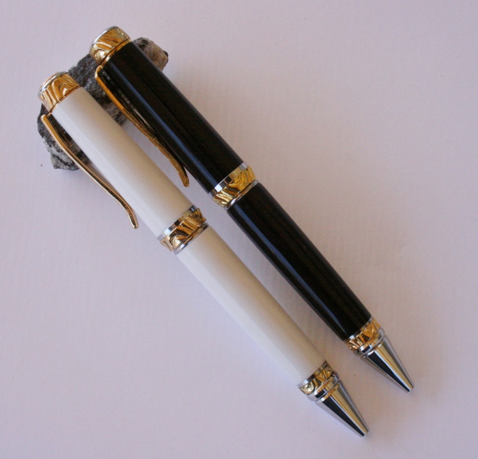

I've been wanting to do this set for a while. I wanted to do both in Corian but I couldn't find any black the right size. Fred (Ptownsubbie) sent me some black alumilite blanks that I was planning on using. I cracked the first one while turning it, the second one I used two short tube and didn't realize it until I had both tubes turned. The third came out nice but I cracked the lower tube when I was pressing in the nib section. I was about to give up when I remembered I had a black acrylic blank. I used my roughing gouge to turn all the blanks. I wet sanded to 12000mm and polished with Hut plastic polish. I'm call this my Wedding Set. If some need a black and white set for a wedding I'm set. All C & C are welcome.

Beautiful set Dan! Those are really nice!
Sorry you struggled to get there. Maybe your split pieces can be cut back to the tube and a piece of contrasting material can be added on for a segmented blank.
Thanks for the wonderful comments. Charlie that's a good idea but it's a bit late as I trashed them. Cody the kit is an ultra cigar chrome with gold accents.
Really great pens, Dan !! Congratulations !! I think you should keep them and give them to yourselves on your anniversary :smile::smile:
The white one .... is it Alumilite ??
My heart aches for you having problems with the black one. I have started reaming out the brass tubes just before pressing in the nib and other hardware pieces. Sometimes I ream out a little too much and I need to epoxy the pieces together. But I don't have any more problems with the beautifully turned and polished blanks cracking when I do the final assembly.
I bought a set of adjustable tube reamers ... takes a bit of time to get the adjustment right, but I think it's worth the extra effort.
BTW, if you don't like the double-twist action transmissions on the cigars (I don't) you can replace them with single-twist action transmissions which you can buy at Exoticblanks. I have found that these replacement transmissions also work on the Atrax BP and on the Triton BP.
Thanks Mal for the great comment. I like your idea of keeping the pensThe white is Corian. I've been thinking about a reamer or file set.
