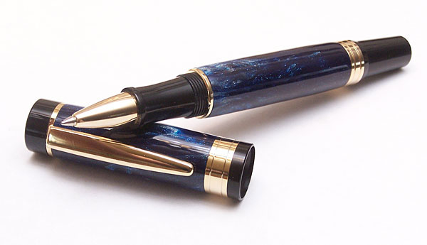

I've turned a few of those kits. One thing to keep in mind is that the cap does NOT thread onto the end finial. It will post but there are no threads to secure it on there. Besides that I do like the kit.

The meat of the blank on the tube is pretty thin, especially on the cap. If you're turning resins, be ABSOLUTELY sure you've taken care of any translucency.
Here's an El Grande I did with a homebrew PR blank (as mentioned, they're essentially the same):

I end up making the "final cut" on pr and acrylic with sandpaper. VERY little material is left on the tubes. A little difficult to make, but overall a good quality and good looking final product. For me, it sells better than a Chruchill or El Grande.

I have notice that this kit which is know as Olympian Elite or El Grande, may have more finishes (colours and band design, etc.) than those showing on the PSI web site, one example is the one that DurocShark show us so does anyone has this kit with finishes that don't show on PSI (which I have some)...??? If so, and/or if you can point me to the right direction to where to get them from, I would be willing to buy some, or exchange with any of my woods if you wish...!
I would be happy with a couple of kits each with a different finish/colours/ban-imprint pattern, then those I have from PSI...!
