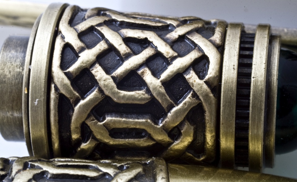

edstreet
Aug 12, 2007
3,684
No longer confused....
attachment.php
attachment.php

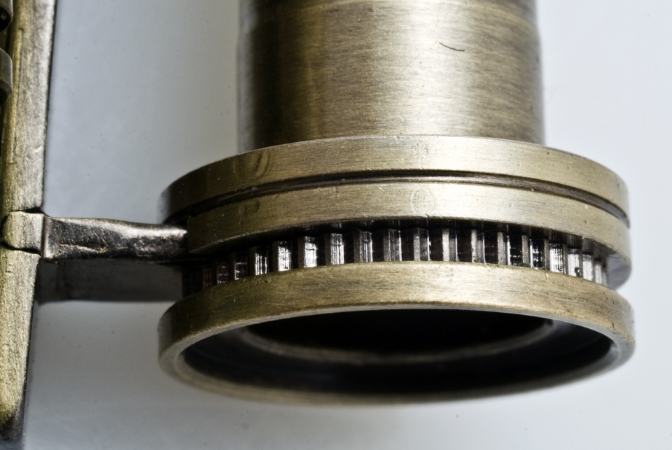

mightymavkev
Feb 13, 2013
34
Cincinnati, OH
great pic.
So on the clip piece, you can see what look like 3 rings. the two outer rings and the clip ring itself sandwiched between the two.
In actuality, I think it's all one piece but I'm not sure.
Anyway, since the outer most ring is not supported around the outside (because of the indented pattern between it and the actual clip), this part collapses when pressing the clip section into the pen tube.
I've taken the liberty of trying to illustrate what I mean on your pic by showing where it collapses in red.
I fixed the two I did by prying the ring back up with a flat screwdriver, but that metal is pretty soft and the screwdriver messes up the finish pretty easily. I did not try any plastic "prying" tools (like my set of plastic automotive panel removal tools). Those might work better.
Anyway, I haven't heard back from PSI yet on the transmission problem either. On both of mine they fit so tight into the butt that I had to destroy one of them completely with a needle nose pliers to get it back out after it "popped" inside it. Like I said, on both pens, the second set of transmissions went in much better and I think that is for no other reason than the first ones "stretched" the brass a little.

Janster
Nov 13, 2012
1,645
Nevada
...just maybe
if you have washer that is of the same thickness you could cut it in half and fit it back together "around" the clip indentation to keep it from collapsing while pressing. May need a small piece of Scotch tape? ? Not a permanent fix but until PSI remedies the problem, that should work?
TimS124
Apr 11, 2012
735
Asheville, NC
Can you use a small washer to apply pressure inside of that ring (where it's hopefully sturdier) instead of on the ring itself?
mightymavkev
Feb 13, 2013
34
Cincinnati, OH
Those are great ideas. Do you think an O-ring would work as well? Just thinking that might still support the metal enough but be softer so as not to mar the finish in any way and I wouldn't have to worry about cutting a washer.
I was looking more closely at that piece on my other two kits this morning. It looks to me that if I could find something to fit inside the outer ring's diameter when pressing that I could prevent the crushing of that piece as well.
I'm thinking I could find a simple piece of wooden dowel or perhaps another pen kit's bushing that I could use as an extension on my press pads.
So I think these ideas will help alleviate the clip portion "bending" problem.
Now to get new transmissions from PSI and try to figure out how to press the end cap over it tight enough so that it still twists without slipping and yet doesn't fit so tight that it requires so much pressure on the transmission that it crushes it inside.
I'm hesitant to try expanding the end cap's tube. I doubt I could do that with enough precision to relax the fit "just enough and not any more".
Looking at the kit pieces and I'm thinking I can try to press the end cap onto the transmission end while it is off the pen so that I can hold it by it's sides and hope that I can hold it tight enough with my fingers to allow me to push the cap all the way on. If I can manage that, it should prevent that longitudinal pressure on the transmission's internals which I think is what is causing it to fail on me.
Then I could screw the transmission into the kit with the end cap already on it.
Thanks for the ideas!

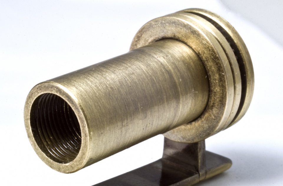

edstreet
Aug 12, 2007
3,684
One thing you could do is press them on without the transmission. Use the end cap or a small rod. Transmissions are often not that strong as they are designed to move freely and often.
There is a ring below the clip as shown here.
attachment.php
