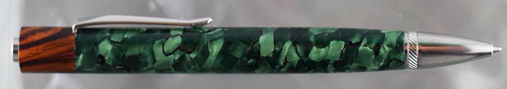

The photos I presented there, to illustrate my idea, were of an incomplete pen. . I have now completed the pen and show pictures below.
The first picture shows the pen without the cap.

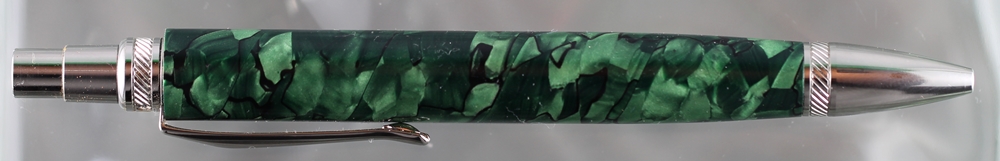

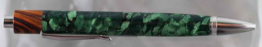

Next are shown two pictures of this pen with the cap installed. . These show the refill extended and the refill retracted.

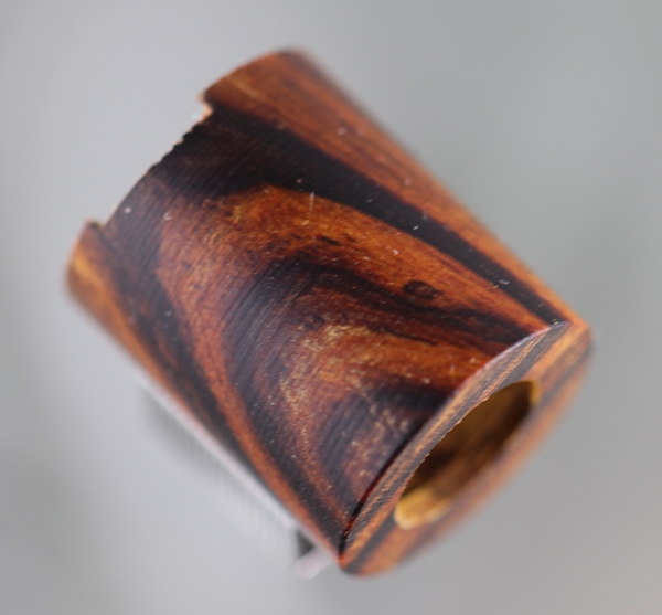

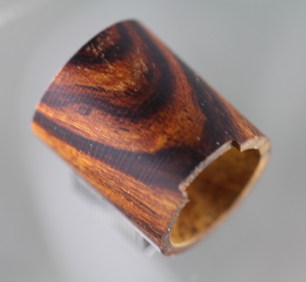

Finally, I show two (not particularly good) "macro" pictures of the cap alone, hoping to give you some idea of the cap design.
One feature to note is a recess milled to accommodate the metal piece that connects the clip ring (inside bottom of cap) to the long part of the clip.
Of course, this cap could be made of any material you wish. . I chose to use a scrap of Desert Ironwood (not finished in any way).
So please post your comments and say whether you prefer the capped or uncapped pen. . Shaping the top end of the blank (without cap) or shaping the top end of the cap (if you use a cap) can be done to suit your tastes. . In my example, I have chosen to leave the top end "square" to the pen axis.
For those interested in the green blank material, it is a vintage cellulose acetate which I purchased from one of our members. . Hope you like it.
The clicker mechanism is a delight to use ... very quiet with a positive, reliable action.

Your cap is an elegant addition, Mal. I like the look of some material above the clip - more of the green CA would have looked great too, but the ironwood is beautiful. Nice work!
This goes to show difference in people's likes. Be prepared for all!
I personally LIKE the addition and the color of the cap. I do think possibly a different color such as matching to the body. And maybe a chrome/brass ring separation will alter or even improve the aesthetic perception.
This is a perfect example where a couple of options offer minor changes that can radically change the appearance and "draw".
If I were buying, I would like the wood addition, but I wonder how a chrome ring at the joining point would look.
Another item: that wood ring lends itself to custom shaping also. The possibilities abound!
For my tastes, I'd like to see at least a hint of balance with the shape of the nose cone. The hard edges and height above the clip are the two things that just seem a bit off to me. Not much you can do about the height above the clip with this cap idea, but perhaps some shaping of the cap to be something other than a straight cylinder. Maybe even let it go bigger than that the body circumference... like the old Apex kit below.. that might be interesting.

Your opinion in that quote is what motivated me to design and make the cap piece. . But the cap could certainly be shaped a little differently to avoid the degree of sharpness. . But there is a restriction, which is the diameter of the button that pokes through the end of the wood cap.
I don't think I will go towards the look of the Apex that you show above .... I have never liked the look of the Apex, especially for a pen whose overall length is even longer than the Apex.
A more symmetric resemblance to the nib end would be appropriate, though, and I will give some thought to that. . Of course, another constraint is the thin wall of the wood cap .... there is not a lot that can be removed .... perhaps just a little rounding to break the sharpness.
