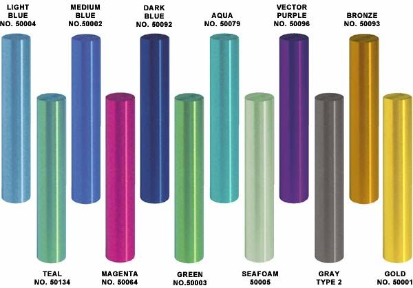

The Anno Pen gives a fine nib allowing you to write on titanium, or colour in, by using electricity instead of ink - effectively anodising the piece as you go. Colours are selected by varying the voltage.
Colours available:

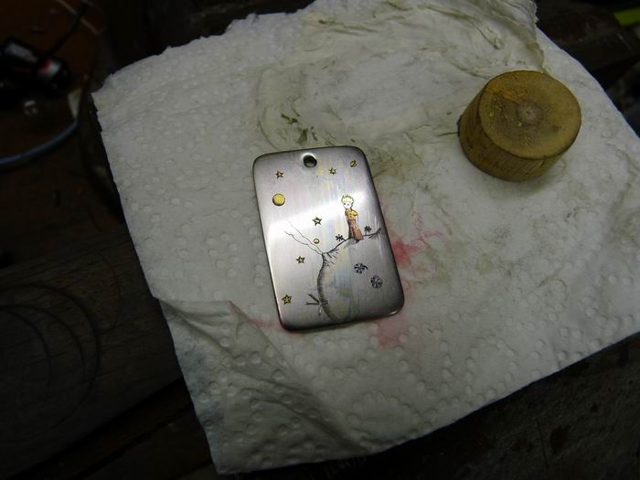

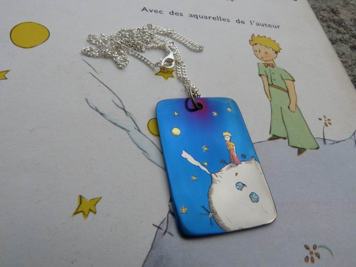

So... What can an artist do with one of these and titanium?
Check out Jeans work:

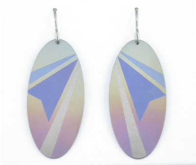

You can also tape off a part with electrical tape or cut vinyl stickers and do a high voltage color, remove the tape, then reduce the voltage and do a lower voltage color next to it without affecting the higher voltage color. Here's an example of that technique. The anodizing is a clear oxide that is also an electrical insulator. You can also polish or abrade through the surface and do a lower voltage color. It's a lot of fun to play with.
