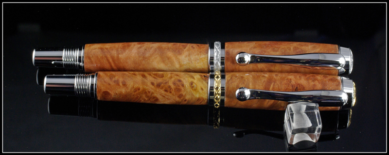

Here are a couple of Tritons from the weekend. The one in front is the standard length Triton and the one in the rear is an extended length version using a Jr. series lower tube. Both Redwood burl and Woodturners Finish.

Both are Rollerballs. The longer one uses a simple 0.25" spacer between the bottom of the end cap and spring. Someone here described the simple solution for the spacer by cutting a piece from the plastic caps that come on the tips of the rollerball refills. Worked perfectly.
Both are great! I like the satin chrome trim, may have to try one of those. Love the spacer idea, I knew I was keeping those caps for something...(tells self, I'm not a hoarder, I'm not a hoarder)

Great Pair of Tritons, Dick.
It is not that I am short, just slightly "Vertically Challenged", hence, I just love the Extended Blank, as every 1/4" is precious.
The Tritons perfectly match your well chosen Blanks, the Redwood Burl is Devine, as is your Fit and Finish.
