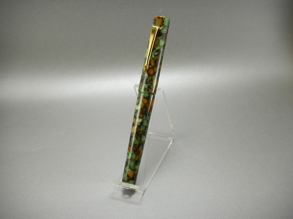

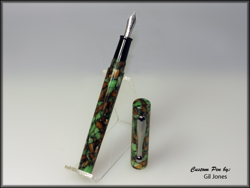

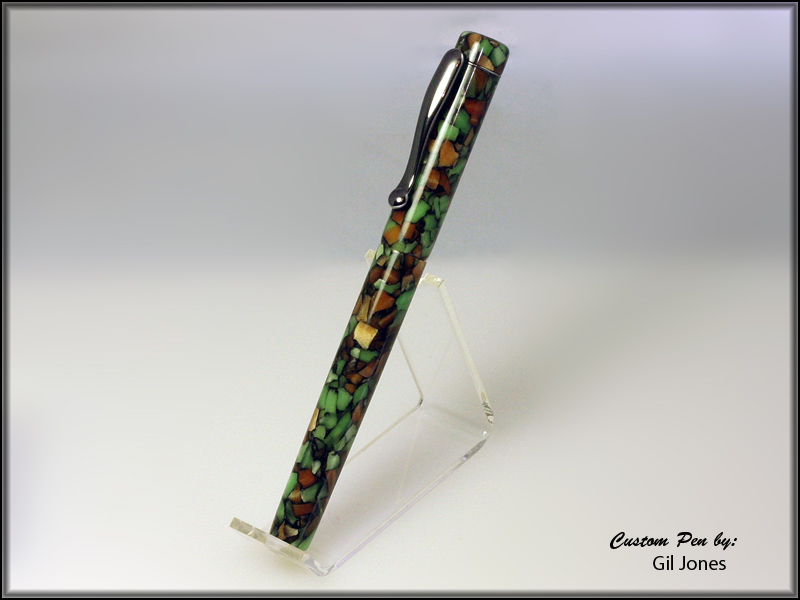

I took a break from penmaking over the summer. Just got back into it and have been working on my PITH pen. I decided to take a break from that and make something I could show. I'm really happy with the pen...not so happy with the photos....even with a photo tent and lights I still don't like the lighting I get and it takes a bit of Photoshop work to make them decent. In person I think it looks awesome but I don't feel I captured what I see.

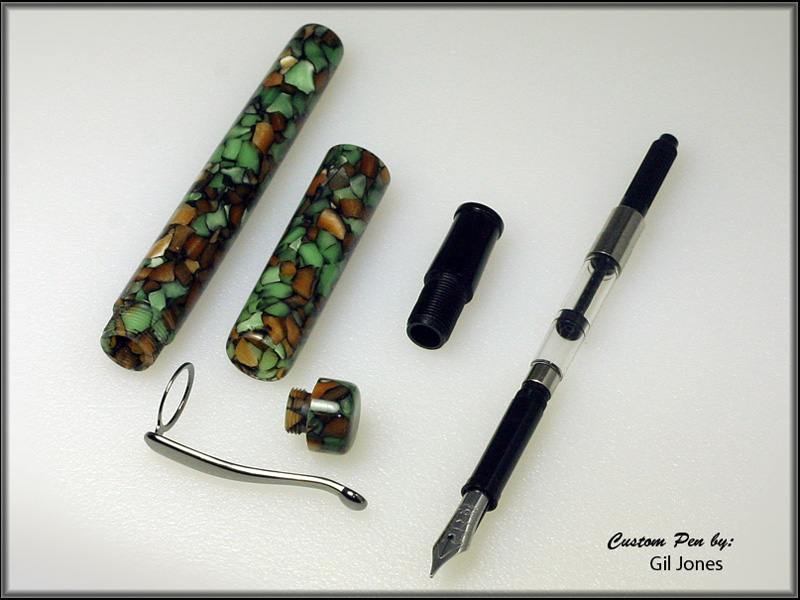

I made the pen start to finish all in one sitting yesterday...took me 5 hours which is a reduction in my time to make a kitless if you can believe that. This was my first try at using one of the larger diameter clip rings so I tried to match the diameter of the cap to the ring. The nib is a #5 Bock. Cap/body threads are 12mm x 0.8mm triple start and the other threads are 9mm x 0.75mm. Oh and the blank is called Lizard Skin...got it from Indy Pen Dance months ago...I have a box full of nice blanks waiting to be used.
Hope you enjoy!

Actually it looks more like stained glass than lizard skin it shines so well. One thing that stands out to me is the transition from the cap to the body when the cap is screwed on. Many times you see such a large step off from the cap to the body and you have kept that to a minimum. Very nicely done.

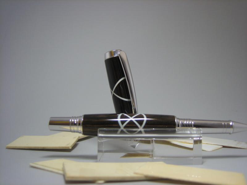

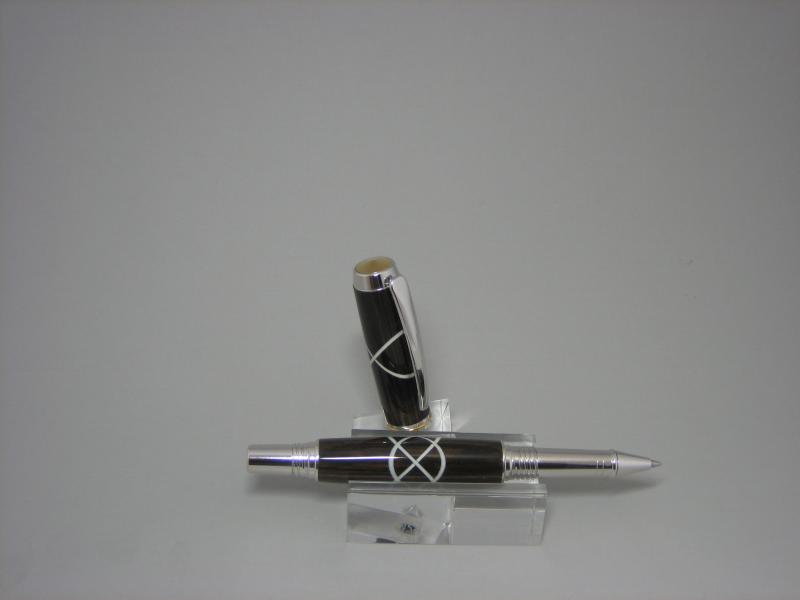

I am trying to figure out how to post a photo. If this works, the wood is macassar ebony and the inlays are genuine ivory from reclaimed piano keys.

The pen is awesome!! And thanks for including the size taps and such.

Thanks Mike...funny you mention the cap transition. That is the spot my wife complained about because I put a slight curve on the cap tapering to the body but the edge on the body is a sharp 90. You gotta look really close to see it. So every since her comment I'm tempted to go knock down the edge on the body but I wanted to photograph it before risking messing it up.
