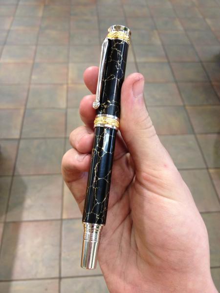

I turned a few of these, and they turned out beautiful. They have a much more "jewel encrusted" look that even the statesman. They have a finial accent at both ends, and an accent band at the top and bottom of the cap. The clip also has a swovarzki (however you spell it) crystal embedded in it. This pen looks great with casting and tru stone, nice burl wood looks pretty good too.
Attached photo is a 22k gold jr. majestic rollerball in black and gold matrix tru stone.
