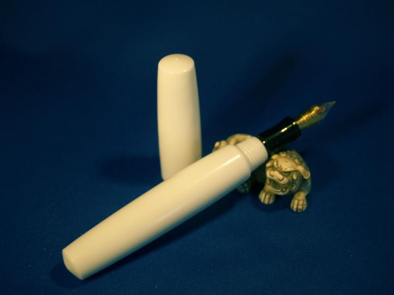

Practice and inventiveness. I'm making more and more, with fewer and fewer problems. The problems come specifically by having limited tools with which to work. I have a wood lathe, but not a metal lathe, so I have to cut threads with taps and dies by hand. Getting blanks into the die at a perfect 90 degree angle is challenging, although using taps in a Jacobs chuck on the lathe makes threading interior surfaces a little more accurate. A number of people on this forum have talked about using shims on mandrels to fix the blank solidly for turning, but I haven't tried that method yet. I learned the hard way that creating mandrels out of harder woods has its limitations in that it is difficult to get them centered perfectly in a chuck so that some of my blanks are fatter on one side than another.
Another issue I've dealt with (again, having no metal lathe or CNC mill) is discovering suitable materials that will take a thread cut by hand, but will remain sturdy enough to hold up under some pressure when turned relatively thin while exterior threads are being cut. I've found that TruStone is strong enough, as is Corian, but poly resin shatters too easily, at least in my unskilled hands. Wood is pretty much out of the question as even the harder woods won't tolerate the constant on and off wear of threads as the cap is screwed onto a barrel.
Finding nibs, feeders, and sections with known (and reproducible) thread patterns is a challenge. Lots of manufacturers will sell you units but can't tell you what size threads need to be cut in the barrel to accept them. The exception I've discovered (thanks to the consistent generosity and patience of craftsmen on another forum) are nib sections from Berea (the thread is 10x1).
I have to admit that I still go back to kits for a sense of immediate gratification, but I spend more and more time learning how to make kitless pens.
I'll attach a (really bad) photo of my first near-success. It was not made for sale but for practice. It's kind of ungainly, but I was pleased that (1.) it actually resembles a pen, (2.) it's not absolutely horrible, and (3.) it works. I don't hold it up as an example of anything other than proof that with persistence, lots of fumbles, and advice and counsel from those here and elsewhere, progress can be made.
Doug
