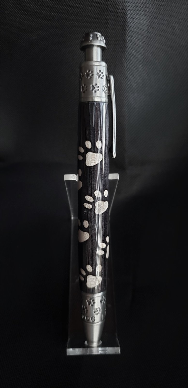

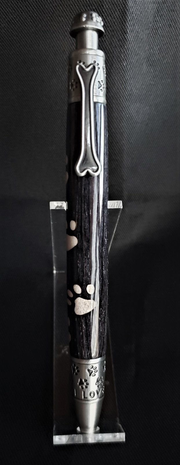

I'm still a relatively new pen turner – about 85 pens or so now – and I recently tried my hand at turning the I Love my Dog Pen Kit, of the three only one turned out. The other two the plastic click mechanism broke. It could just be me and my lack of skills and experience. What have your experiences been? Any tips? Thanks. George

I have made two without a problem (believe me, no specials skills). Go back to the instructions. The plunger sticks up when the point is recessed. It even sticks up a bit when it is extended. Is it possible that you are missing the spring? Take a picture of what broke...maybe if we see the look of the break, we can determine what went wrong. I am holding one in my hand now (my wife uses it everyday). The metal plunger (with the dog paw in it) screws Dog Pen A.jpgDog Pen B.jpgDog Pen Pewter Bone Click.jpgDog Pen Pewter Click.jpg on to the plastic thread.
I just experimented with mine. If the plunger is turned/tightened to the max the refill will not advance.... Back the plunger off a revolution or 2 until it works properly.
"The other two the plastic click mechanism broke". Did you over tighen or force anything?
I just experimented with mine. If the plunger is turned/tightened to the max the refill will not advance.... Back the plunger off a revolution or 2 until the works properly.
