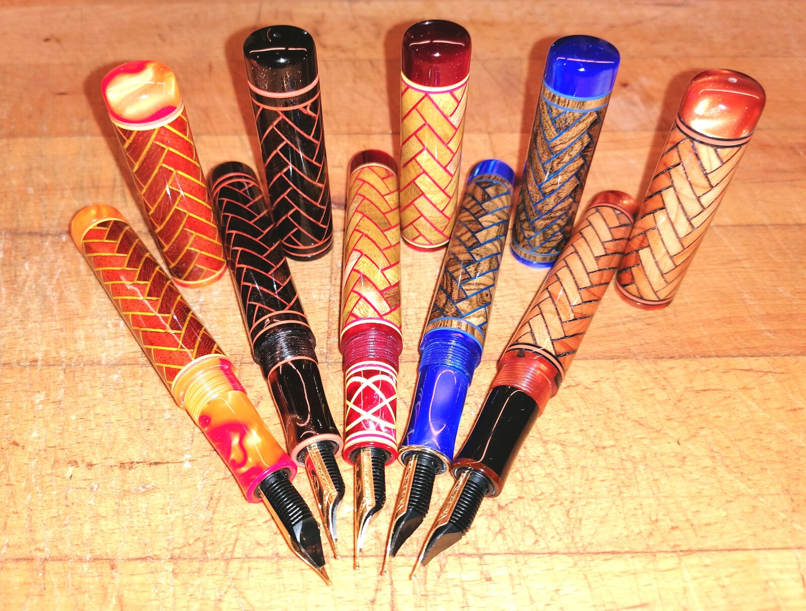

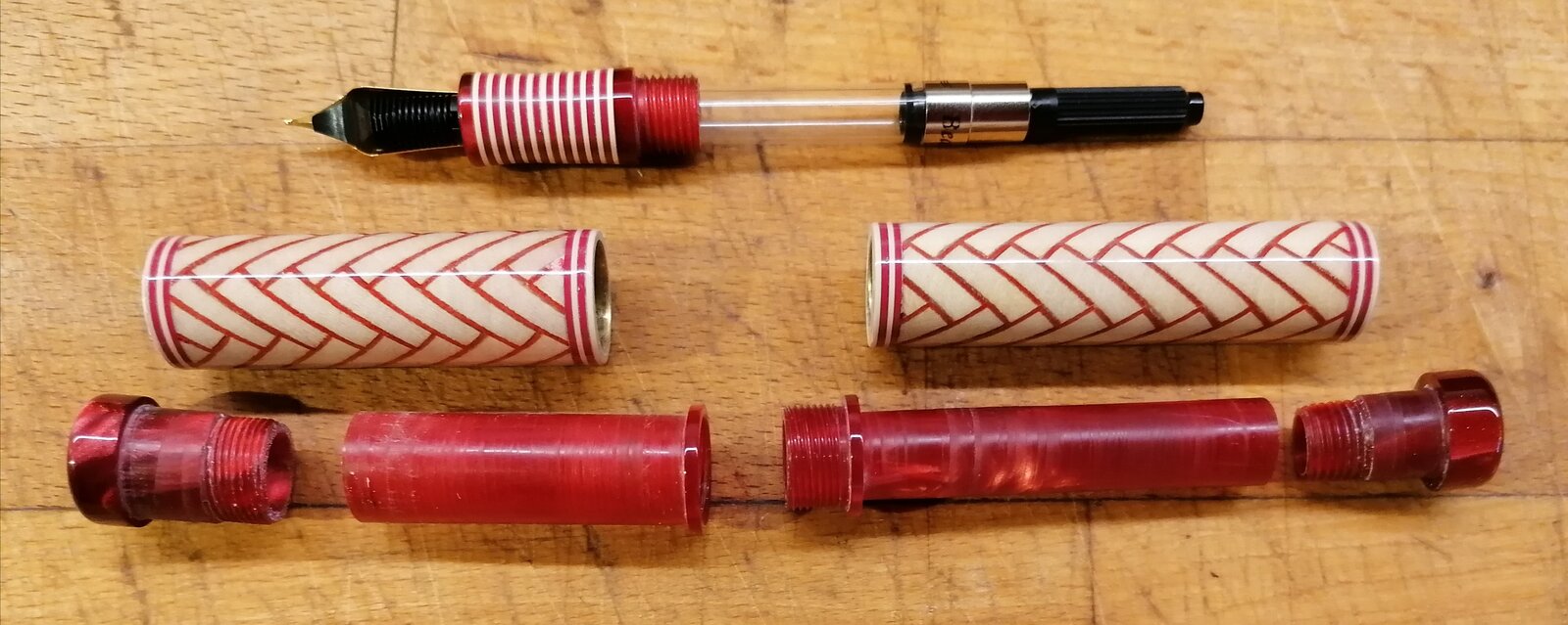

Started these a few months back as a challenge to to try new things. I've learnt a lot, mainly don't bite off more than you can chew 😂😂
. All pens are fully lined but the herringbones have brass tubes

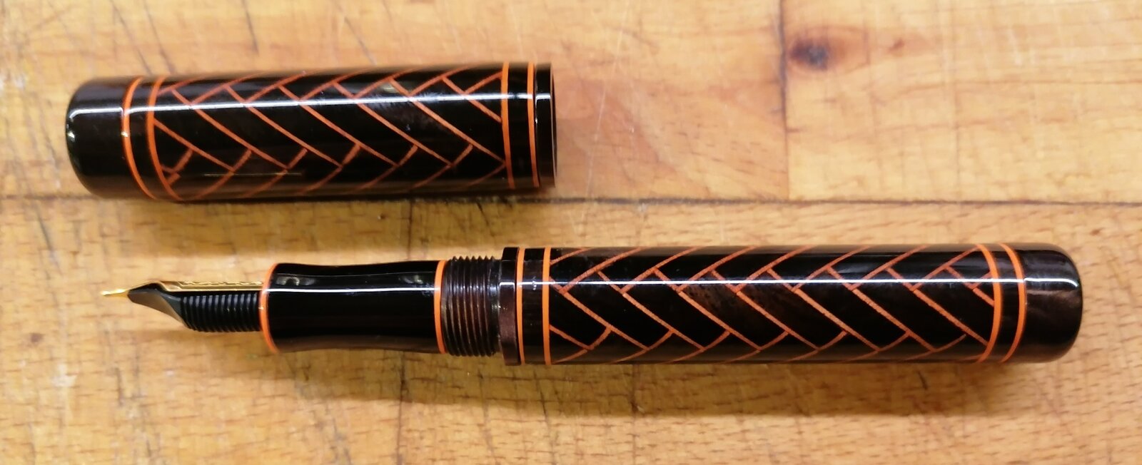

"Cracked earth chocolate orange" African black wood, orange tulip veneer and orange pvc accents on Mocha kirinite

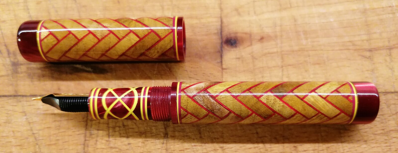

"Everything but the kitchen sink" Mulberry with red tulip veneer and red and yellow pvc accents on Reoja mother of pearl kirinite

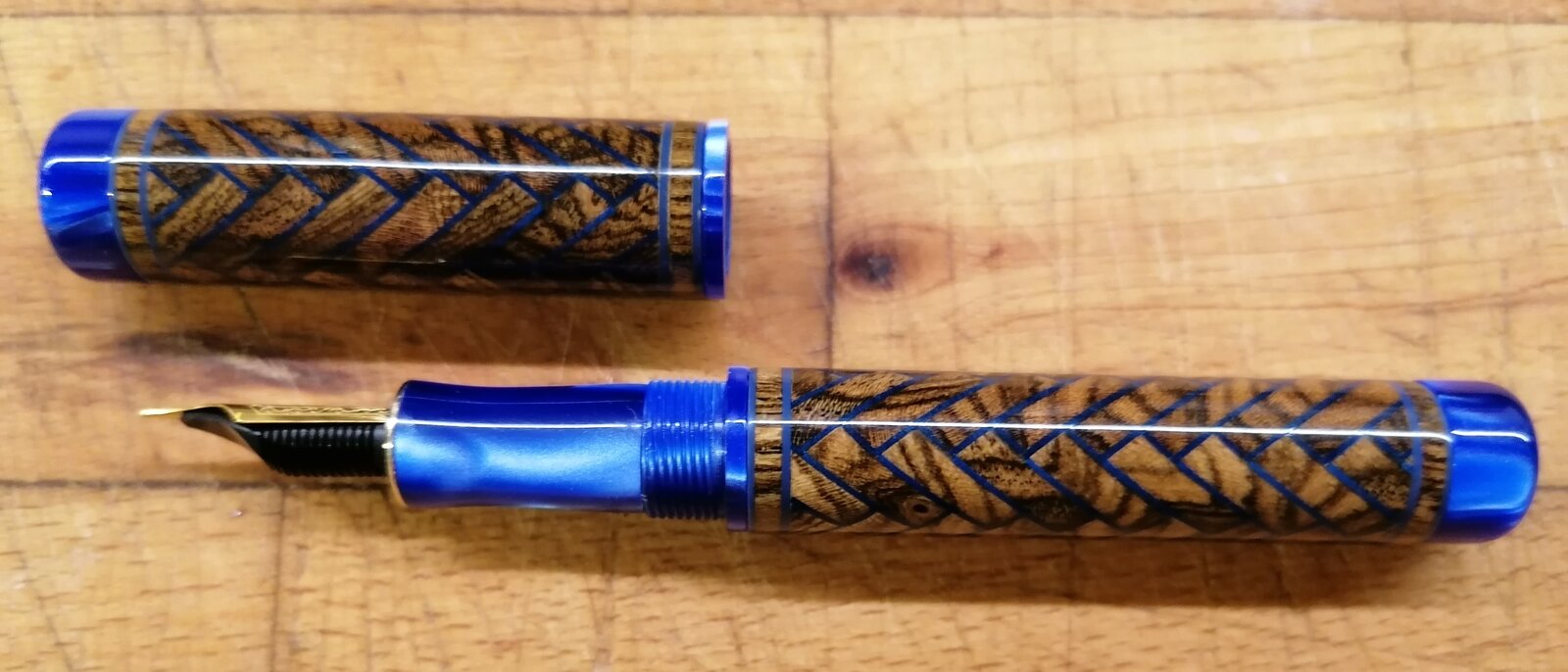

"Blue cola n cocabola"
Cocabola with blue tulip veneer and blue pvc accents on blue mother of pearl kirinite with a brass band on the section.

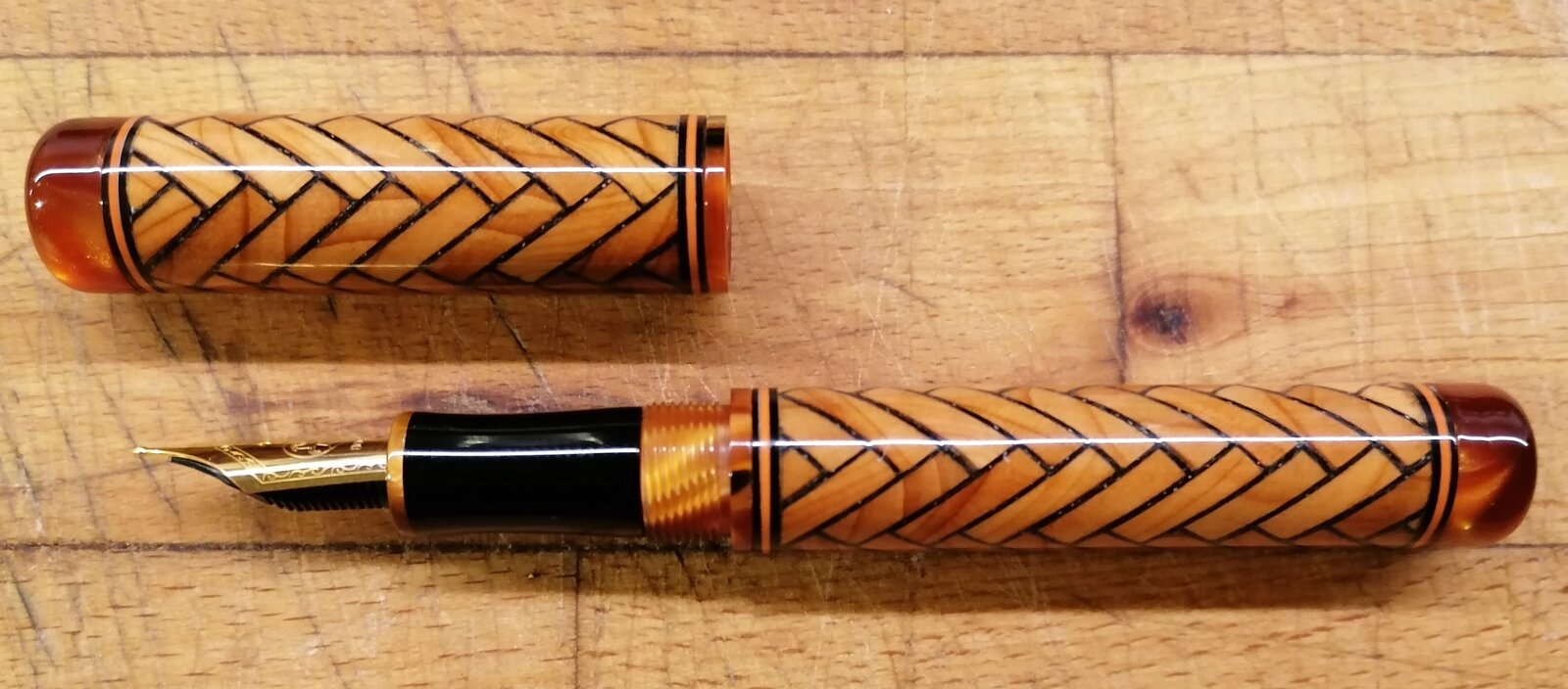

"Amber gambler"
Yew with black oak veneer and orange and black pvc accents on Root beer kirinite

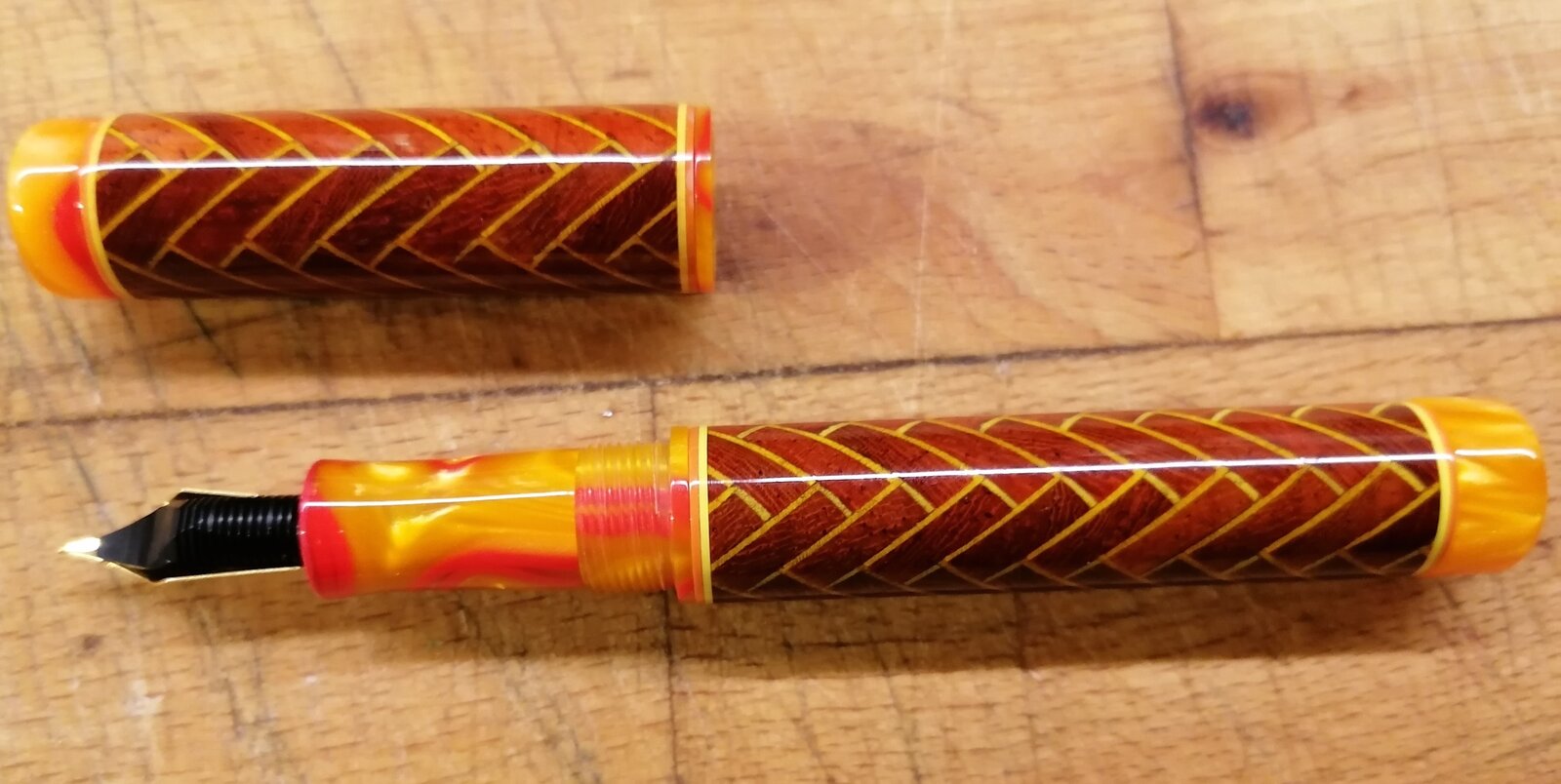

"Sun blocked"
Paduk with yellow tulip veneer and orange and yellow pvc accents on sunspot kirinite
WOW!! That is an impressive collection. Herringbones have a very distinct learning curve, and only with repeated efforts can be consistently mastered - you have done superbly. Your precision and tight joints are excellent, and I appreciate the design effort for the end caps, trim rings and sections - NICE Knot!!

I noticed an interesting photography effect. In your photos, there is a white line, (not in the least bit distracting to me). But it is cool that in every photo, the white line aligns with your segmenting! It displays your precision of the herringbone. Again, well done. 👏 👏 👏

Wow. Great work. I like them all, and am extremely impressed with the Mulberry with Red Tulip pen. The knot design in the section is definitey over the top!

Hi Mark, I took these pictures in my kitchen. It's the lights from the cabinets above the worktop. An unexpected effect
That's very impressive! The Celtic knot in the looks great; a little busy, but very well done.

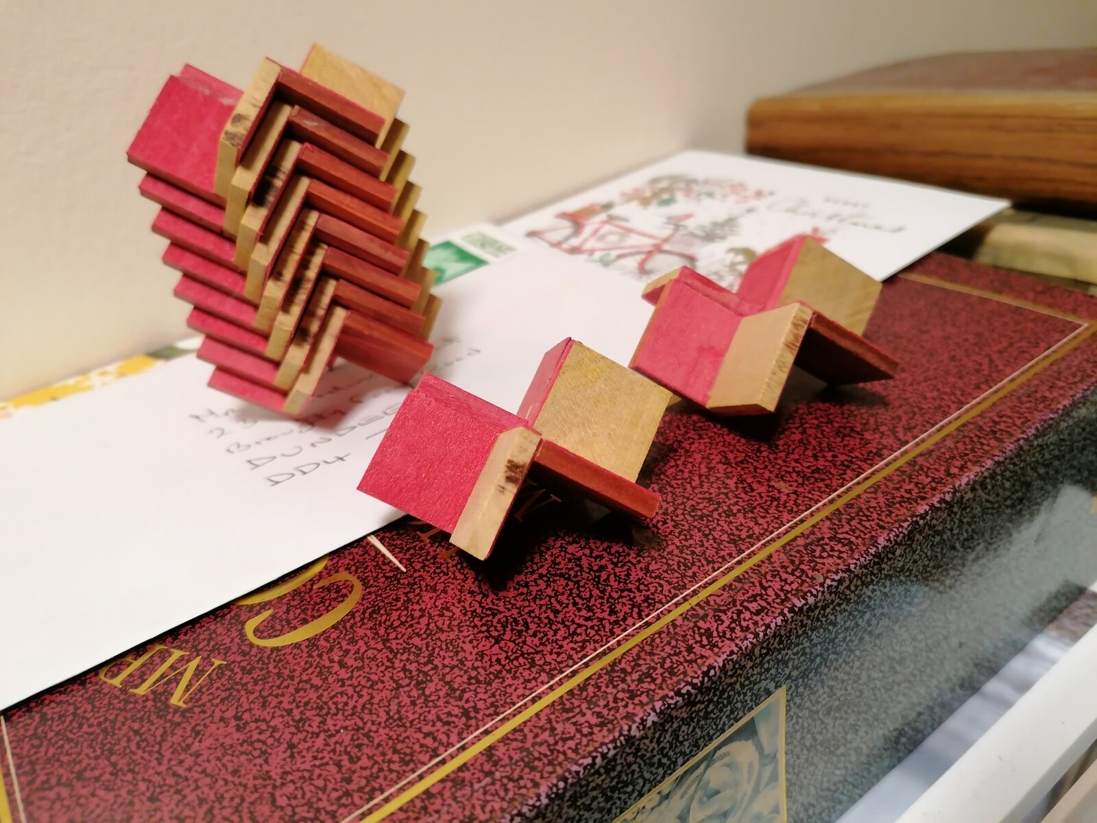

Did you put the herringbone on a tube and then line the tube?
Hi, sorry my description was not very accurate. The internal structure in the pen is all keronite. This is one of my prototypes and maybe explains it better.

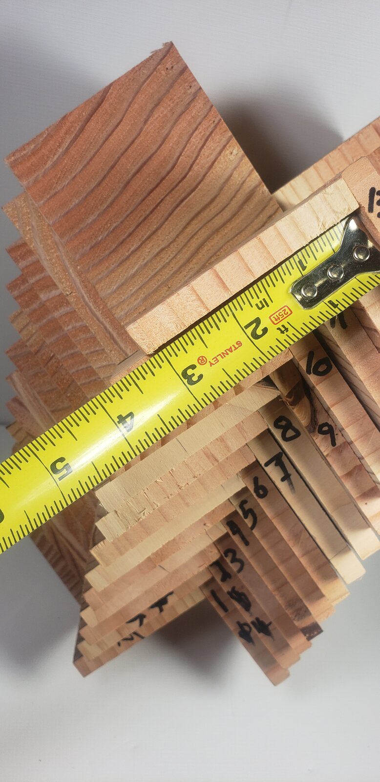

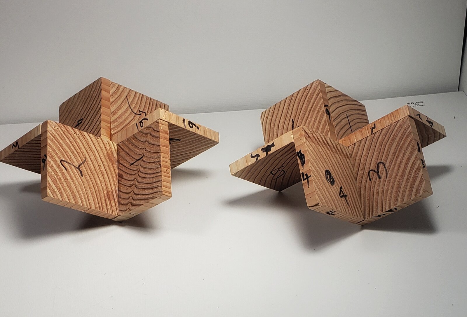

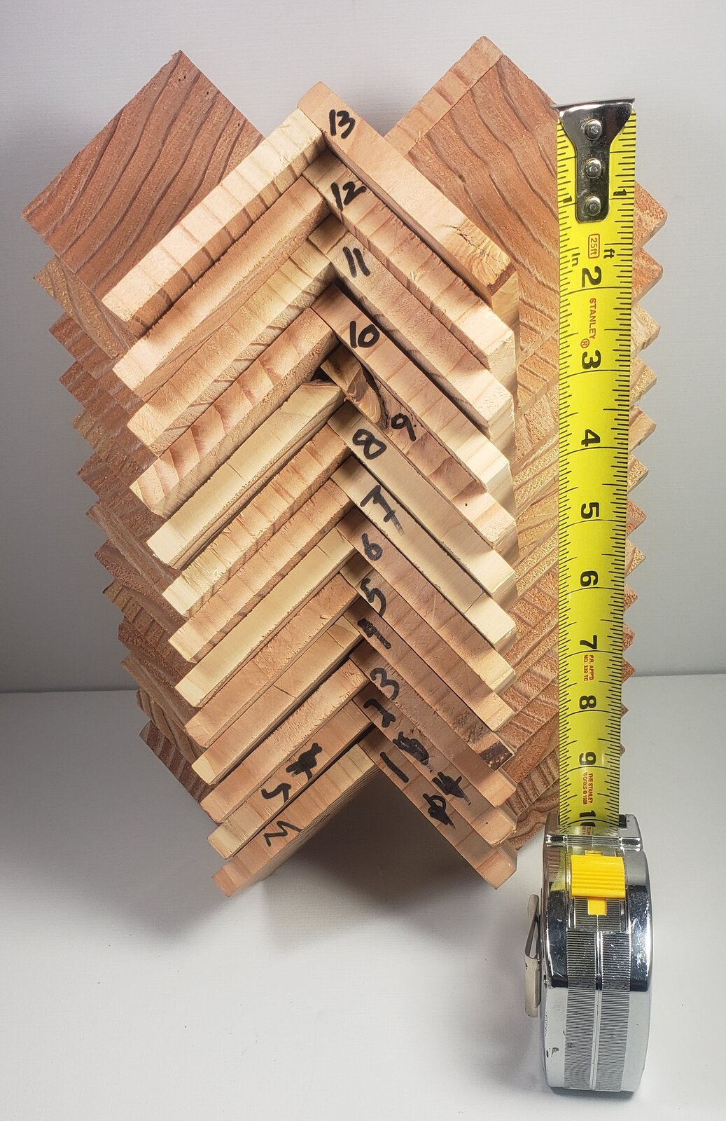

Really very nice. Excellently exquisite actually. Having done several of these, not as nice as yours BTW, I know how much work goes into the 360 herringbone which is what these appear to be. Did you make the 6-tile layers then stack them or do you have a different way to build the blank? Thanks for sharing.
Do a good turn daily!
Don
Don
Thanks, I do them in 6 tile layers. Building another right now
