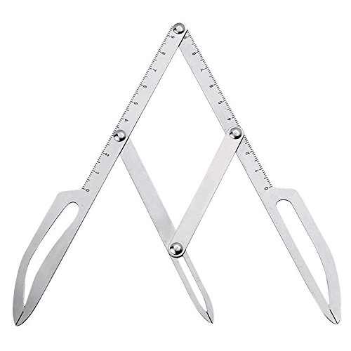

I was looking around on Amazon.com and came across a divider which marks out the golden mean for any length.
I am waiting on it to be delivered and once it gets here I will add more information.
From what I have seen, you set the two outer ends to the length of the pen you want to make, and the inner pointer will show you the dividing line between the top and the bottom.
Time will tell if I made a good purchase or just wasted some more money.
Here is a link to the set that I ordered: https://www.amazon.com/CALIPERS-Eyebrow-Microblading-Permanent-Stainless/dp/B0732V4MK5/ref=sr_1_3_sspa?s=hi&ie=UTF8&qid=1523293434&sr=1-3-spons&keywords=golden+mean+calipers&psc=1
Here is what they look like:

Thanks, Elwin. . Could be useful ... I like gadgets like that. . I checked the Amazon ad:
  • Measures the Golden Mean, also known as The Golden Ratio and Phi
  • Used extensively in Microblading and other Beauty practices
  • Stainless Steel, Fully reusable and able to sterilize
  • Microblading eyebrow divider
  • Eyebrow Permanent Makeup Supplies

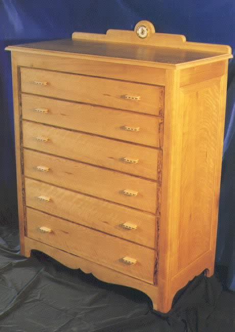

I used the golden ratio for determining a set of drawer heights. If I remember correctly, I started with the height of the bottom drawer. The next drawer up, it's height is based on the drawer below. No calculations, just a radius. The procedure iterates for each drawer. Figured cherry with bocote trim. inlaid pulls and top. This chest of drawers was in Fine Woodworking periodical, around 20 years ago.

I recently made a Baron pen for someone and when I placed the two ends of the divider on the ends of the pen, the center pointer was almost exactly where the cap met the body when the two were put together.
So as far as it goes for me, I think that it will help me in making kitless pens, especially if I decide to make one a little longer or shorter than the norm as seen by the kits that are available.

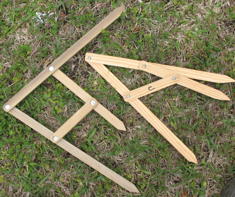

I'd love to see a photo of your homemade Fibonacci Gauge - share if you have time? (And I think you made a case against yourself in your post. The golden mean really is simply a "ratio or proportion," and it's a pretty easy one to use...and is probably less "fussy" than Fibonacci sequence!) :)
Cannot find original PDF file turners have been using for years.
http://www.goldennumber.net/wp-content/uploads/2012/05/golden-section-gauge.gif
Here are couple lamps used my fibonacci gauge to mark off lines few year ago. Beauty of fibonacci gauge just lets you mark off layout lines on the lathe before turning something.
Just got into hollowing marked off where would make separations on the log in order to do my hollowing. No a fibonacci gauge will not make everything you turn a masterpiece! Same goes for golden mean!

So what say you now Gregory Hardy, my simple homemade fibonacci gauge allows me to mark out different design elelments on my lathe with a pencil on a woodturning without any math. While don't always use my fibonacci gauge and do resort to ruler and pencil marks for laying out different design elements on small turnings. Guess could make or buy a smaller fibonacci gauge for smaller turnings and save some time maybe later.
