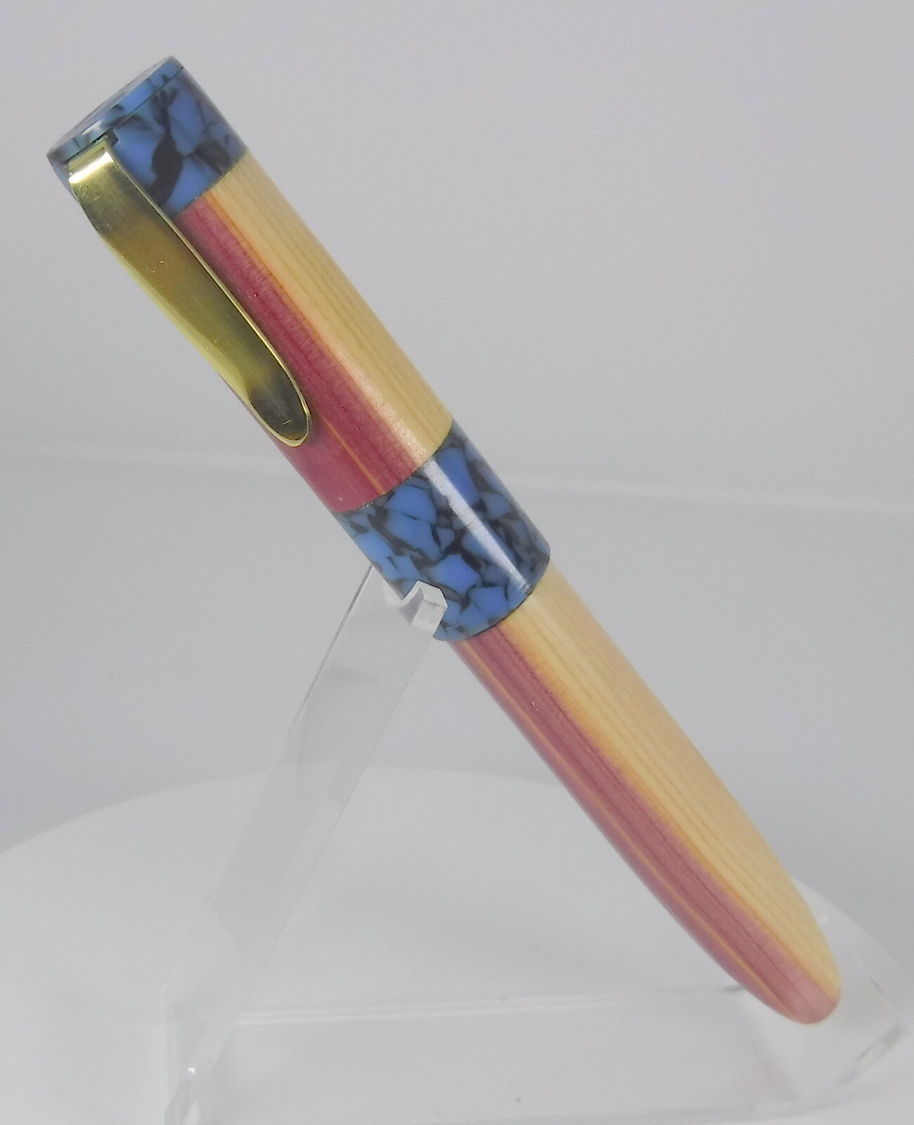

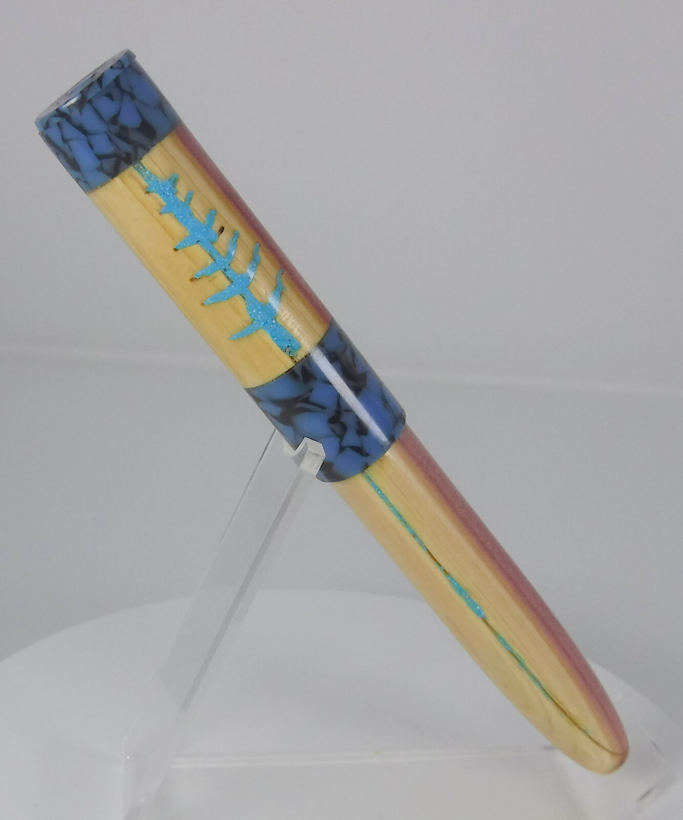

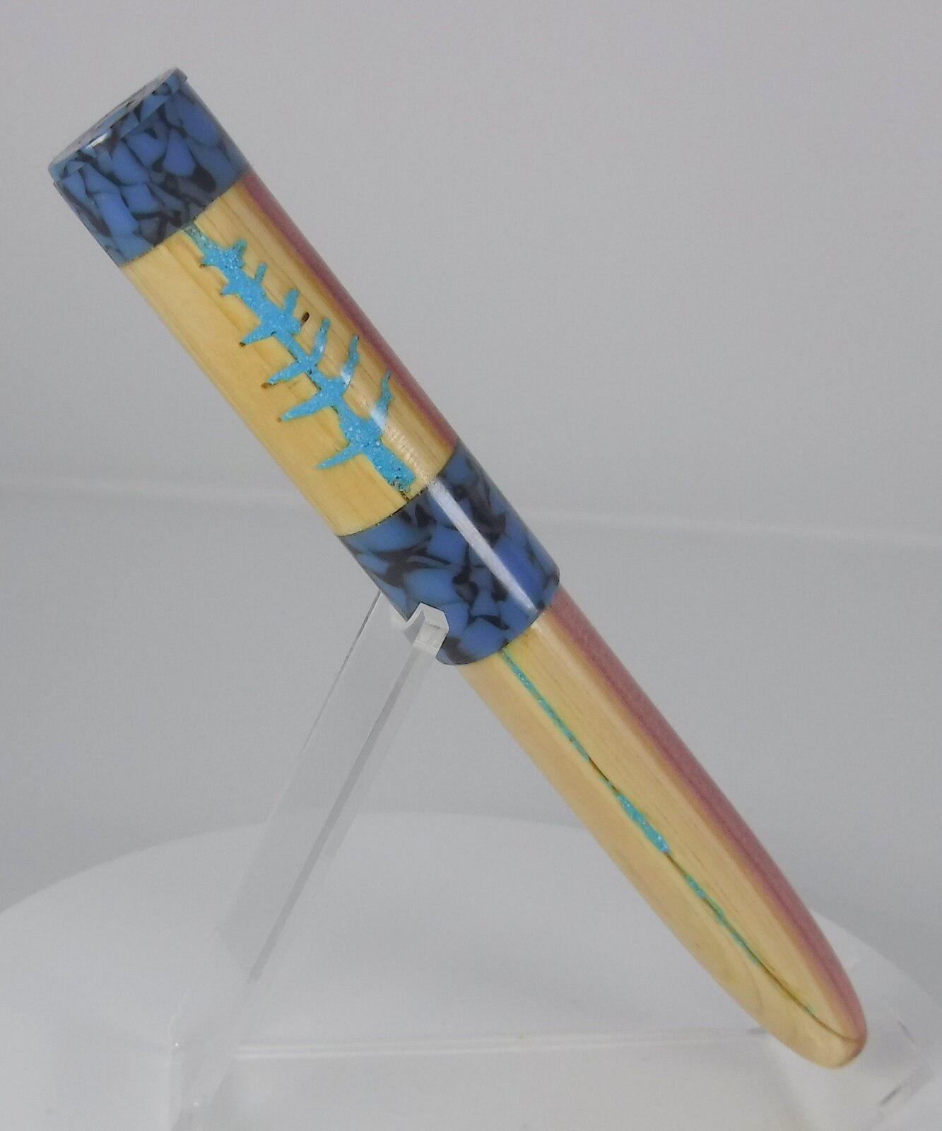

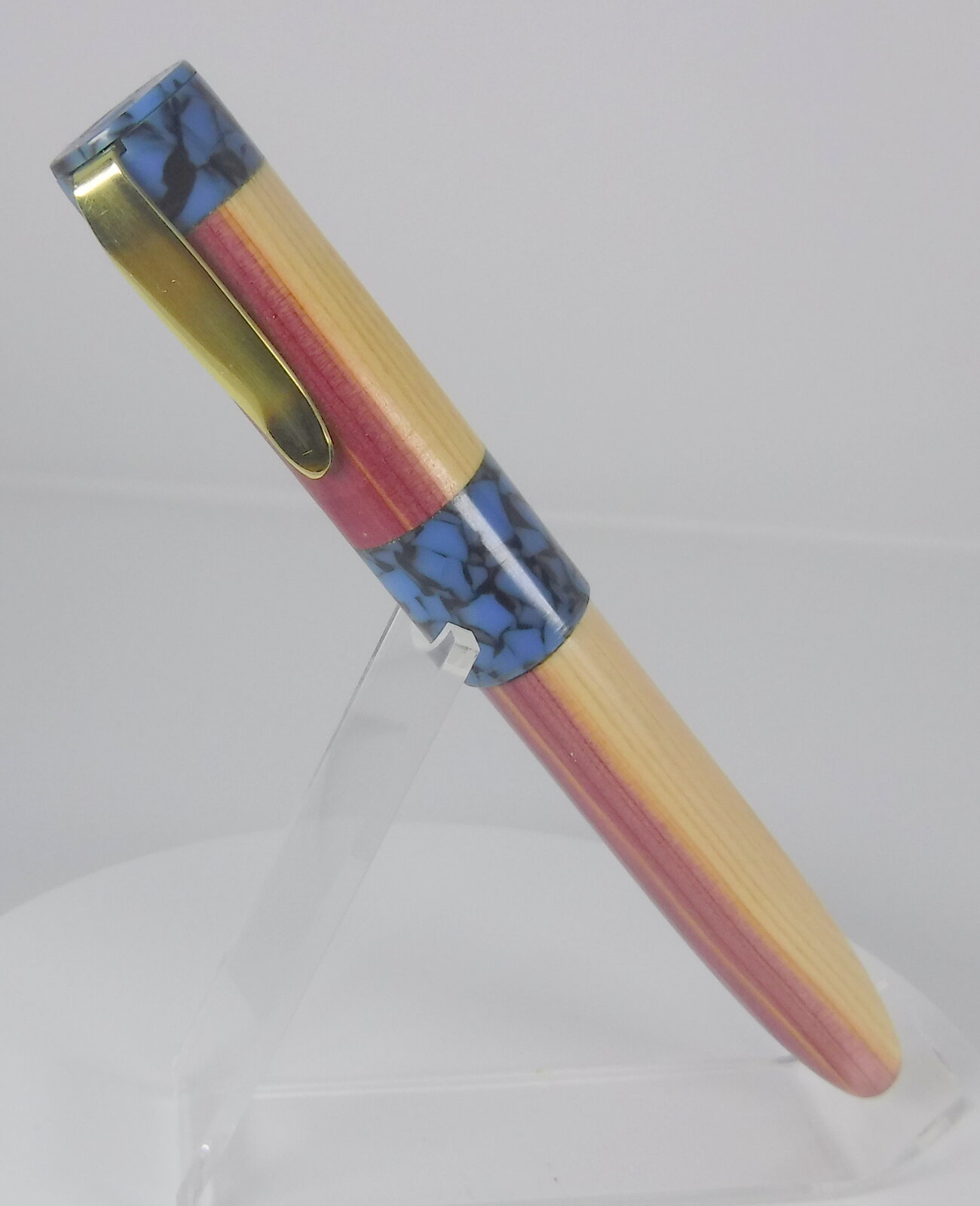

I am currently waiting for a customer to return a commisioned rollerball kitless pen to me. Apparently I made the end of the barrel too thin and the spring popped through the end of the barrel. I am luck to have just enough of the blank (of sentimental value to the customer) to make a new barrel. Stupid error on my part. The pen is to commemorate an Eagle Scout project. THe scout cut down a cedar and built a flagpole for his school. Dad sent me a piece of Cedar and told me it was dry, it wasn't! The cedar was cut into ¾ inch pieces and then oven dried to be sure. It lost about 20% of its weight and warped. In order to make an appropriate pen plank two of the pieces were glued together. The warping resulted in a crack on one side of the blank. On the barrel the crack was filled with turquoise powder. The the crack in the cap was engraved with an image of a cedar tree and this too was filled with turquoise powder. DSCF0939.JPGDSCF0938.JPG
