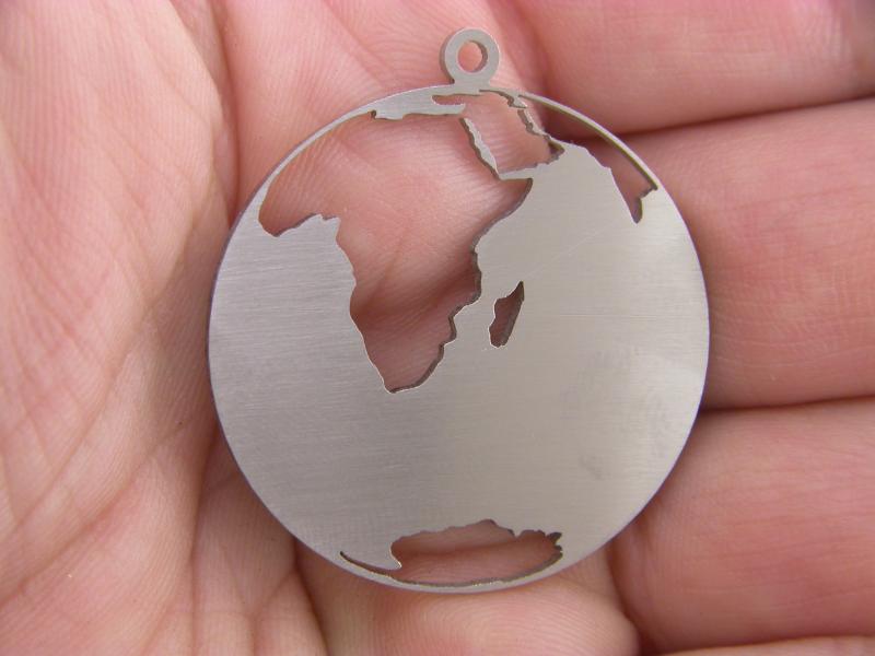

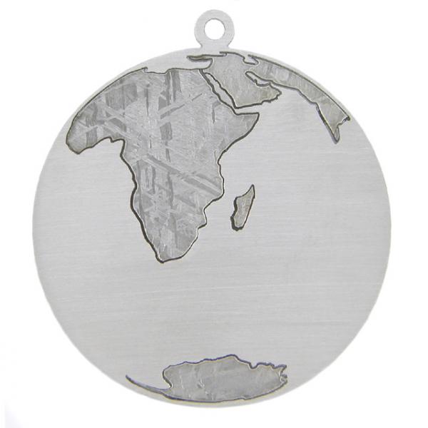

Here's a pendant I made in stainless steel and inlaid with Gibeon Meteorite. The view is what the Apollo 17 astronauts saw as they returned to Earth. The Gibeon meteorite landed in the southwest corner of Africa, about 1/6 of the way up. I used my fiber laser to cut and welding laser to weld the parts in.

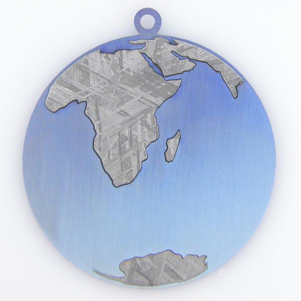

Yup. The color of stainless is pretty boring. It would be possible to do the oceans in blue anodized titanium for some contrast. That might pop more. It would also be possible to do the land in bronze anodized titanium instead of meteorite, but the "hook" here is the finely carved meteorite. Nobody else does process it like that, and I think that would be the thing to sell it. I would agree that it needs more contrast. This was as much an exercise in dialing in the laser to see if such designs were possible with the different metals. I was pleasantly pleased with the cut, low dross, and fine kerf. Now that I know that it works well, I can try more things.
