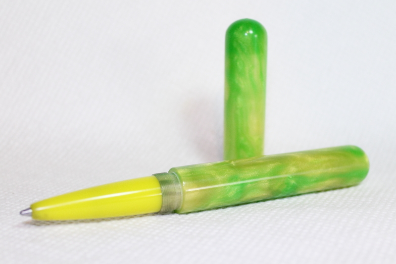

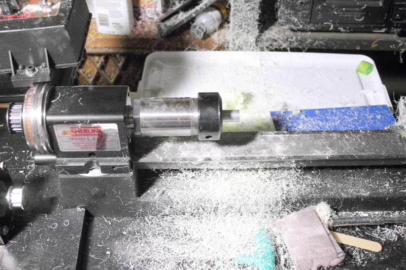

I purchased and put together a Sherline CNC ready metal lathe early in this year. It was a fun project and a learning experience. This first photo is a picture of my first kitless rollerball that was made using the new lathe. All of the threading (both internal and external threads) were cut on the lathe without the use of taps or dies. The Nib is connected to the body using basically a 48 TPI single start thread. The cap to body is also 48 TPI but with 6 starts. The cap will complete twist and seat in less than 2 revolutions. I spent probably at least a week studying threads to determine how to best cut them on the lathe. It's probably not the best pen I've made, but it's the first step in a new adventure. I stayed with a pretty basic profile but have all kinds of idea for future embellishments.

Hi Ken, Glad to hear from you. It looks like you are having fun, and thats great. Nice start on the Kitless Journey.

Looks good Ken, great start! And I'm sure your "future embelishments" will be as unique as your segmented blanks!

Thanks, Chuck. This type of work can be quite challenging when it comes to hollowing out the cavities of the body for the ink container. I'm a slow starter and tend to over engineer most things. It's a very rewarding experience when you get the sizing correct and the pieces all go together well. My head is spinning with the possibilities.

If that is the first, I look forward to seeing what you will come up with next!

Thanks, Jason. I took the Kitless Fountain Pen class in Belphre last September and with the help and guidance of Mr. Steele made one. I knew at that time rollerballs are more to my liking than fountain pens and that would be my first pursuit once on my own.

Since you've taken a class, and are cutting your own threads, I won't offer any recommendations. You are on your way, and I can't wait for more of your ideas to be shown.

Terrific Kitless Pen Ken,
Excellent Fine Threading and Machining.

Btw, 48tpi (M .5 if I am correct), isn't a bit small and fragile?
