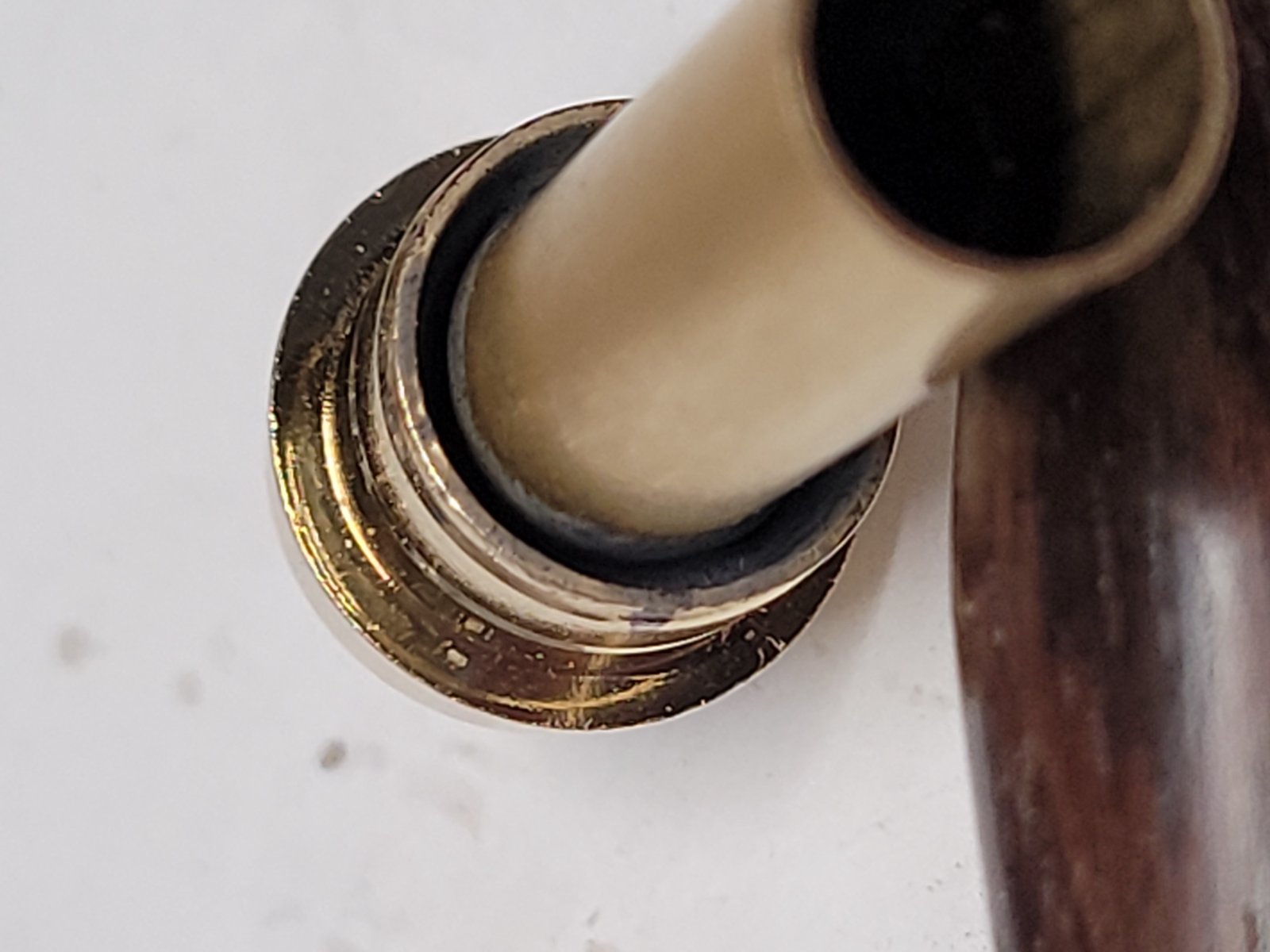

I meant to post this a while back, and have not been here very consistently lately, just the occasional check in. Anyway, This is the other Wingman kit that I had damaged and repaired. This one is going into my personal carry collection for a couple reasons, namely a crack and some separated CA finish when I pressed the top/finial in. Having made the repair to the hardware, I don't even want to temp fate by trying to disassemble it. Other than that, it's a really nice looking pen (IMO). It's hard to not love DIW!

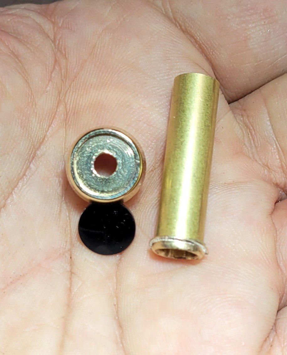

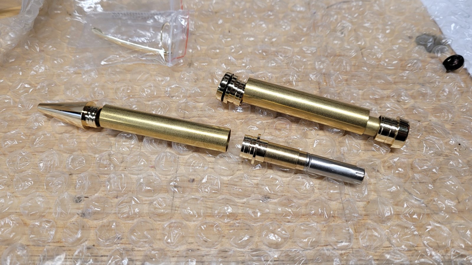

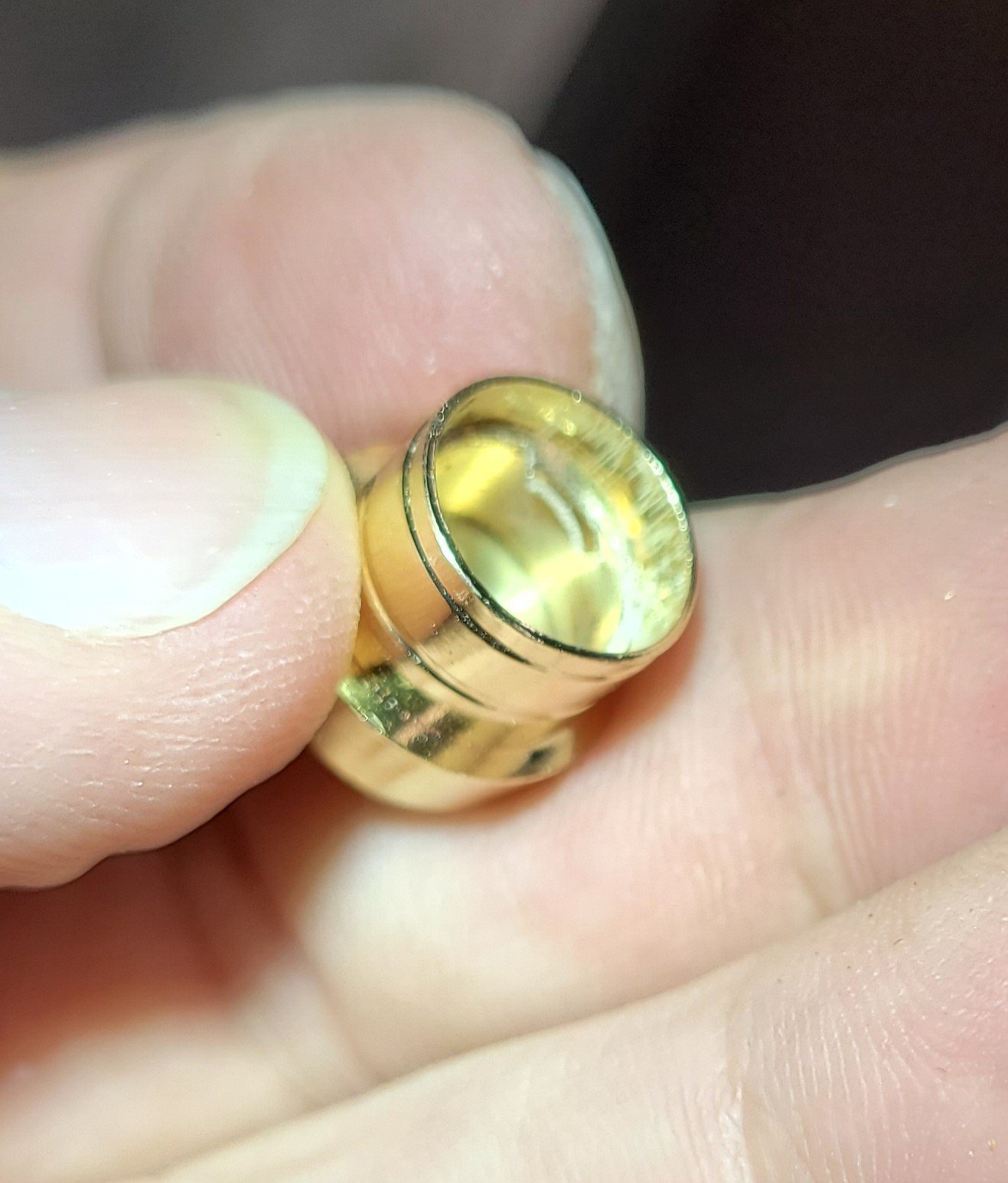

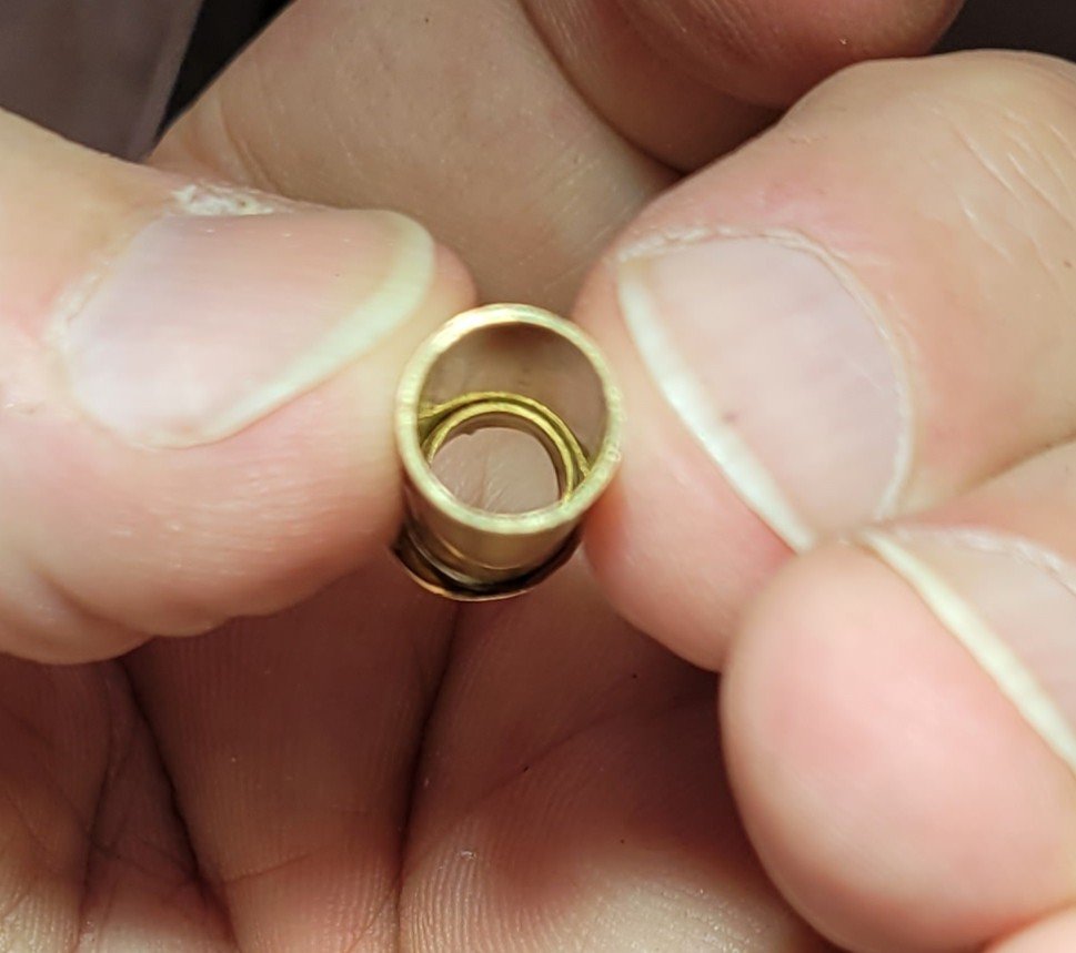

It looked like the finial would be easy enough to replace on this kit. I started to drive the kit finial out with a transfer punch sized to fit the tube without realizing that there is another concentric tube inside the assembly that grips the twist mechanism. I proceeded to pretty much destroy that, but was able to clean it up with a Dremel and "glue" it together with some JB Weld. Here's the story in pictures. So, if you are going to knock out the finial out of a Wingman kit (I got this from Turner's Warehouse), make sure you use a punch that fits inside the inner tube of the finial assembly!

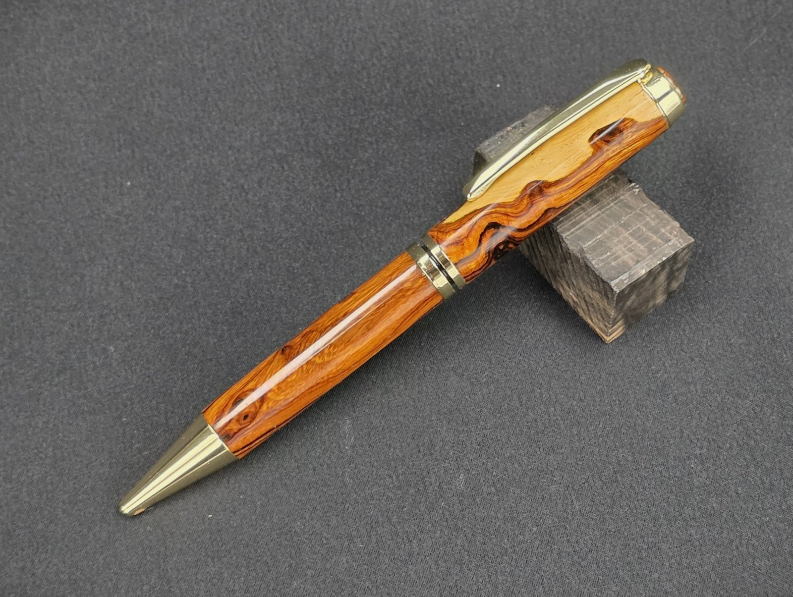

What it looks like normally.

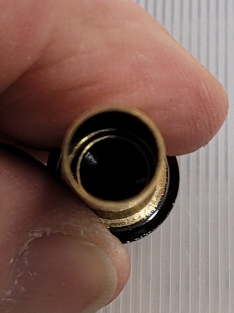

What it looked like when I was done beating it with a transfer punch and hammer. ☹️

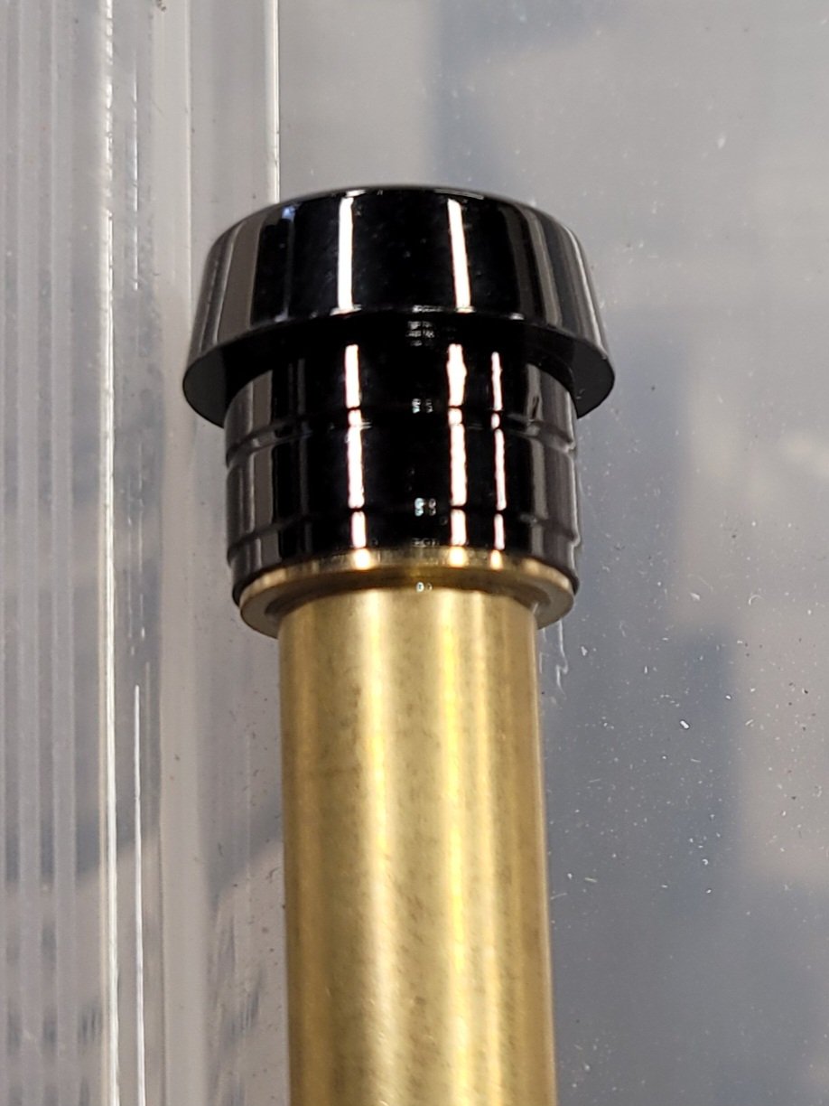

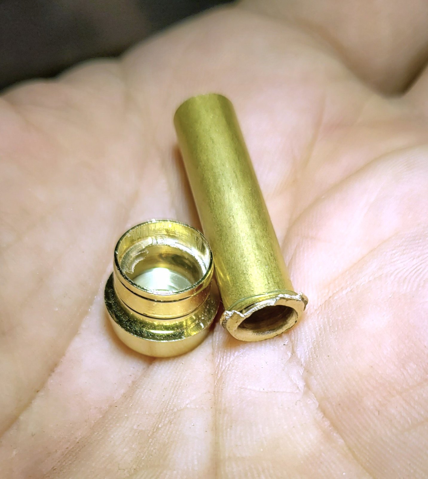

Fixed and showing how it fits together.

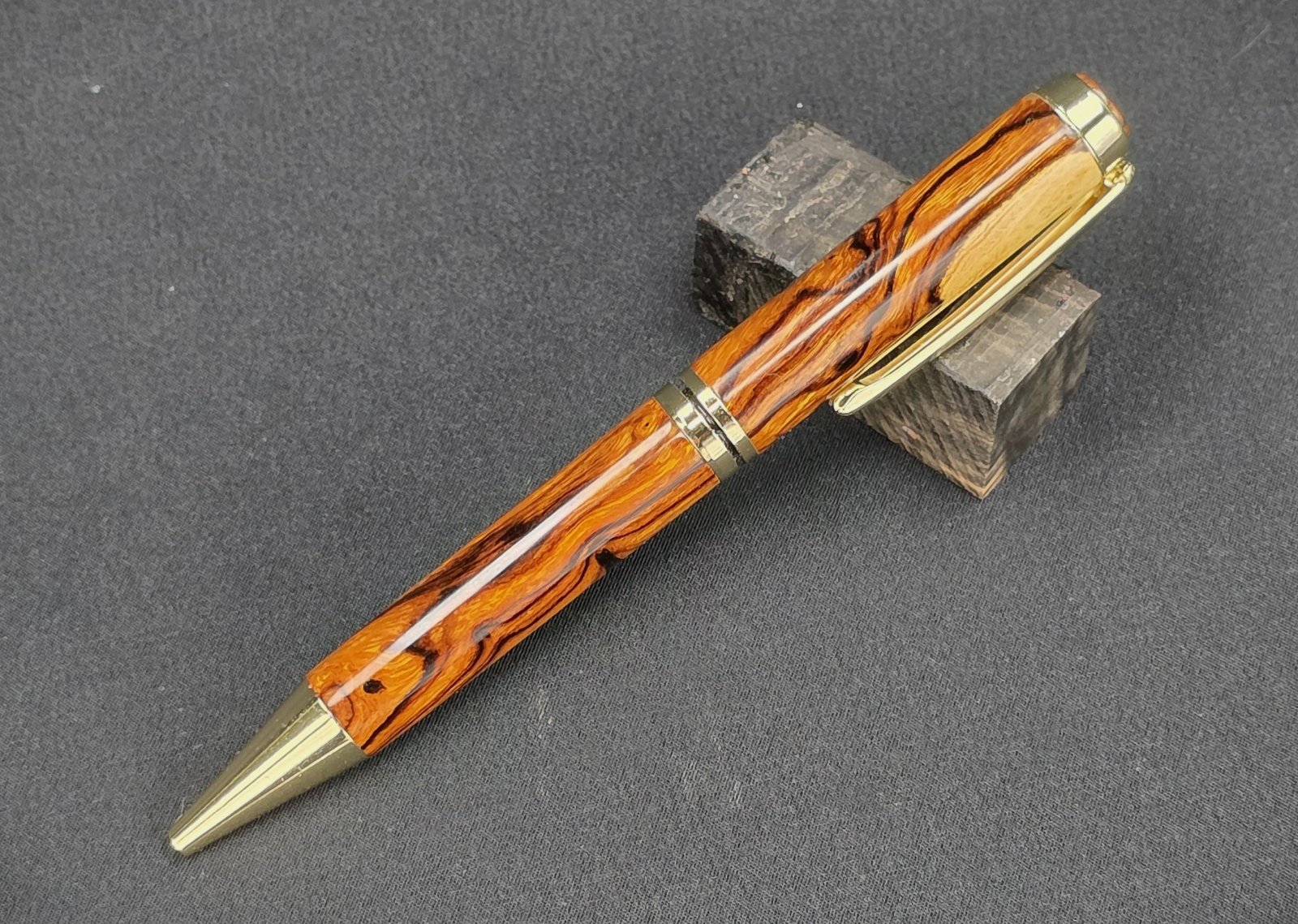

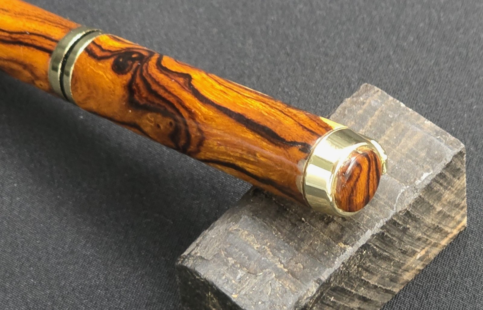

The finished product (don't mind the goo on the nib, it came right off, but I'm not taking more pictures 🫤)

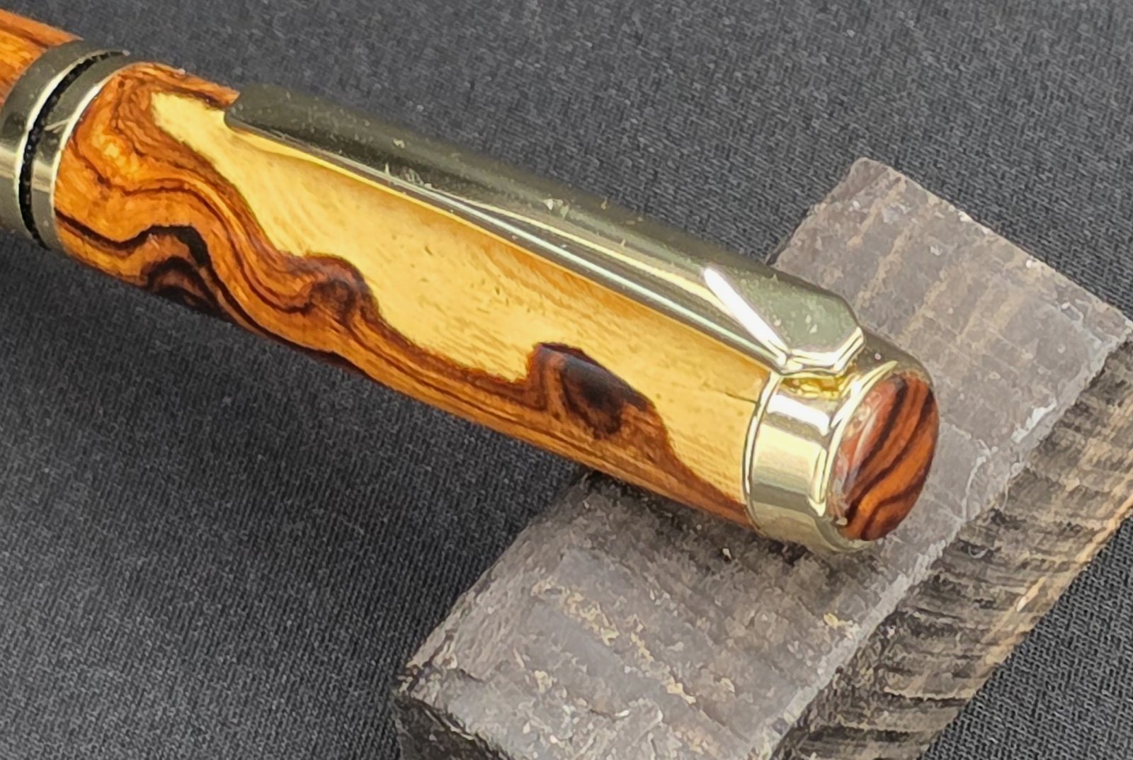

The crack and finish issues, (To be fair, I did drop the upper barrel on my concrete shop floor before I assembled it. Dang it!)
