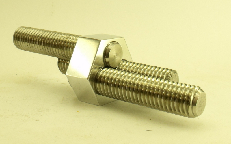

I recently posted a threaded pen and one pic had a little prop as a stand.
Well........some of my miserable mates preferred the prop over the pen !!! Humph !!:mad:

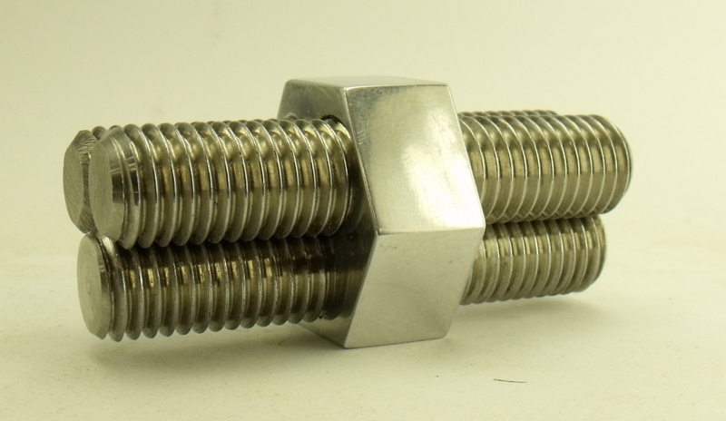

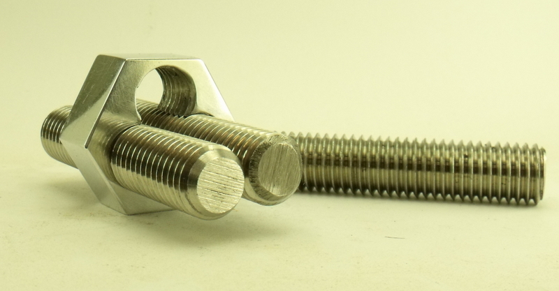

:biggrin: It is just a little novelty puzzle piece I made a few years ago. It has three 10mm stainless steel studs in a special nut. The nut was hand made from aluminium and the only trick was getting the distance between the drill holes ( to be tapped ) the correct distance apart.
The 'method' or better yet, the 'sequence' of tapping is actually the trick that lets it work.
Each stud can screw into the nut independently and the threads from each stud overlap.
I will tell the sequence later, so please have a guess if you want. It is a lot simpler than you may think....:wink:

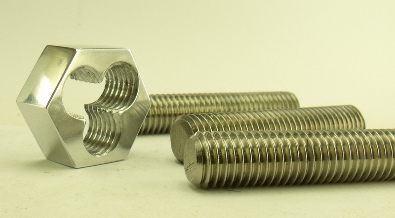

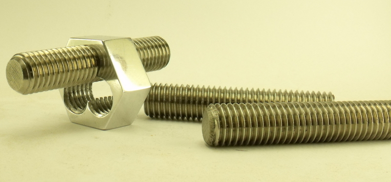

First I marked out the holes so that they would overlap once tapped.
Drill all three holes
Then tap the first hole.
Insert the first stud.
Using the threads of the first stud to align the tap for the second hole. In other words get the teeth of the tap in the threads of the first stud.
Now tap the second hole.
Screw in the second stud and now use both studs to align the tap for the final hole.
Tap the last hole.
See? I told you it was simple !!:biggrin:
