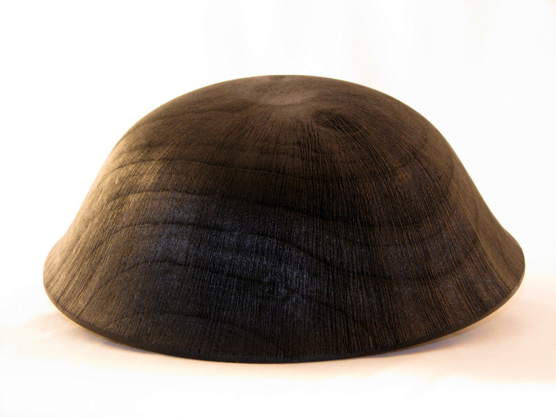

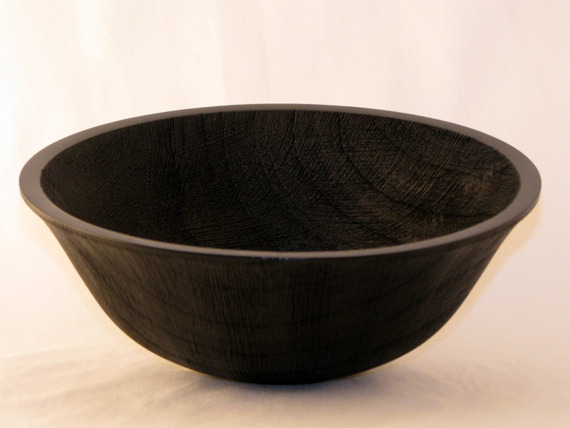

Textured & dyed Sycamore bowl

8 1/2" x 3 1/4" Sycamore bowl, textured and ebonized.

Tony, nice color tone. How many coats of ebonizer did you use and what is your preferred method of finish after ebonizer?

Thanks for the comments.
Greg, the color tone was a complete accident. The bowl was going to be red, but I forgot to give it a coat of diluted shellac before applying the dye. It bled through very badly on the end grain. Then I attempted a mahogany dye over the red. Looked horrible. Finally, 2 coats of black were applied. All 3 dyes were Fiebings alcohol-based leather dye from Tandy. Final finish was a couple of coats of Deft gloss lacquer.
The tone is very close to what I have produced with just the 2 coats of black, which Fiebings calls USMC Black. I really like their dye and it is relatively cheap.
By the way, texturing was done with a wire wheel.
-Tony
