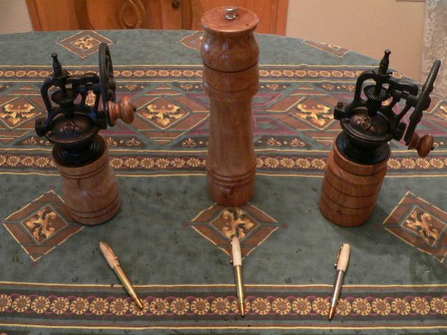

i had some time to spare yesterday so looked to see what i could make from the old woodpile. the peppermill is 13"tall and 3.5" dia. at the base, 2.75" at the top. the other things are coffee grinders, and some antler/bullet pens.

Nice PM... I make lots of them. One of the more fun things I turn. I like the crush/Grind mechanism better than the standard... I don't have to be so precise in my measurements... and sometimes I am measurementally or maybe just mentally challenged.

Those are really sharp!!! Where did you get the parts for the coffee grinders. I have never seen those. They look like a nice project.
the coffee grinder mechanisms are from PSI, and CSUSA sells both those and the peppermill parts. when i have em on display for sale i always drop in a few beans/peppercorns so they can be demonstrated. the thru hole on the coffee grinders is 1" which works fine but needs to be inletted 1 1/2" dia. and 1/2" deep on top to accommodate the bottom of the grinder. the last 2 measurements are a guess so need to measure first.
