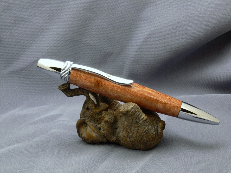

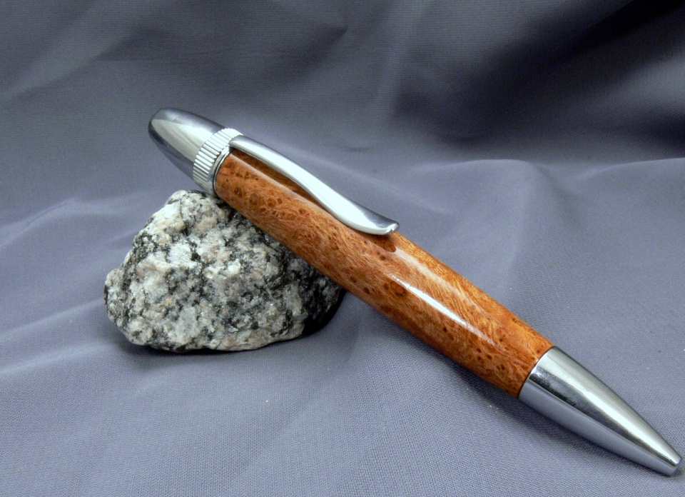

I am one of the many CA challenged pen turners. I can't seem to consistently put a CA finish on a pen. One pen looks great and the next looks like something I stepped in at the dog park. For the last three months I've been trying out some of the hundreds of methods others have posted on the IAP. Up to this point I've just been using test blanks.
I finally settled on a method that is sort of a combination of methods others use. It's nothing earth shattering, but it gives good results and is simple enough that I can get it right repeatedly. Last night I decided it was time to try a test pen using this method. This is how it turned out.

I posted another pick that shows the gloss a bit better.

I too was a CA challenged turner until I found a video by wood wimbsies that explains a good way to apply CA. Three coats of thin and three coats of thick. Then micro mesh dry from 1500-12000 and for a final of polish wheel. Since I've started following this process, not one failed finish or redo on the CA allocation.

Looks great!
There are literally hundreds of ways of doing a CA finish, but finding the one that works for you every time is the hardest part. I don't think anyone can just follow what someone else does and get the same results!
That said I think you found the one.
Good luck on your future pens!
