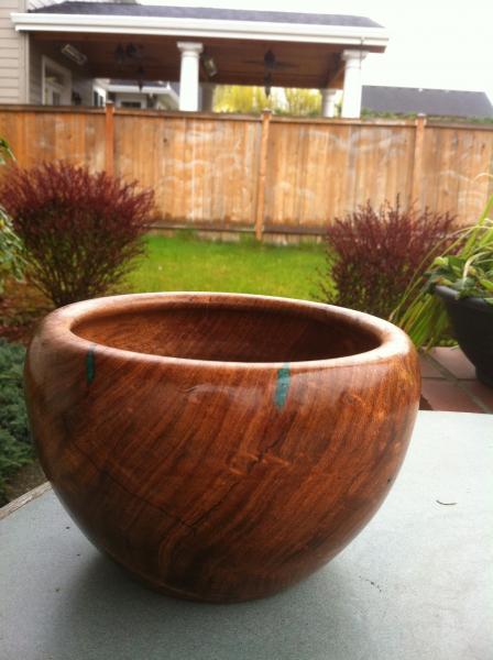

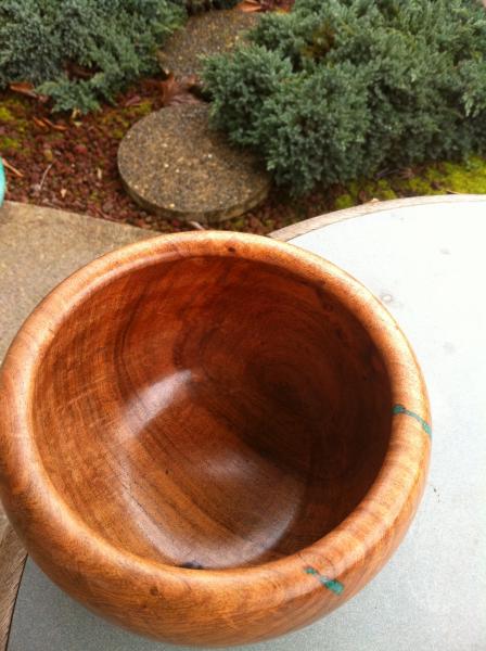

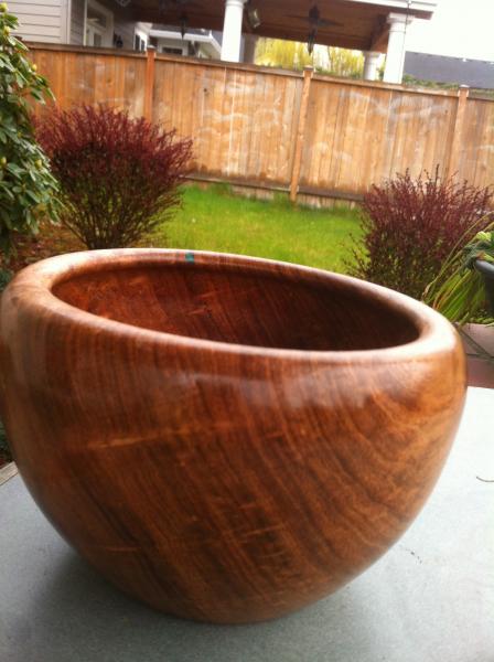

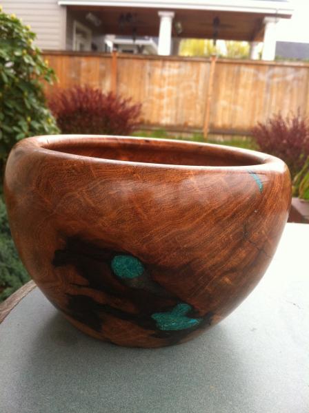

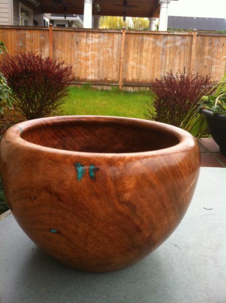

I recently made this in March 2012 as a gift to my 82 year old mother. She was very proud as she didn't know that I can do this then she bragged about it to whoever could see it. It's made fromTexas native tree Mesquite. It's very sturdy wood and very forgiving in that if youmake a mistake you can patch it and continue. It tools easly and holds up very well.
sorry, I didn't get chance to measure it before I gave it to her, but form what I can recall it's about 7" in diameter and 6.5" tall. It naturally had some cracks in it that I found it to use tuquise to fill it with the help of CA glue and 15 min. epoxy.
thanks for looking and enjoy it. This must have been my 10th creation and along the way I had many catches and blow ups.
I am willing to trade a box of Mesquite size of a large flat rate box(12x12x6") wtih your local grown blank that are not grwon here in S. Texas. if any interest please PM me.
Thanks for looking

Nice job, did you use very fine turquoise or small chunks? I've been tempted to get some and try this some day. I've been eying one of the diamond wheels for sanding the turquoise.
tim self
Oct 2, 2008
2,150
Atoka, Oklahoma
Nicely done Phillip. Nice finish as well.
Eric, I use Abranet or regular old sandpaper to sand the powder.
phillywood
May 10, 2010
2,067
San Antonio, TX, 78250, USA
Eric, I used bits for the larger cracks and holes and ground ones for the narrower crevices. you try to find bits and pieces to fill the natural cracks as close as possible to the bowls surface. But, for grounding it I put the pieces in a mortar and pestle and ground it as fine as you can. then you put CA glue on the cracks first then use a little pen tube and make a itty bitty funnel so you can sprinkle the dust on the CA. then you put more CA on it and then immediately use the accelarator to dry it faster. I sanded it with 180 grit so you won't grind away too much from the wood around these crevices. I am going to try to utilize other stones based on the grain and the color of the wood to accent them. Oh, BTW, the finish is 6 or 7 coats of salad bowl finish that you buy from woodcraft store. Word of advise, make sure that you use 400 grit wet or dry sand paper in between the coats and every time take it inside the house and let it dry so it won't be tacky if you decide to give your bowl away for utilitarian purpose.
