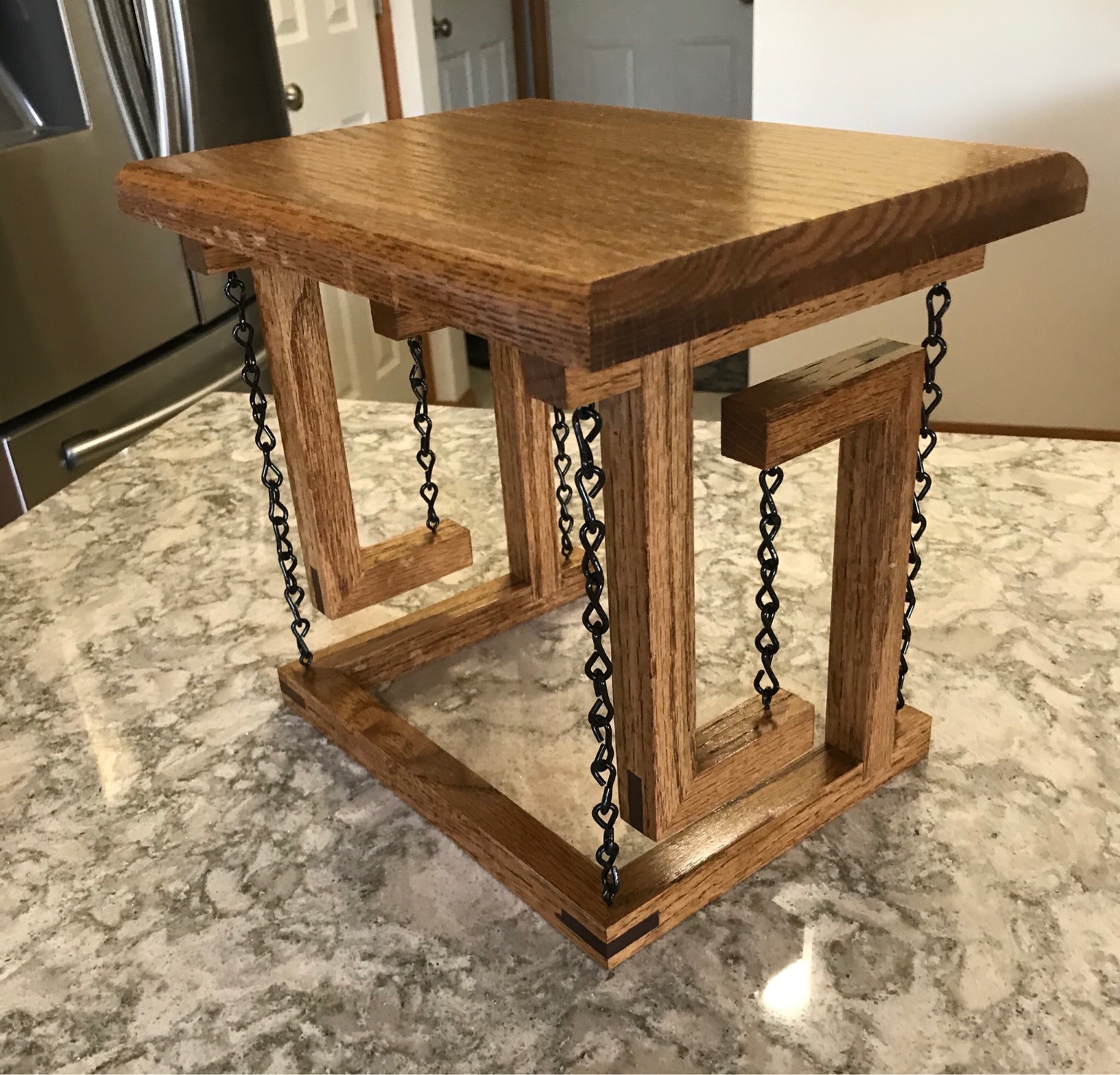

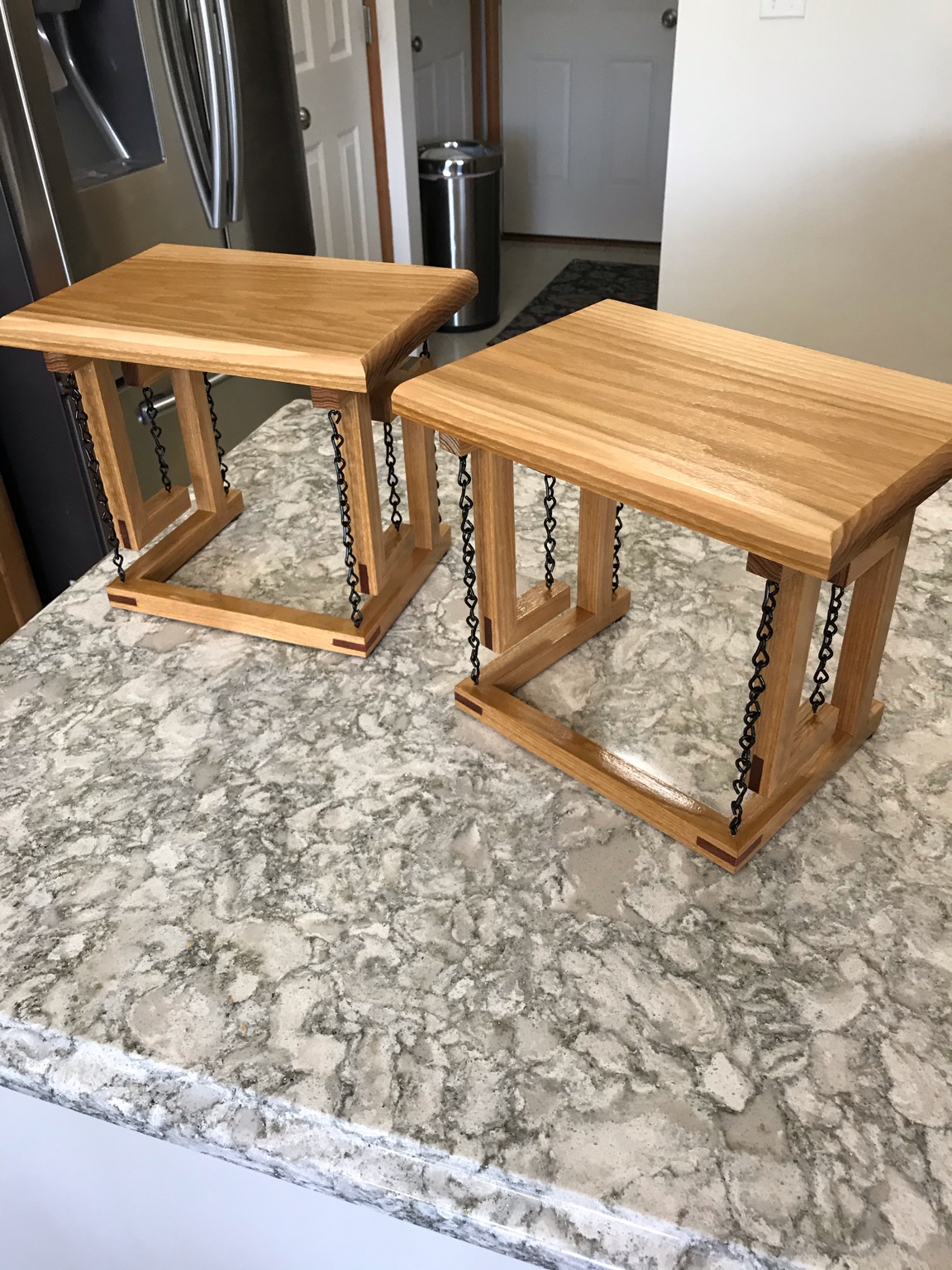

I showed one of these a little while ago. I have already sold 3 of these. I shortened the height about two inches from the first one and splined all the miters. The splines add a great deal of strength and add an appealing design element. This one is solid red oak with a black walnut stain. The ones I still have in process are solid hickory.

The splines really add to the project. Nice work.
I agree. These splines were done on my router table. I built a new spline jig for my table saw last weekend so I can do thinner splines. Probably could do two splines per corner for a different look. These ones are a quarter inch, ones done on my table saw would be .102, with my current blade.

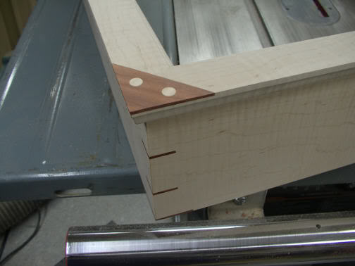

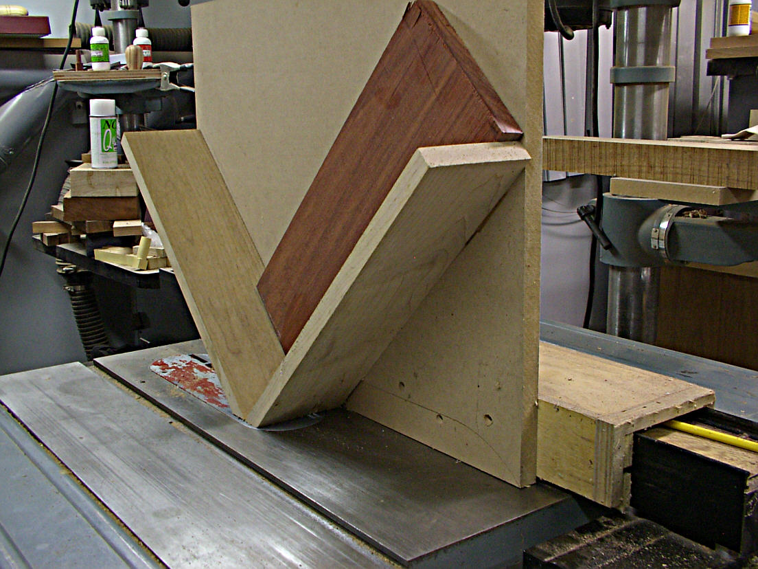

Splines do add strength and also a nice visual effect. I use blind miters many times to reinforce 45 degree corners and usually do those with a router. Have done many decorative splines in boxes, frames and in this case a display case that eventually will be for my special pens. Never did get around to finishing this project. But it is on my list. For these I use my tablesaw jig.

That's a great idea sandwiching the jig over the fence. My jig is more of a sled using the miter gauge slots.

Now, that's about the coolest thing I've seen today! Must be interesting to get the chains just the right length to keep it steady. It's always nice to see new ideas out there. Great work! Keep them coming. :D

I just slide fence one way or other to zero in on any amount of slots and raise and lower blade to get depth. Can change slot width by using a dado cutter or just slide the fence more.
Took that photo quite awhile ago and I noticed in background I must have been working on birdhouse ornaments too. That is my problem I have so many projects going on at once and do not finish many. That cabinet needs to get done soon.
That is a key component. The links of the chain I bought are exactly 3/4 of an inch long, so it wasn't too hard to figure the lengths out. The eye screws give me some room for adjustment.

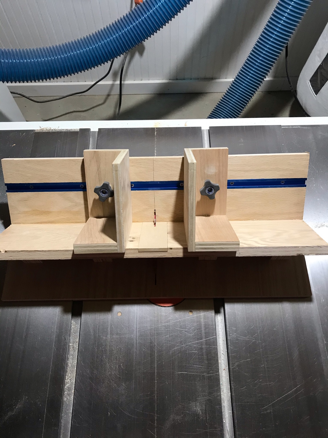

John, here is a picture of the spline jig a built for the table saw. I have used it on a few picture frames and it worked flawlessly. If you look close you can see that there is a replaceable 1/4 inch mdf backer piece to eliminate tear out.
Ken I can see how that can work just fine also. Has the ability to vary depth and width and that is what counts. Like yours or mine we can tilt blade and angle the splines too. Gives a nice look. Thanks for showing.
Funny, I never even thought about cutting them at an angle. You are right though, it would be very easy to do.
