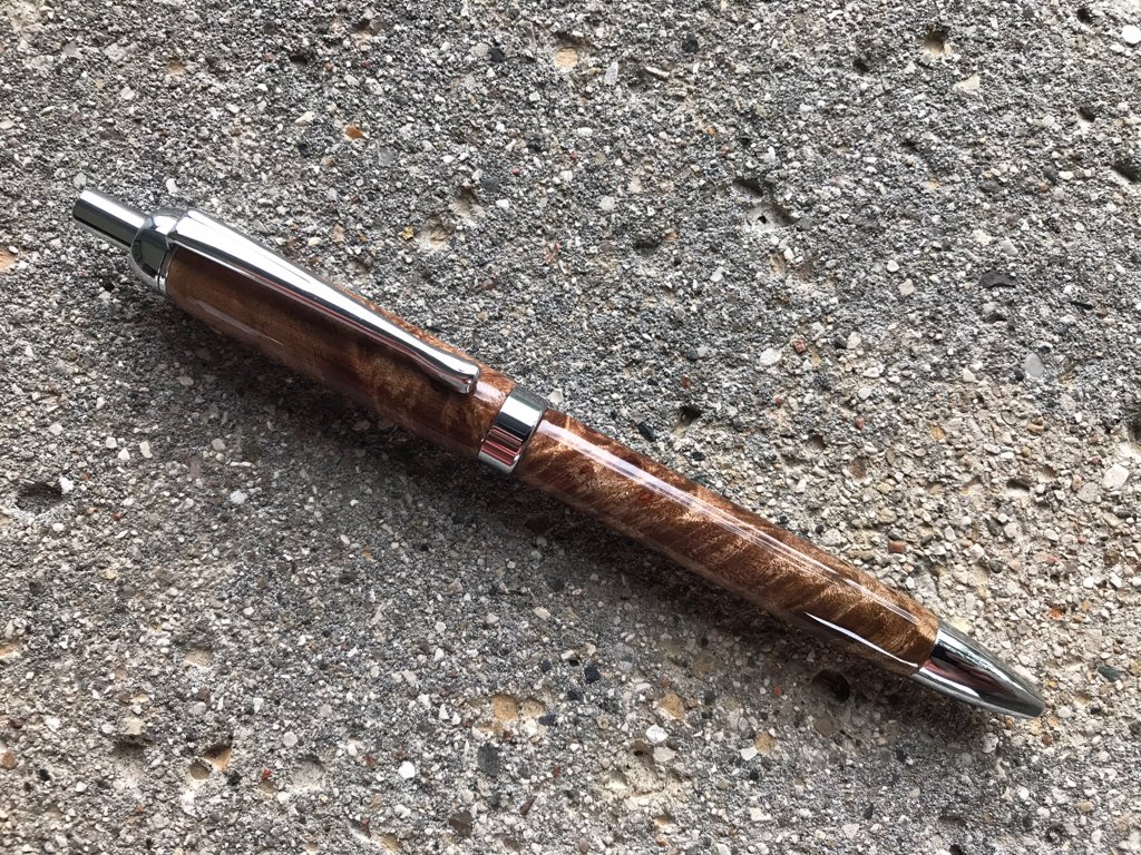

This one I am pleased with.
The burl I got from exoticwo
Dip finish with KBS Diamond Clear.
Yes looks good and with a really good finish. Must look into diamond clear as a possible alternative to CA[emoji848]

Thank you all for the compliments!

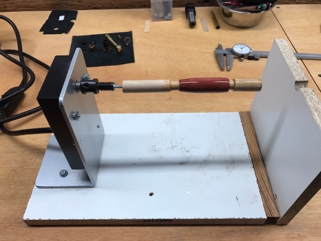

Thanks Patrick, could you just explain the rotisserie for me. Is it something you've made or bought?
I'm amazed at the finish you achieved straight from the tin so to speak.
Sent from my Nexus 6P using Tapatalk
You are very welcome.
Since a picture is worth a thousand words...
This came from PSI. I had to glue a small screw to it for attachment. Some buy a grill rotisserie and that would be fine if it has a similar RPM. Another member tried one running at 3 RPM with issues, too slow.

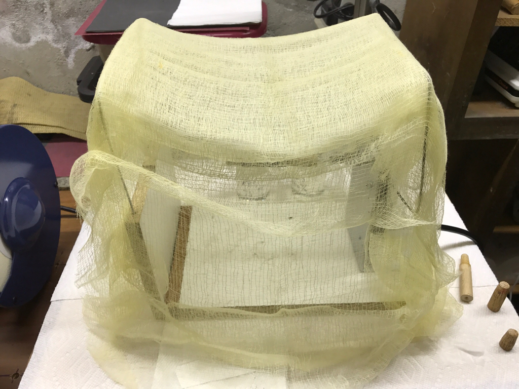

Dust nibs can be a problem. Anything you can do to minimize dust will help. I'm doing it in the shop, not ideal. I'm going to try a tack cloth used as a tent.
Thank you for the info, I can see another superb finish coming along on your rotisserie [emoji106]

About the rotisserie .....
..... had a quick look on PSI but could not find the motor there.
If you can find it, please post the link. . Thanks

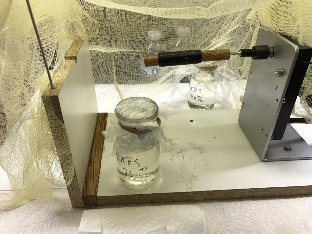

I have been refining my process.
I moved it to my basement = lower humidity, and LESS dust.
Ive dipped 2 sets at a 25% reduction. Two coats each. They look great, no dust nibs and no bubbles. The paint saver is a must.

I bought this motor on Amazon, it is 18 RPM and made my own:
CHANCS TYC-50 Synchronous Motor 110V AC 15-18RPM CW/CCW Torque 4W https://www.amazon.com/dp/B012W09VYQ/ref=cm_sw_r_cp_tai_7kFSzbBCXZE9Z
Works great.
