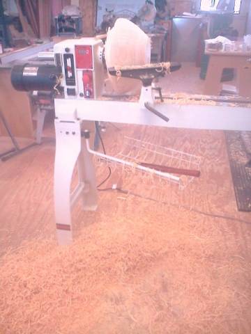

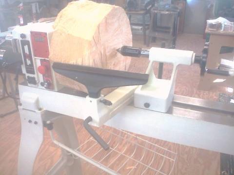

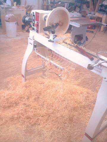

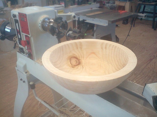

SO for the past 4 days I have been turning BAPB's (that's Big A** Pine Bowls). Got 4 roughed out and drying so far. Three significant observations:
1 - Wow, big wood blanks are HEAVY! My back is killing me! Just getting the blank ready to go on the lathe is an athletic event.
2 - Turning something that big (I have a 16" swing on my big lathe) is an adrenaline rush.
3 - On each bowl so far I get about halfway through the roughing and I'm standing there, drenched, ankle deep in curly shavings and smiling like a madman. Is it right for a human to have this much fun?
Like I said in the header, this is a tease. The 4 so far are about 15" in diameter, the walls are about 1 1/2" thick and they're wrapped in newspaper, slowly drying. Not very photogenic. In 6 months or so I'll finish turn them and post some pics (I hope). Stay tuned.

Turning green wood is a blast. Just make sure you clean up all the water that came from the turning of the green wood. It tends to turn your tools a rust color!
You can also turn the green wood to finished size and put them in a paper bag to dry. If you keep the walls the same thickness they will dry to a nice oval shape!
Surely those bowl blanks lost some weight....and in a hurry too! Just be thankful the BAP bowl blanks weren't BASRO bowl blanks(SRO=Southern Red Oak)!!!
What kind of dimensions did you end up with?
What are you going to end up finishing them with?
