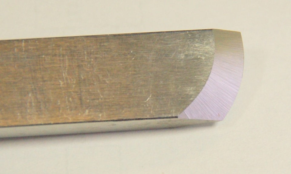

I have adopted Alan Lacer's grinds on my skews and it made the difference between frustration and excellence for me. I was about to give up on the skew and now it is my go to tool for pens. It works well on acrylics, burls, hardwood and anything else. I have found that using his veneer "peeling cut" initially, I can get from square to round very quickly. Then depending on material it can be used as a shaving skew or even as a scraper for very fine finishing cuts. Here's a little 1/2" skew that I reground and really like now.
