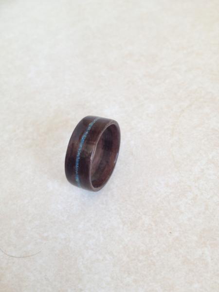

Erik831
Nov 4, 2012
318
Salinas CA
The above ring is of oak and spalted sycamore, and was made to someone else's order - I'm not a fan of the ply look, and cutting thin veneers out of stabilised spalted wood by hand is not my idea of fun - this was for a fried of mine in Cumbria, and he sent me a foto of a 'square ring' (?!?) and said 'do your thing with that' - he paid me for the privilege of making it for him, was very pleased with it and I enjoyed the challenge. To date this is the only item I've made and 'sold', but not because I've tried and failed - just want to be sure I am ready before I get into all that sort of thing - I hate all that 'business' stuff and would be happy making gifts for the rest of my life ',;~}~
The ring above I made for my MIL as a thumb ring for last xmas - it's made of holly that had been well weathered, and Britannia silver - she'd been admiring my own similar ring and hinted she'd love one like it. Mine fit her so I had the size sorted ',;~}~
Some various early attemps from 'pseudo-stabilised' woods before I started using the good stabilising sauce from Curtis' place ',;~}~
That last one up there - spalted sycamore again but laminated with aged/oxidised holly again - first time I made a veneer laminate, first time I silver soldered a strip into a tube, and first time I ever tried to fit a wood ring with a silver insert. Can you believe it involved hammering the silver into shape on the wood ring? Too small to be worn but it was just an experiment in materials and execution, for the experience alone.
I've done others since but not u/l photos to the web yet.
And apologies for the poor quality of some of the pics - taken using a little 5+ year old Cannon compact in NW England's reliable glorious daylight.
So, I showed you mine show me yours now bud ',;~}~
Cheers!
FlowolF - hope I did the pics right for the posting?!?

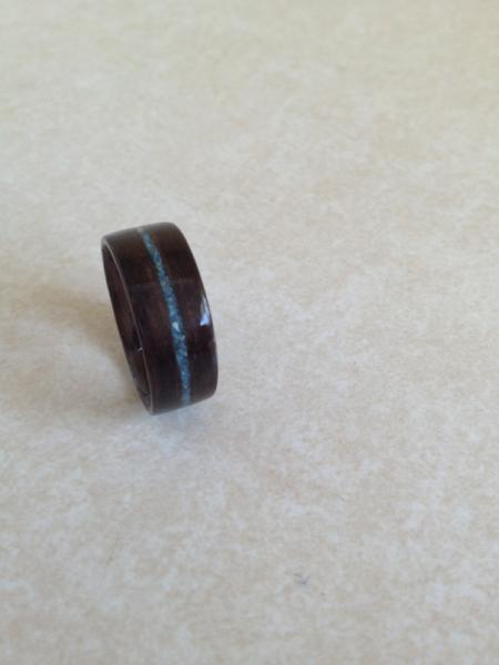

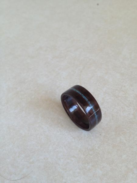

Those rings are beautiful, I was just considering (last night ) try to make rings with metal band and checked the "bangleguy" website ,he sells metal bands that you just put the wood around the band, check it out looks pretty neat, at any rate I been trying to learn the bentwood method for ring making I have a lot to learn ... so many fail attempts , it requires a lot of patience which sometimes I don't have .. Here is a picture of one that I made last week I believe is Indian rosewood with mother pearl inlay

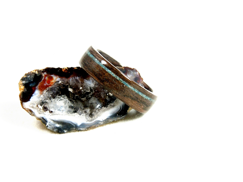

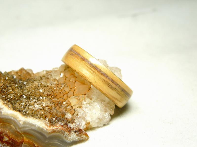

Erik831
Nov 4, 2012
318
Salinas CA

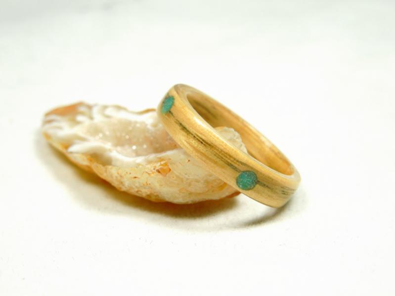

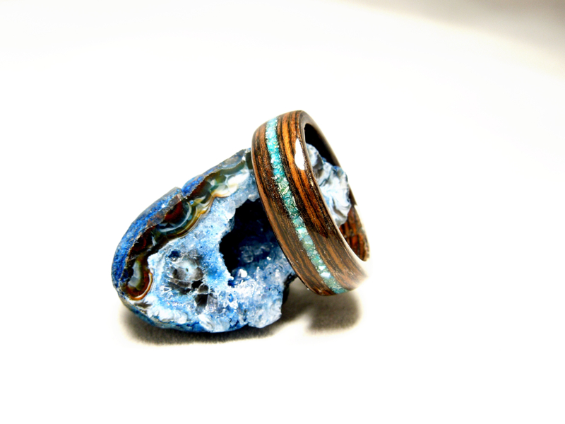

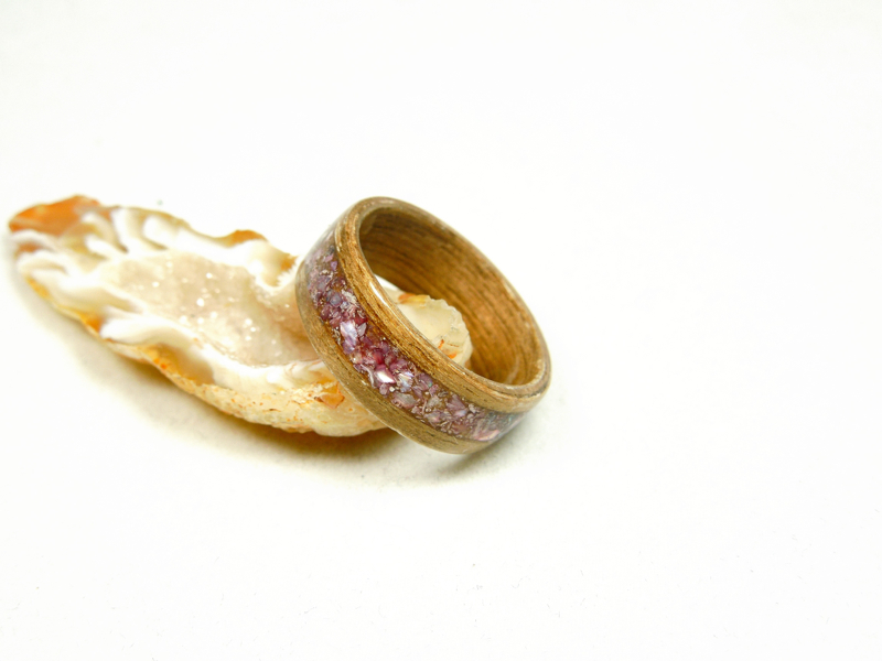

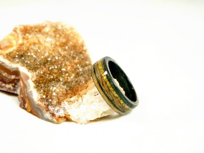

A few more rings
FlowolF
Mar 15, 2013
74
Ribble Valley, East Lancashire, England.
Thanks for that bud ',;~}~
Nice job yourself there - love the inlay work.
Read a lot about the bentwood style myself when I was searching for tips, but the reason I started making mine was because I fell in love with spalted or otherwise 'time and decay improved' wood I was finding around here - I wanted it to show all that paterning and the bentwoon style wouldn't allow for that, even if I could cut the spalted wood into strips - I had to find other ways of giving my rigns strength. So I played with the cross sections and various stabilising teks. but couldn't get many to come out so I was happy that they wouldn't break unexpectedly - my toughest plain wood band yet which had survived me and my large handed clumsiness for months, cracked into 3 seperate pieces after an overly bucth and enthusiastic handshake by an ex body-building cousin of mine, drunk at a family wedding - so I started with the silver linings - the spported the wood and framed it, but took nothing away - the rings still are all about showing off individual pieces of wood that are gem worthy in their own right IMO ',;~}~
The pre-made band sounds perfect for bentwood or resin inlays! - Myself I have a real love of silver and always have, so I got into silver soldering and making my own parts/findings for other pieces, and general silver jewellery - took a couple classes in the end too which has been fun ',;~}~
Cheers bud and keep up the cracking work.

A few more rings
Noooyyyce! Really am diggin' that crushed mineral inlaying - do you use the lathe to cut the recesses?
Not used a lathe at all for any of mine (esp. since I only just got the lathe LOL!), least yet - I start with a rough cylinder, then drill/cut out a hole in the centre near-ish the size I want, then the rest is carved out by knife, then shaped, profiled and finished with abrasives - doesn't feel like a worthy piece if I haven't bled on it or sanded off some fingerprints from myself, but I'm sure I could get over that if I tried, heheheh...
Later ',;~}~
