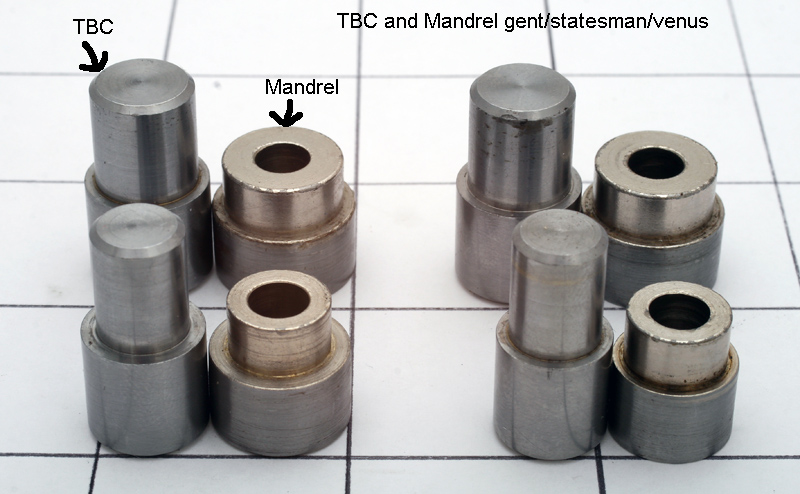

I have taken the liberty to do some good compares and the results speak for themselves. As previous mentioned items like 'cost' can also be explained in the below photo's.
Here we have TBC and mandrel bushings for the Gent Jr/Statesman Jr/Venus and related pens.

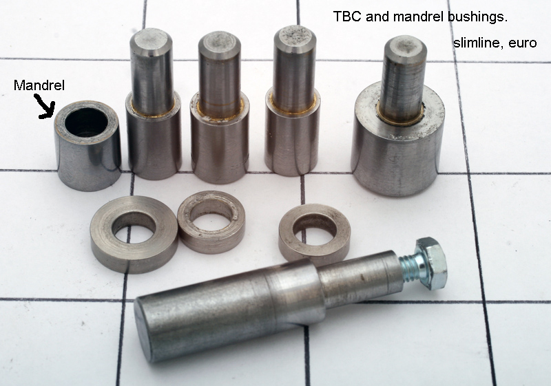

This is for the 7mm slimline, euro and related. I included a single 7mm slimline bushing and not the entire euro bushing set. The object in the bottom center is a euro mandrel, it is used to turn the end cap on a euro with a post stud. The TBC bushing set is the '7mm triple play' set by JohnnyCNC. The rings in the center are sizing washers also from JohnnyCNC.
attachment.php
As you can see the advantages of TBC is LENGTH inside the tube yields a longer, more stable and more accurate precision. Also the section outside is greater as well, this yields not only space between the dead/live center and provides extra tool rest support but also comes in very handy when hand sanding.
I have noted several times with a mandrel setup there is some wobble of the bushings because of the short length. If the mandrel shaft is not proper size there will be warping of the blanks.

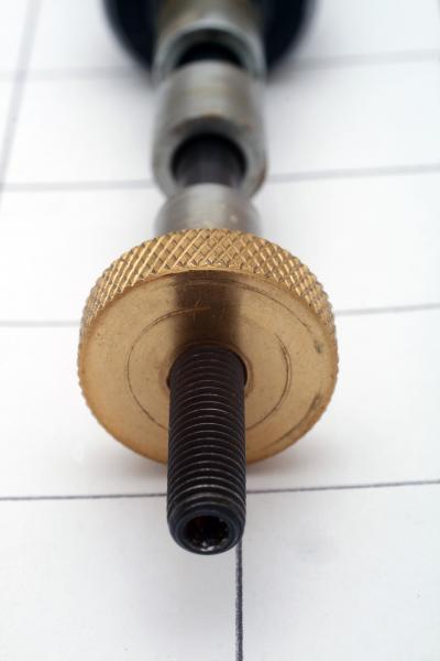

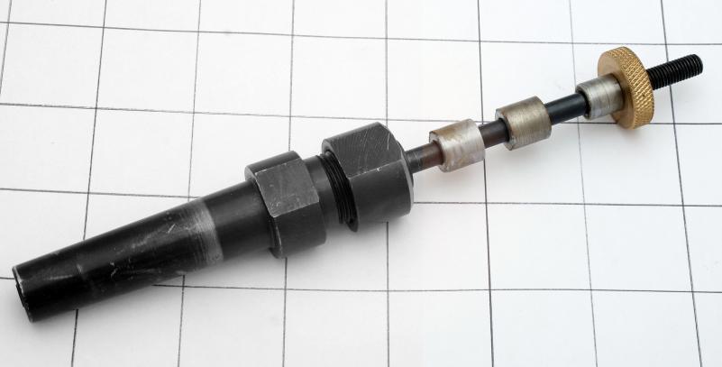

The mandrel setup that I started with was a junk design. The shaft was to prone to bending and I did bend it.
Since then I have bought around 3-4 mandrels and this one below is probably one of the better mandrels I have owned.
attachment.php

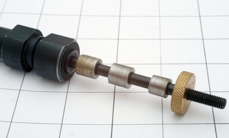

This is the last mandrel that I bought and I was doing one tube at a time with it. Now it was more precise and better fit than the other setups I used as this one is adjustable.
attachment.php
Same setup on the tail side of things.
attachment.php

Flawed indeed. Yes the shaft becomes part of the bushing and a good mandrel is a good thing. However you are still grossly limited to the bushing to mandrel contact area. I have yet to see anyone making precision mandrel bushings, is there anyone?
In the above setup a great bit of the adjustment weight is placed on the locking nut and not the shaft. Which makes the shaft less prone to warping. Also the shorter length further reduces warping.

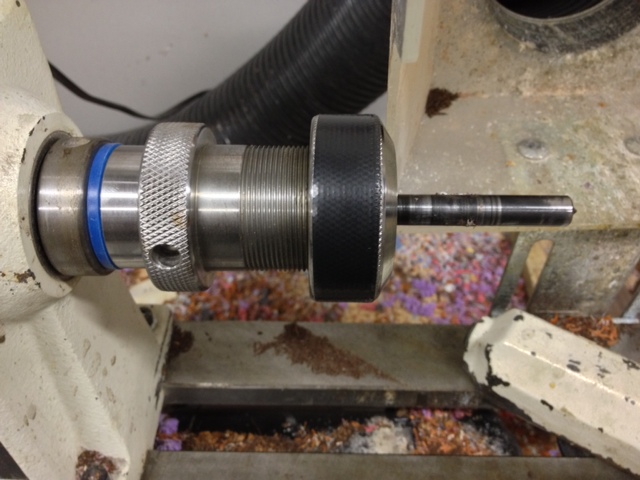

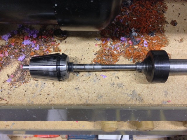

Ok... A couple of quick pictures of my setup. This may not be the cheapest setup - but I'm really happy with it because of the options it gives me, its rock solid, and easily adjustable.
In the first picture, you can see the mandrel in a collet (not in the holder at the moment, a couple of 7mm bushings (probably pretty worn because they just space things for me - I use calipers for dimensions), and a mandrel saver which makes shorting the thing as easy as moving the tail stock.
In the other picture you can see the collet chuck, which at the moment is holding a "punch" from the HF set that I use for doing some closed end seam rippers on.
I will swap back to the other collet when it comes to pen time.
