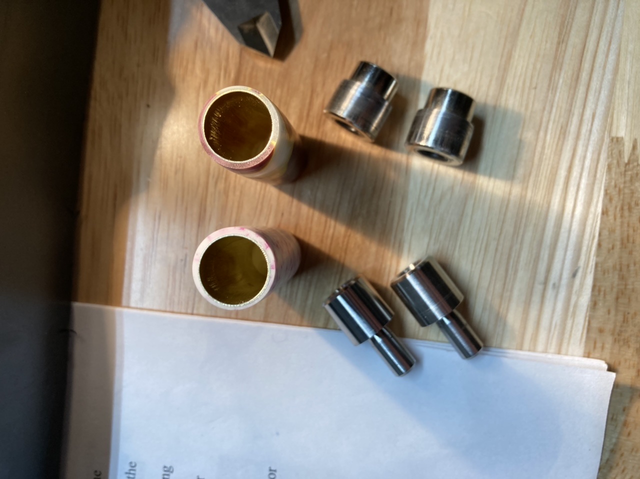

I believe they are showing 4 bushings. The bigger one is showing what they look like together. I think there are 4 bushings.
The center one is the adapter, the one on the right is a standard bushing, and on the left is the two mated together with the standard bushing on the bottom. The adapter works fine. Anything from Brian at TBCbushing.com will be the best you can find.

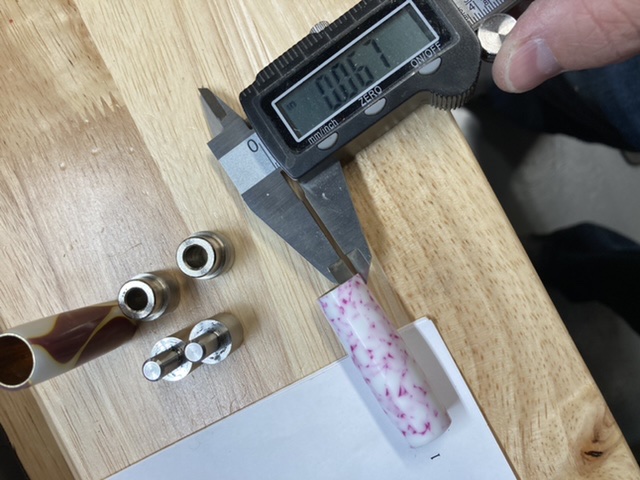

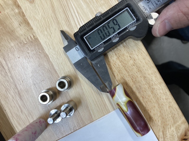

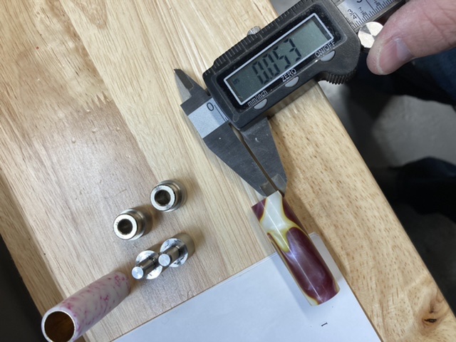

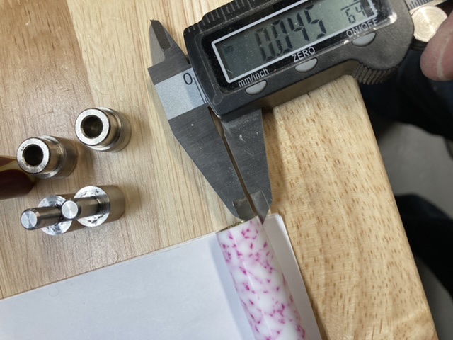

The pink fleck tube was turned with the converter bushings. The purple and white was turned in the exact same manner and I used the same bushings shown here, minus the TBC converter. The one using the converters is obviously out of round. The other I couldn't tell how out of round it is without calipers.
.006 is within tolerances— for me at least.
.022 is not. I'll be putting these items directly in the trash. 😠
