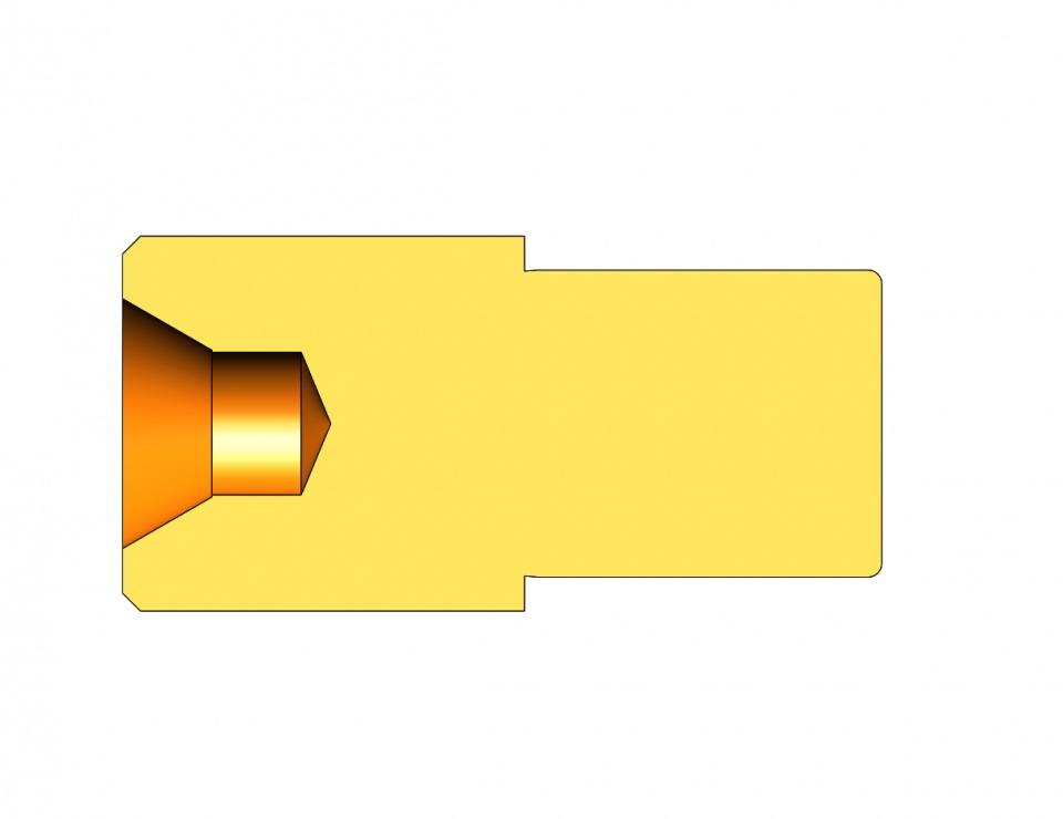

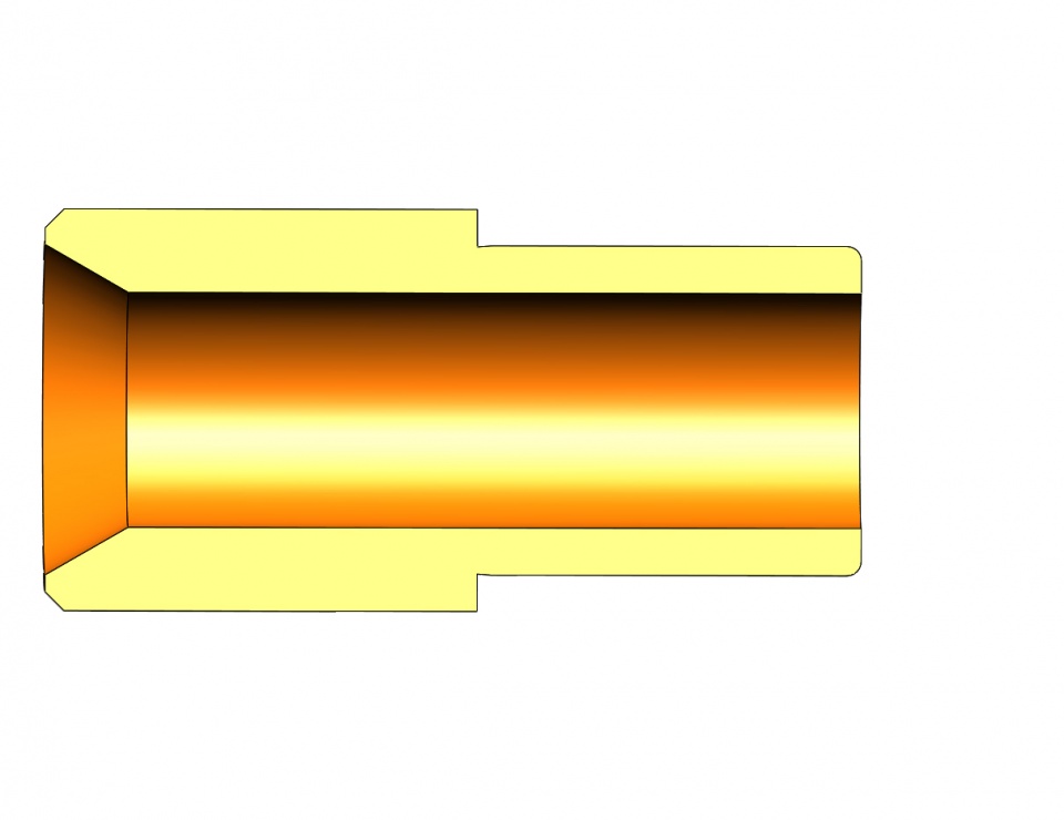

The 'hole' removes approximately HALF the weight of the bushing. Also removes at least half, possibly more, structure strength of the bushing from outside forces. The 'hole' also removes the surface contact to the live center and dead center.
For some materials this may be workable but I can see a need for heftier work loads there could be problems.
Bushings with 60 degree and no thru hole & one with a thru hole.
TBC ( Turn Between Centers ) & MTBC ( Mandrel & Turn Between Centers)
Material is 303 Stainless steel
Bushing type is for the Executive Pen from PSI
60 Degree with No thru hole
Weight = 12.04 g
60 degree Surface area = .046 square inches
60 Degree with Thru Hole
Weight = 7.65 g
60 Degree surface area = .046 square inches
I agree less material will make a part weaker but for pen turning it would be insignificant.
There are many ways around the problem using different materials like tool steel or other, heat treatment of the materials but it all add cost to the product in many ways. Probably more than double or triple, but yes it can be done if the demand is there and people are willing to pay a higher price.
BTW All bushings using mandrels has holes thru them and that is what has been used for years. TBC & MTBC is an improvement on that with better quality materials and tighter tolerances.

Maybe the poll asked the wrong question. Maybe a better question is "Would you object to making the bushings MTBC?" Could be many TBC turners just don't envision ever using a mandrel again so voted with that in mind hence the 2+ to 1 split.
From Constant's pictures it does not seem that the bearing surface is a big issue either way due to the relief hole. As for the "structure strength" of the bushing, I don't think I would want to use a pen made from material that was heavy enough to cause a structural bushing failure!
//Geek alert
As far as the weight difference, that is pretty much a wash also since you are removing the mass from the center of the bushing. The mass at the center contributes much less to the angular momentum than the mass at the outer edge, so the net effect of the weight loss is much less thatn the actual weight difference. (Solving the integral to prove this is left as an exercise for the student.)
end Geek alert//

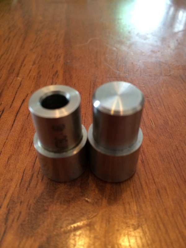

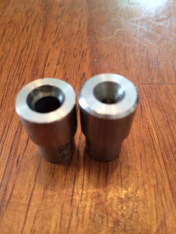

For comparison, here are Jr. Series bushings. One is Constants, the other Johnny's.
Interestingly, with the hole, the bushing contacts the center higher with the hole. Hopefully the picture show how much and where is the contact area. (This is not to prove any point, just an FYI.
Well of course it will sit higher, or farther into, the 60 degree center. The hole is larger. It has nothing to do with the taper of the hole.
If you look closely at the one from John Goodin, it is drilled with a center bit. That is to make sure the point of the center never bottoms out.
I suspect that the ones made with the mandrel hole were purposely drilled deeper to give the extra contact surface.
You are right. The live center is a cone - going into a slightly less than 7mm hole with a taper machined at the entrance, the live center has to go in until the diameter of the cone is equal to the diameter of the hole which should be when the cone contacts the tapered edge of the hole.
Well, I have both constants and johnny's bushings. I do prefer them with the hole for the mandrel.
There is PLENTY of contact left on the 60s that the tip wouldn't matter that much IMO. I never read all the way through the threads past the first 1.5 pages, But I would love to upgrade all my bushings to 60s with a mandrel hole for some kits that I still want to turn the tubes together.
