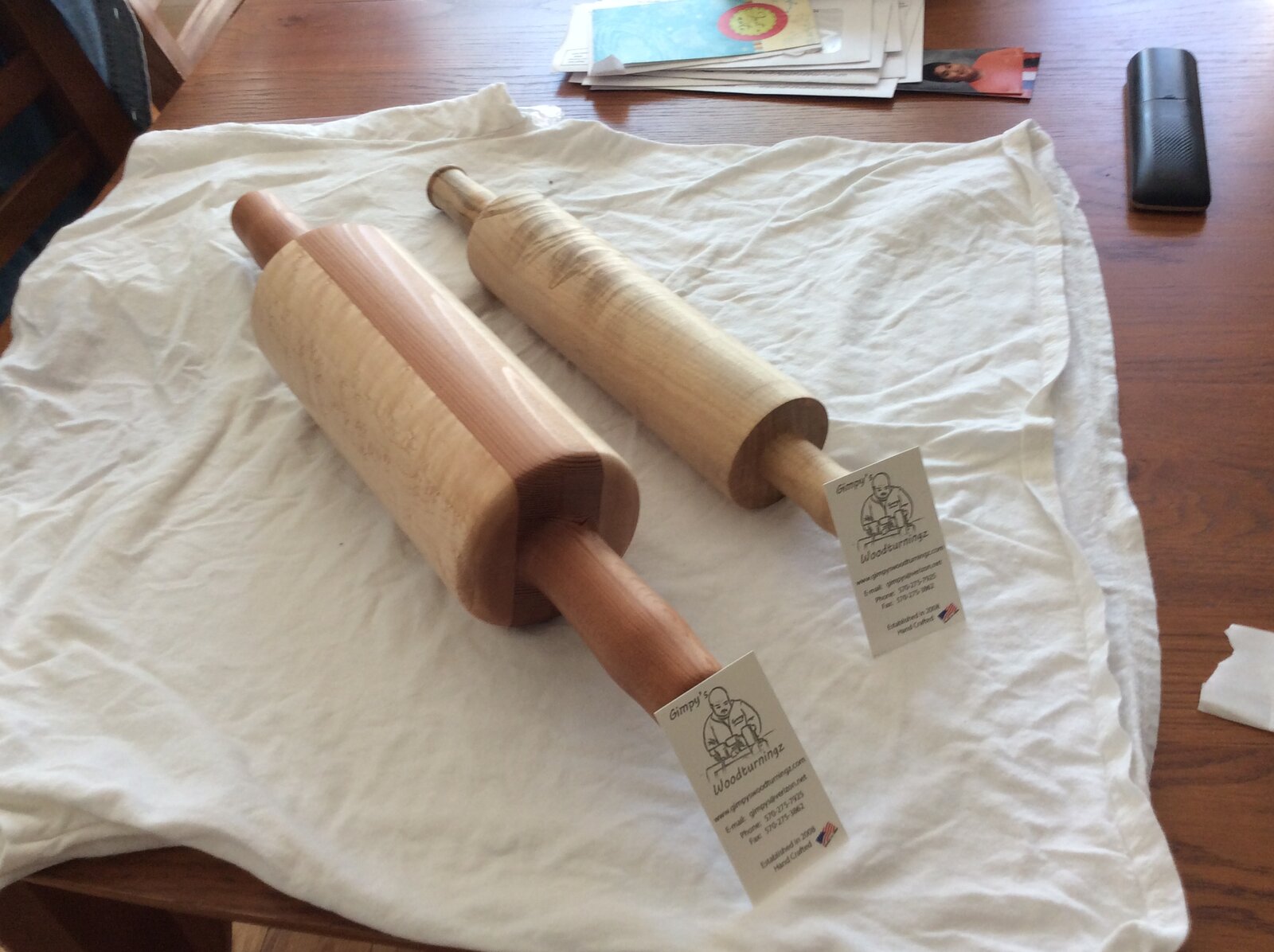

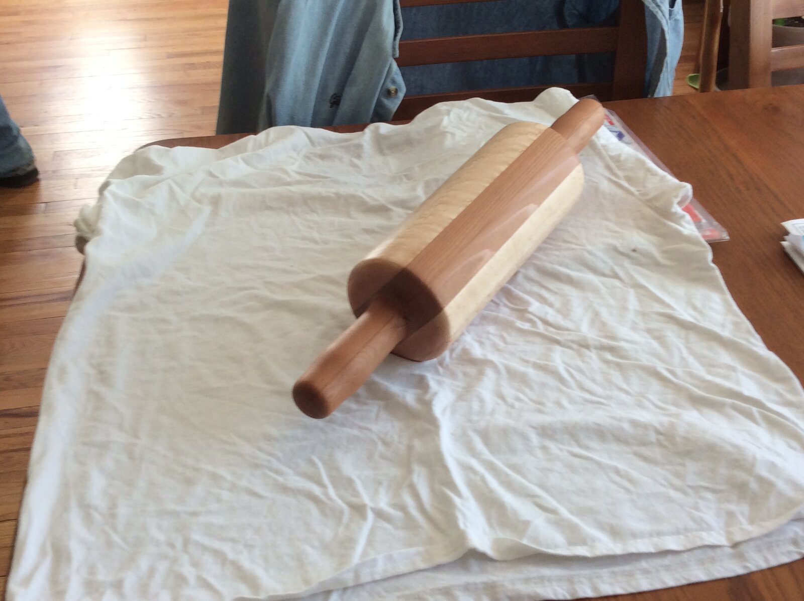

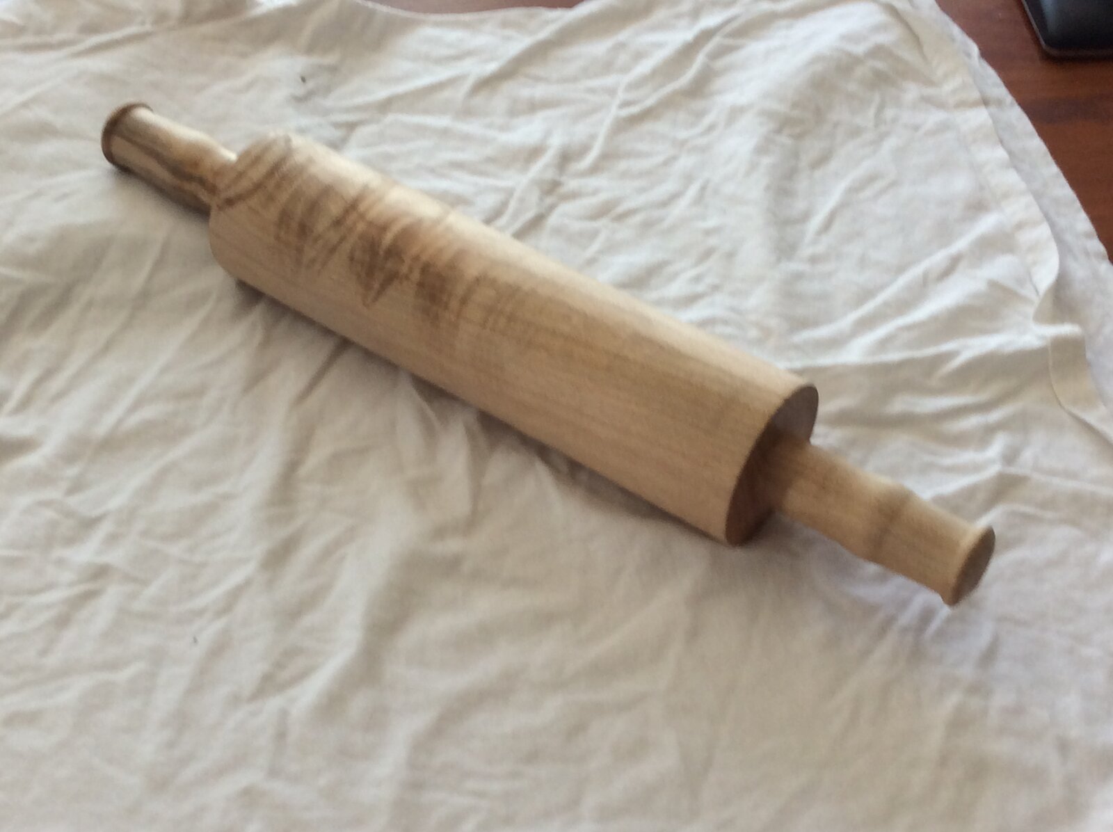

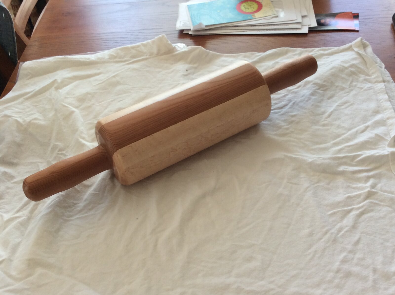

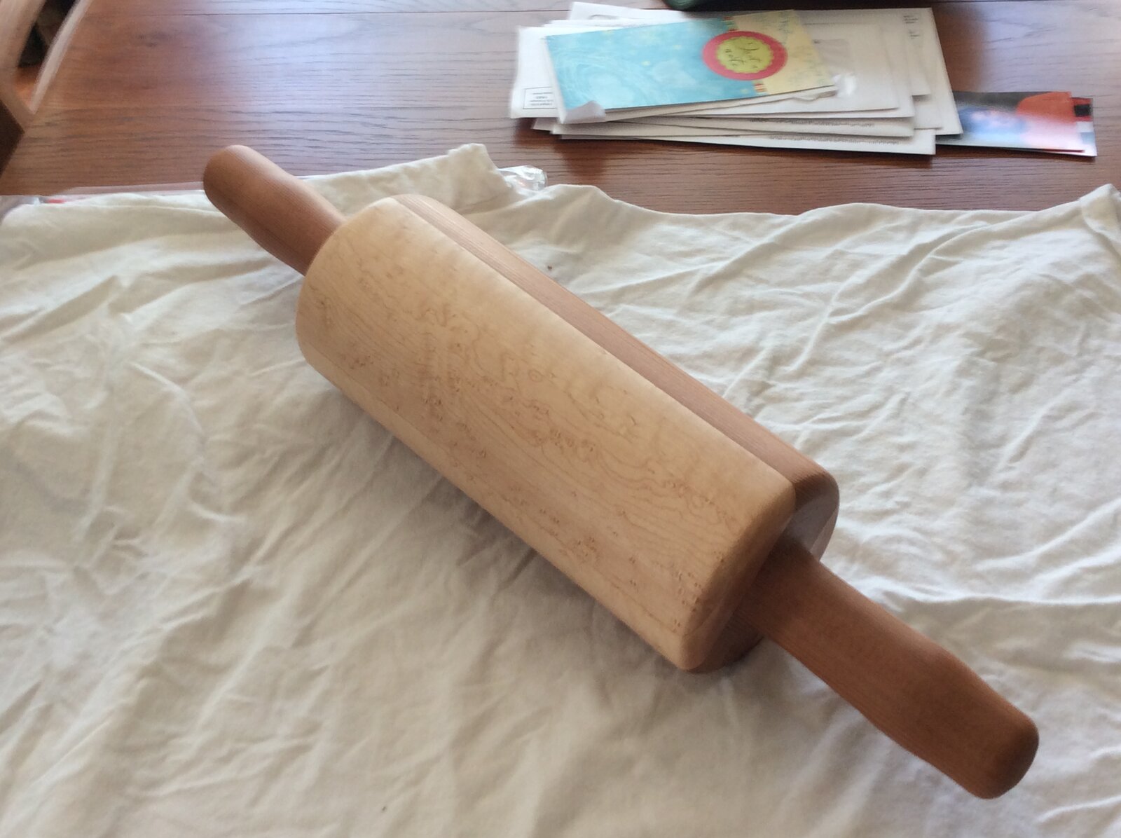

I've made a few rolling pins,
No bushings
Handles are solid
