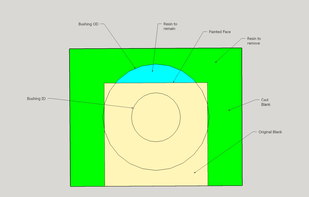

I plan on casting the blank in resin to preserve as much as the blue paint face as possible, ie: The casting will allow me to offset the pen blank enough to have a thick layer of resin over it, and expose more of the pine (I assume it's pine, I don't want to mess with the plywood one unless this one goes belly up, although I may run that piece as test #2 for practice, but I'd rather not, I have other plans for it). Quick pic for explanation:

You might want to test a little piece of the Tardis paint with the epoxy before casting the entire blank. There is a possibility the resin and the paint may react, as in melt or lift.

Oh joy... now another concern. Thank you though, I can trim a bit of the plywood piece and run a test.

I have done a few castings of different materials using both Alumilite and Polyester Resin (Castin Craft brand) and prefer the PR because it will polish up to a glass like finish. You don't need a pressure pot for PR. There has been some concern about PR being to brittle, but I have found if you only use 3 drops of the catalyst per ounce of resin will be enough. As far as bubbles are concerned, if you don't stir the resin/catalyst you should have no issues. I have also put the resin/catalyst mixture in a vacuum for a couple minutes to remove any air bubbles.
One thing I would strongly advise is making sure there is plenty of resin in your mold to cover the blank sufficiently during the curing process. I have found shrinkage (drop in the level of resin) during the curing exposing the top edge of the blank.

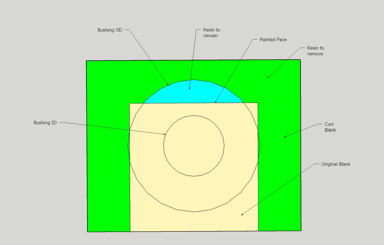

I love doing resin casting and love the idea you mention. I'm not a huge fan of Dr. Who but have watched a fair amount of the newer seasons so I definitely respect the concept.
When it comes to casting resin the poly resins will react to the slightest moisture in the wood and potentially create bubbles. When casting mix media I prefer either Liquid Diamonds epoxy resin or Alumilite Clear. Alumilite has a great YouTube video series that covers a lot of this including what resins to use for which application.
Liquid diamonds has an Amazon bundle that comes with dyes, blank mold and resin. It can be done without pressure pot but has a long cure time. Also, if you plan to blend colors of resin, wait till resin starts to setup before blending. My first attempt with Alumilite turned into a black mess cause of its long setup time.
YouTube is your friend on this. Zac Higgins also has some great videos on how to.
