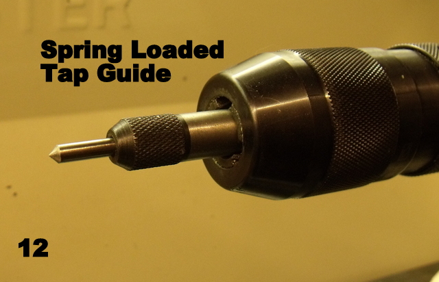

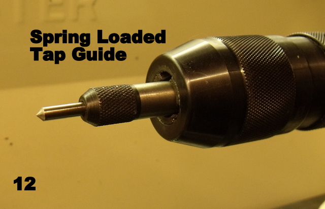

Which Tap Guide do you use? The 2 mt Short one or the "Regular" one? (from Little Machine Shop)
Or is there any difference in usage? thanks for info.

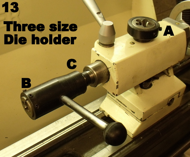

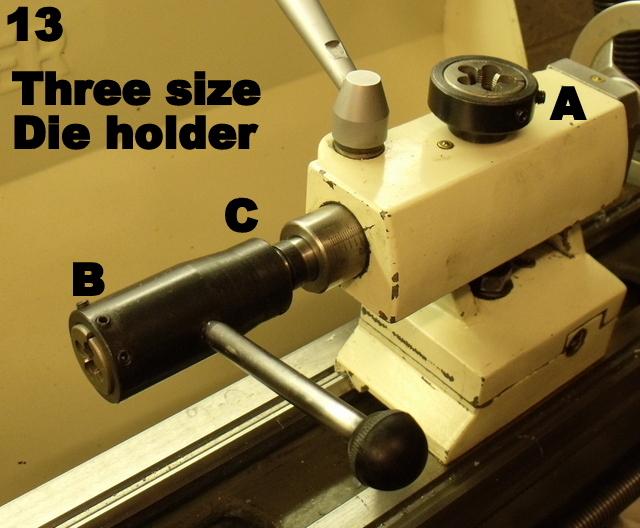

Tap guide or die holder?

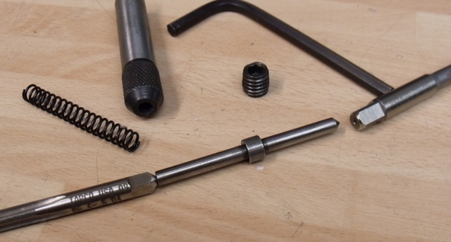

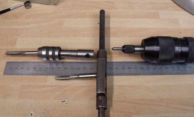

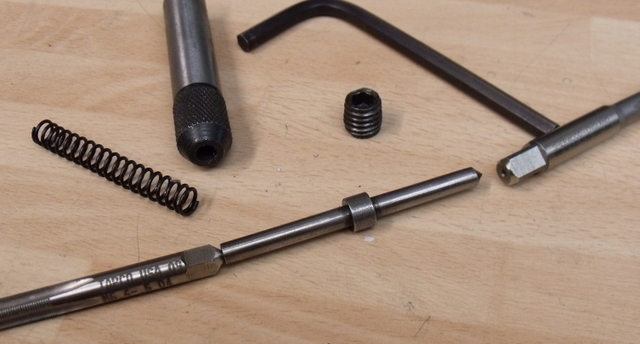

Russ, make sure the tap guide you buy has a reversable tip. It should have a point on one end and a dimple on the other. This means you can guide either type of tap.
Edit in;

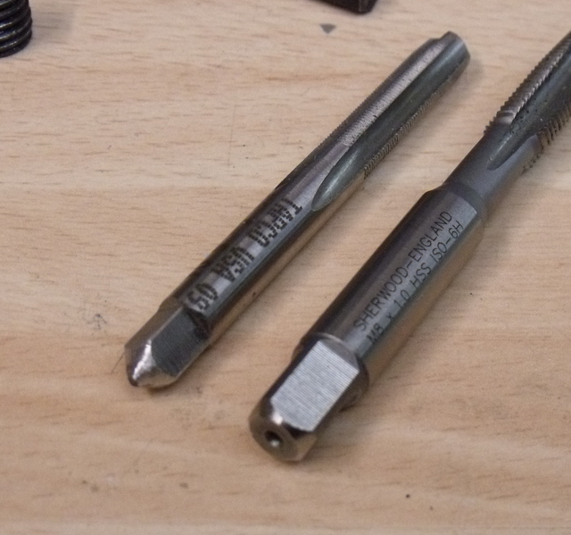

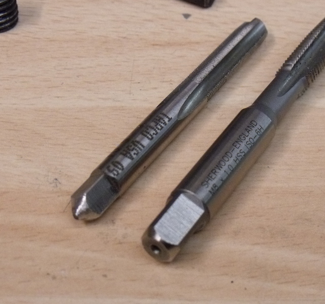

Here's a couple of pics. One tap is American Tapco which comes with a flat pointy end, but no little hole. The other tap is English, Sherwood.
I have ground all my USA taps to a sharp point to fit in the guide dimple.

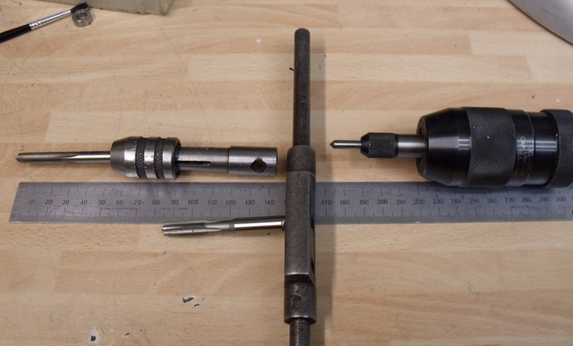

Both taps can be used in any wrench, either collet type or T bar type. But The collet type takes up valuable lathe bed length. ( yet another reason to get a proper sized lathe :wink: ) But most collet wrenches do have a hole in the end and are fine if you have the bed length.
