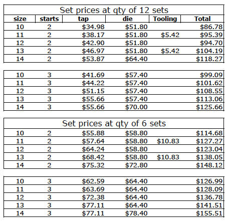

Updated prices for both 12 and 6 qty discounts. The 9 discount is about halfway between the two. We would be best off if we can get to 12 on each size being ordered.
You will notice a tooling charge on the 11mm and 13mm doubles, that is a tooling charge or 65$ split 12 ways. This charge is because Tapco has never made this size and have to create tooling for it.
Right now we have the most interest in 13mm and 14mm. Spread the word and see if we can generate some more interest to move forward with the buy.

I updated the tooling Fee on the 6qty table, as it's divided 6 ways instead of 12.
