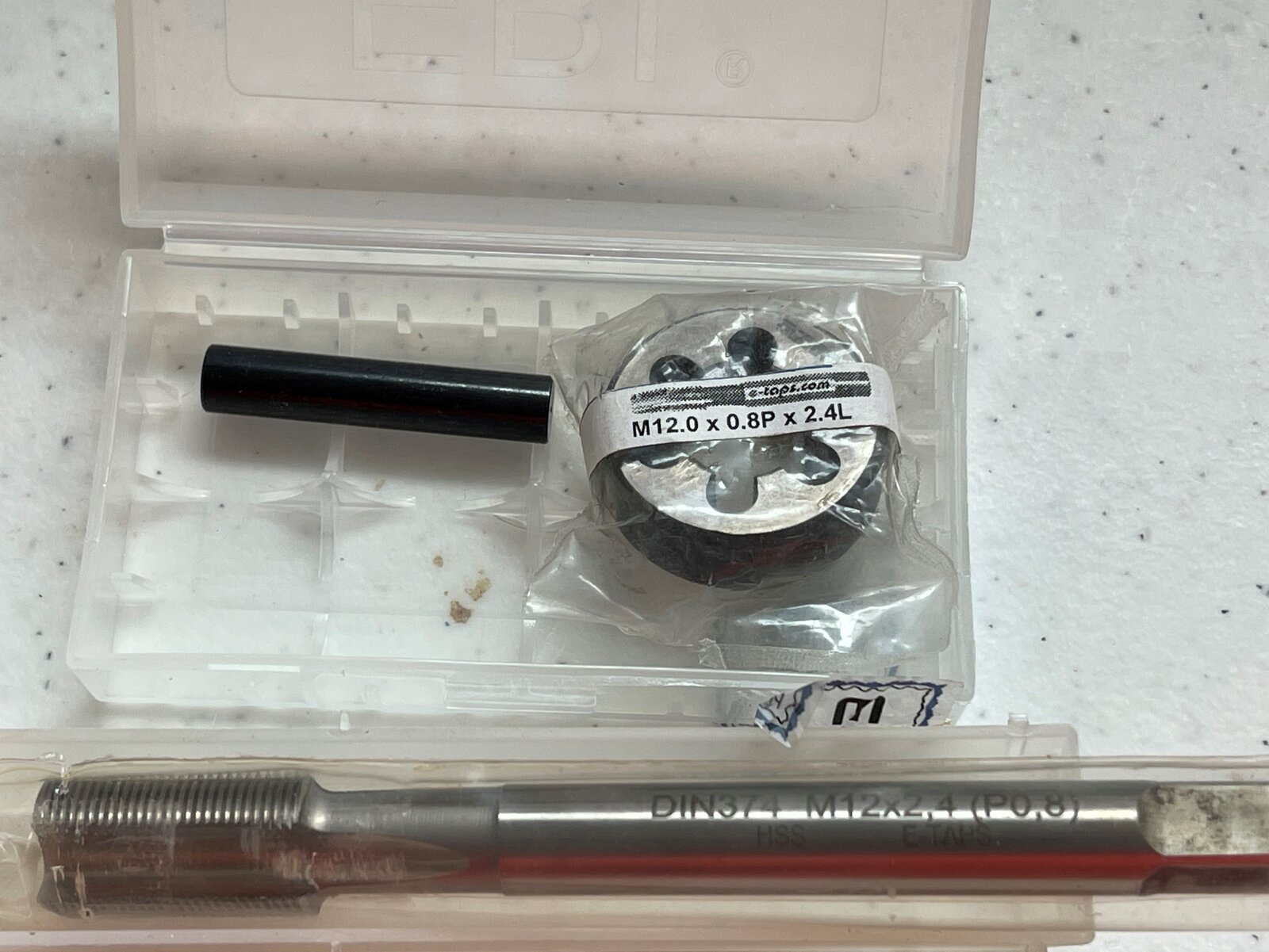

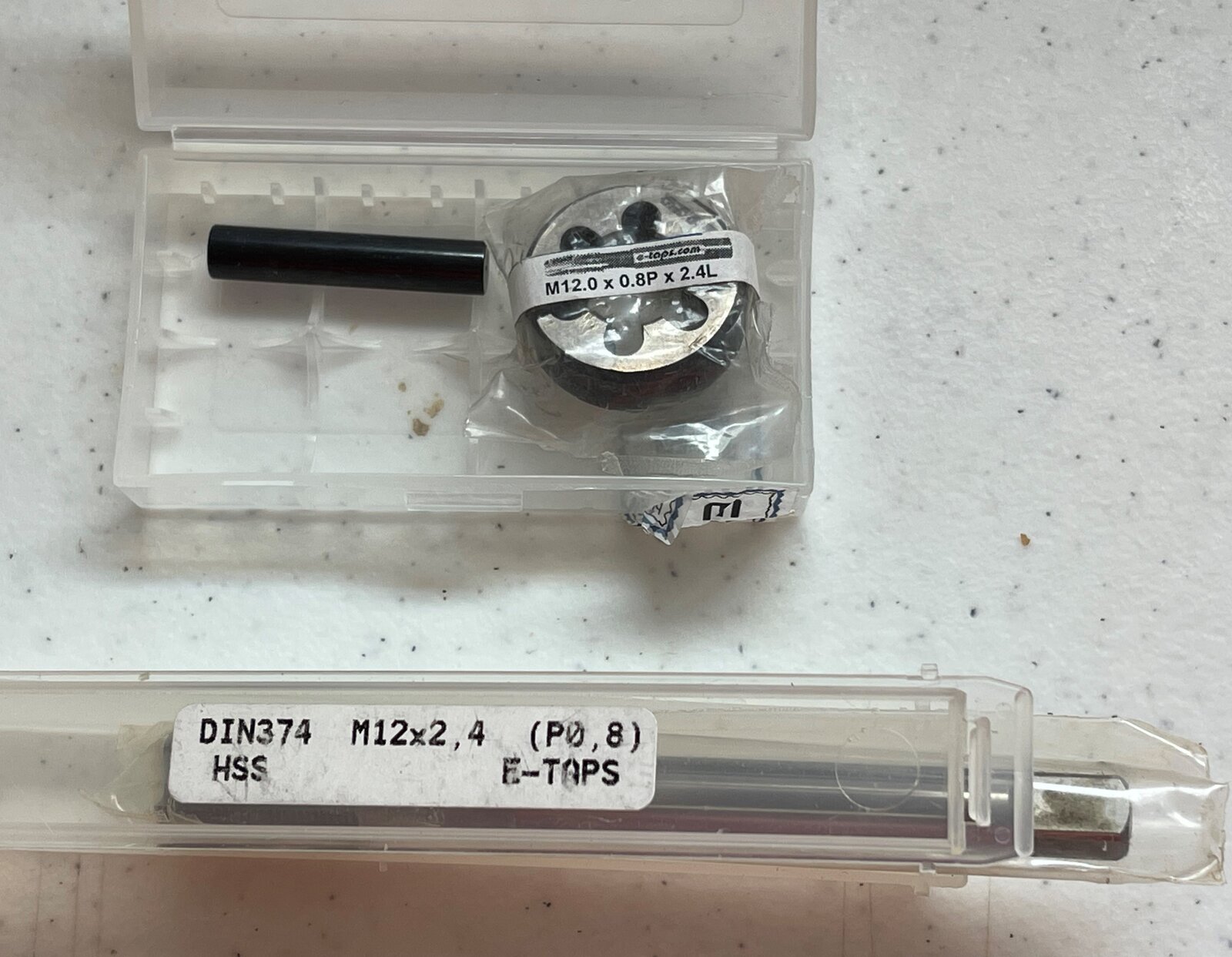

Unused Tap and die set from a previous IAP group buy many years ago. HSS M12x2.4 and matching M12x.8Px2.4L

Good morning, would you mind clarifying something for us:
M12x.8Px2.4L, My apologies I do not know how to read this:
M12 = 12mm OD
X.8 = 0.8 PITCH
2.4L = ??? (What does this part mean, I'm used to this being a 2 or 3 for double or triple start).
Thank you
I believe that "L" refers to the lead, which is similar to the pitch (in that it's a distance from one thread crest to another), but it's the distance from one start to the next, or the travel a hypothetical nut makes in one revolution - so Pitch * Starts = Lead, or, in this case, 2.4mm Lead / .08mm Pitch = 3 Start.
(had to dust off some embarrassingly rusty CNC knowledge to come up with that one, so I apologize in advance if I mangled any of the details. I've been neglecting my machining for pens far too much lately)
