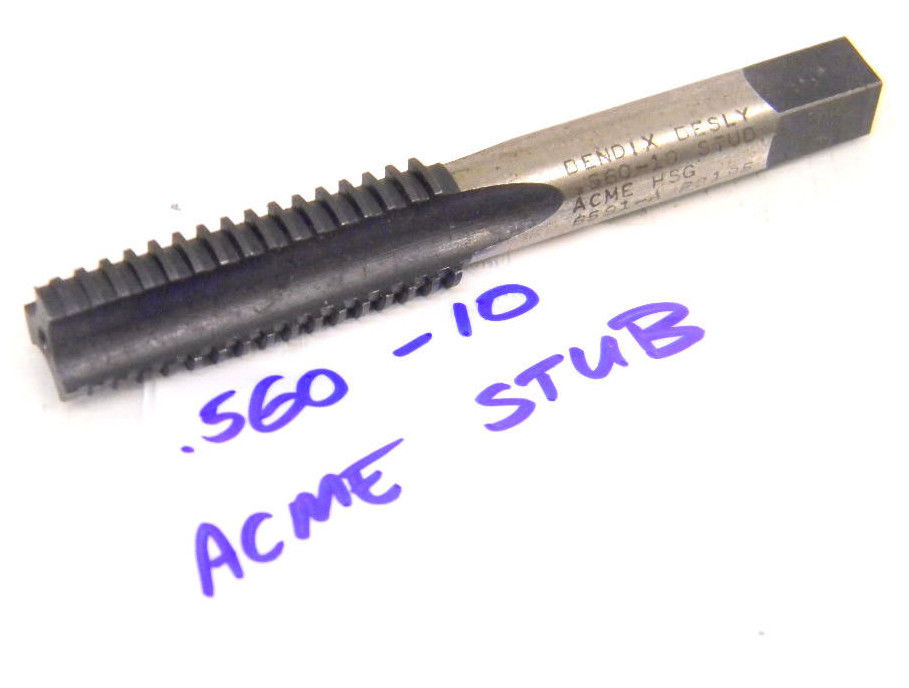

This is a 0.560" x 10 TPI stub acme tap, it cost $30. The die runs around $90 ish and can be reduced via bulk.
0.560" is 14.224mm
P1.5 = 17 TPI.
P2.5 = 2.54 TPI.
Sedona is P0.8
Gent Jr is P1.4
Emperor Jr is P1
Atrax is P1
These I listed are also around 10mm-ish.
P0.8 is to fine for this size tap. The thread strength will be greatly reduced.
9/16" - 18TPI (14.28mm - P1.411) thread yields.
Major: 0.5611 (14.25 mm)
Minor: 0.4950 (12.57 mm)
Pitch: 0.5251 (13.33 mm)
P0.8 = 32 teeth per inch
P1.0 = 25 teeth per inch
P1.5 = 17 teeth per inch.
Wider grooves = more strength, will really show up in the more fragile materials.
