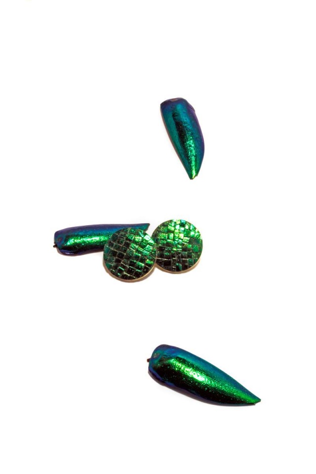

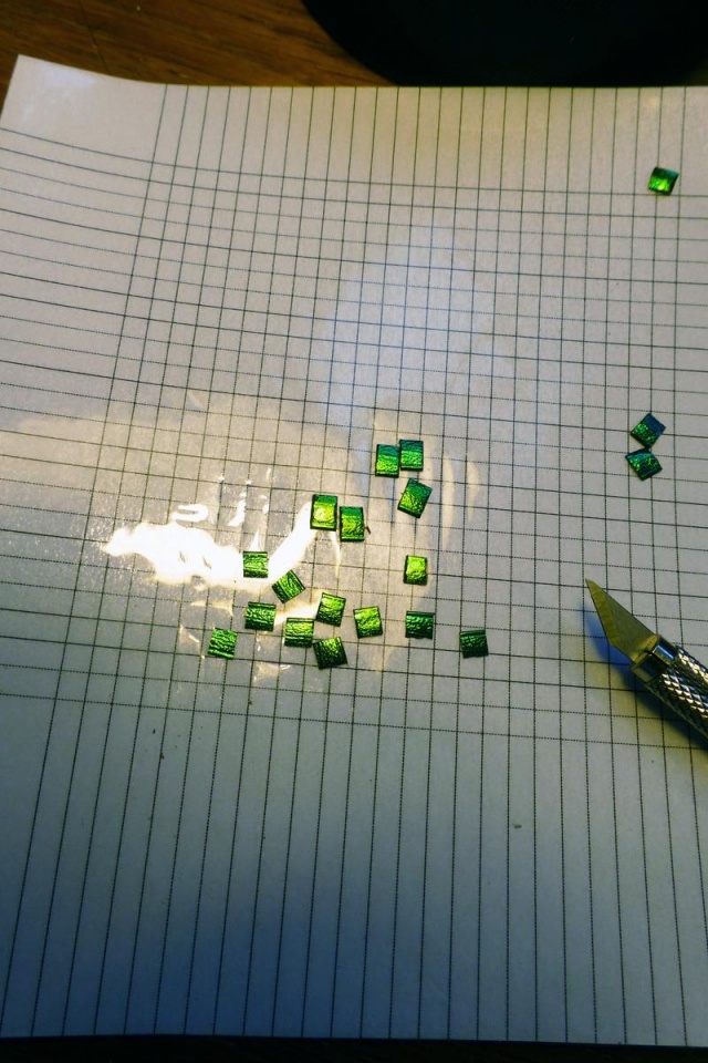

Last week I have made some cuff link parts for a local jeweler.
The plates will be framed with white gold.

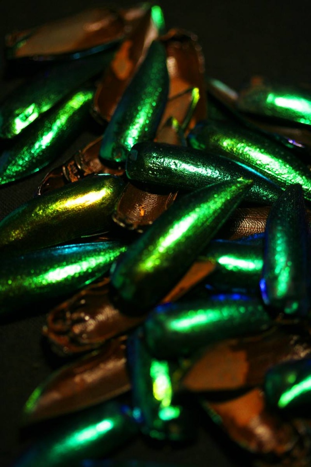

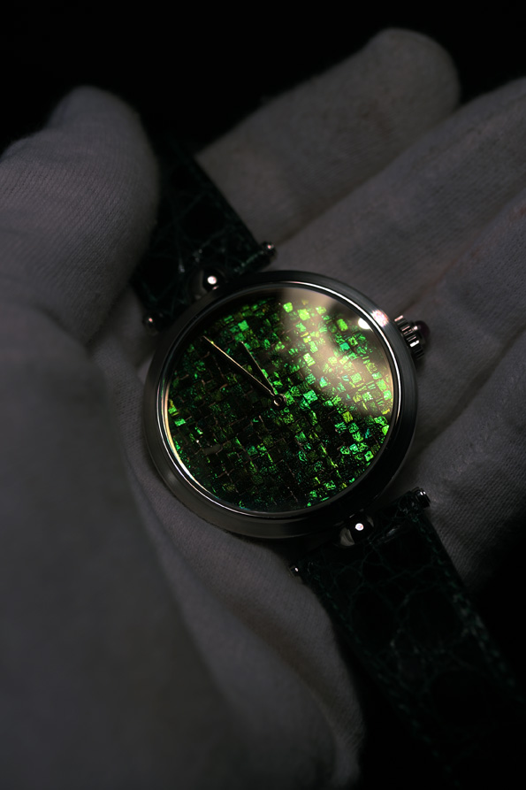

The plates are decorated with "Tamamushi", fragments of the wings of the Jewel Beetle (Tamamushi). Tamamushi is a rare technique used in Japanese Urushi lacquer art. The little squares are cut and glued on the base with urushi lacquer. Some years ago I have used Tamamushi for making watch dials

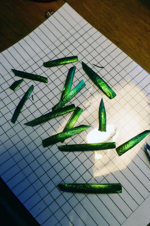

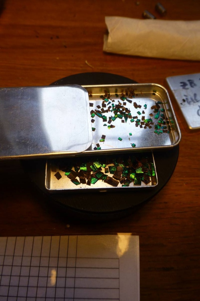

I am making tests for application to a pen. The problem is, that the wings are flat on the outer side but the inner side is very bulpy and the wings canot be ground flat. Different to mother of pearl for example.

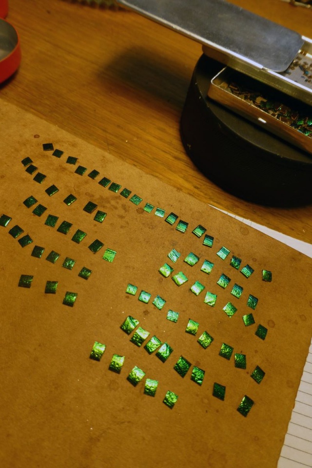

I see that the wings are available, but I'm having trouble figuring how to work them. Do you steam the wings before you cut them? Do you cut them longitudinally with the hobby knife, then cut the strips into squares?

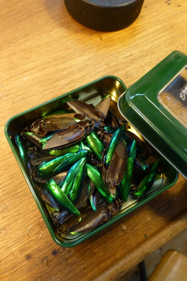

The wings contain oil. They have to be boiled for several hours in hot water. I cut them length with a scissors and then the sqares with a paper knife
