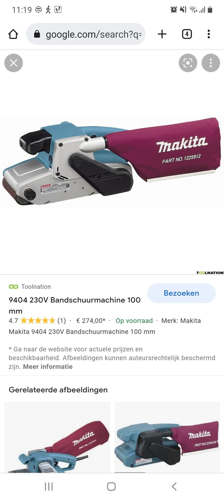

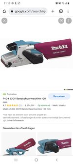

I have one of these. I could buy a grit 40 band and make a jig where the corner of the blank sticks out and grind it down. That's worth a shot and costs almost nothing before buying expensive tools.

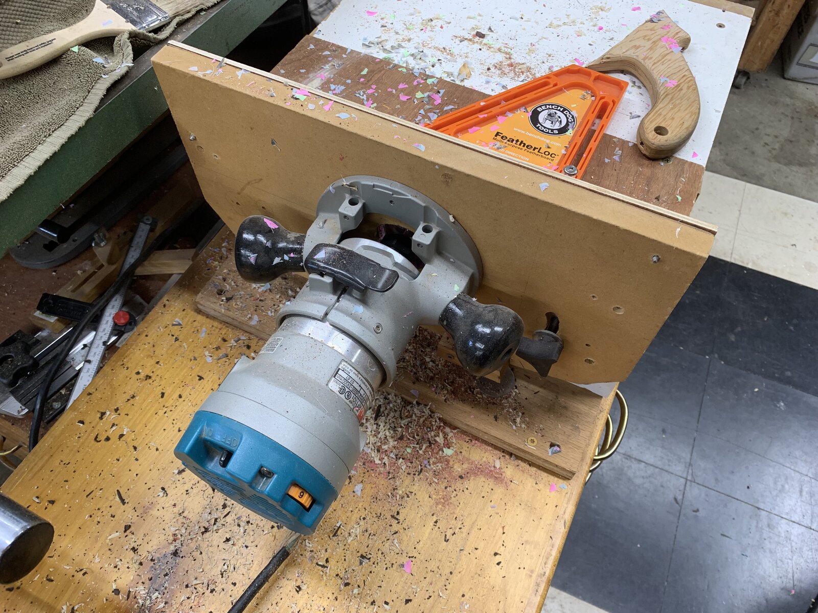

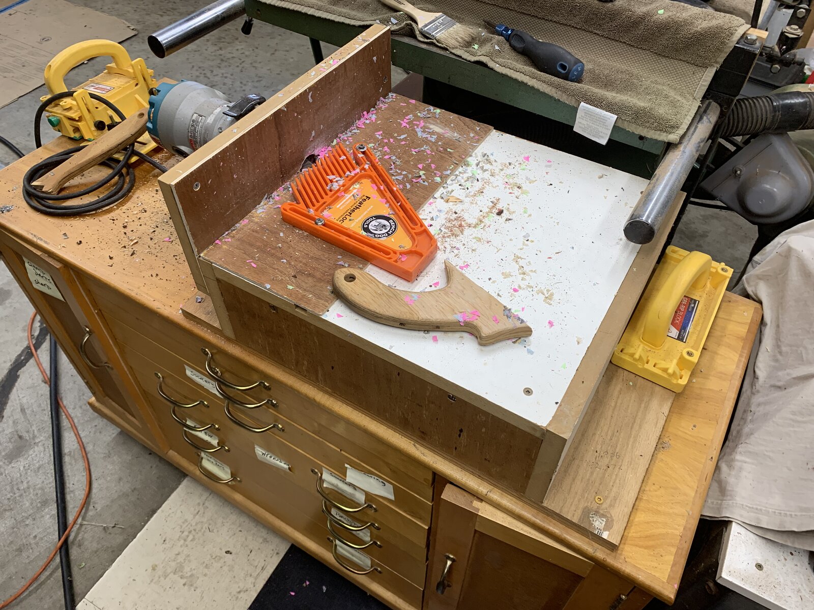

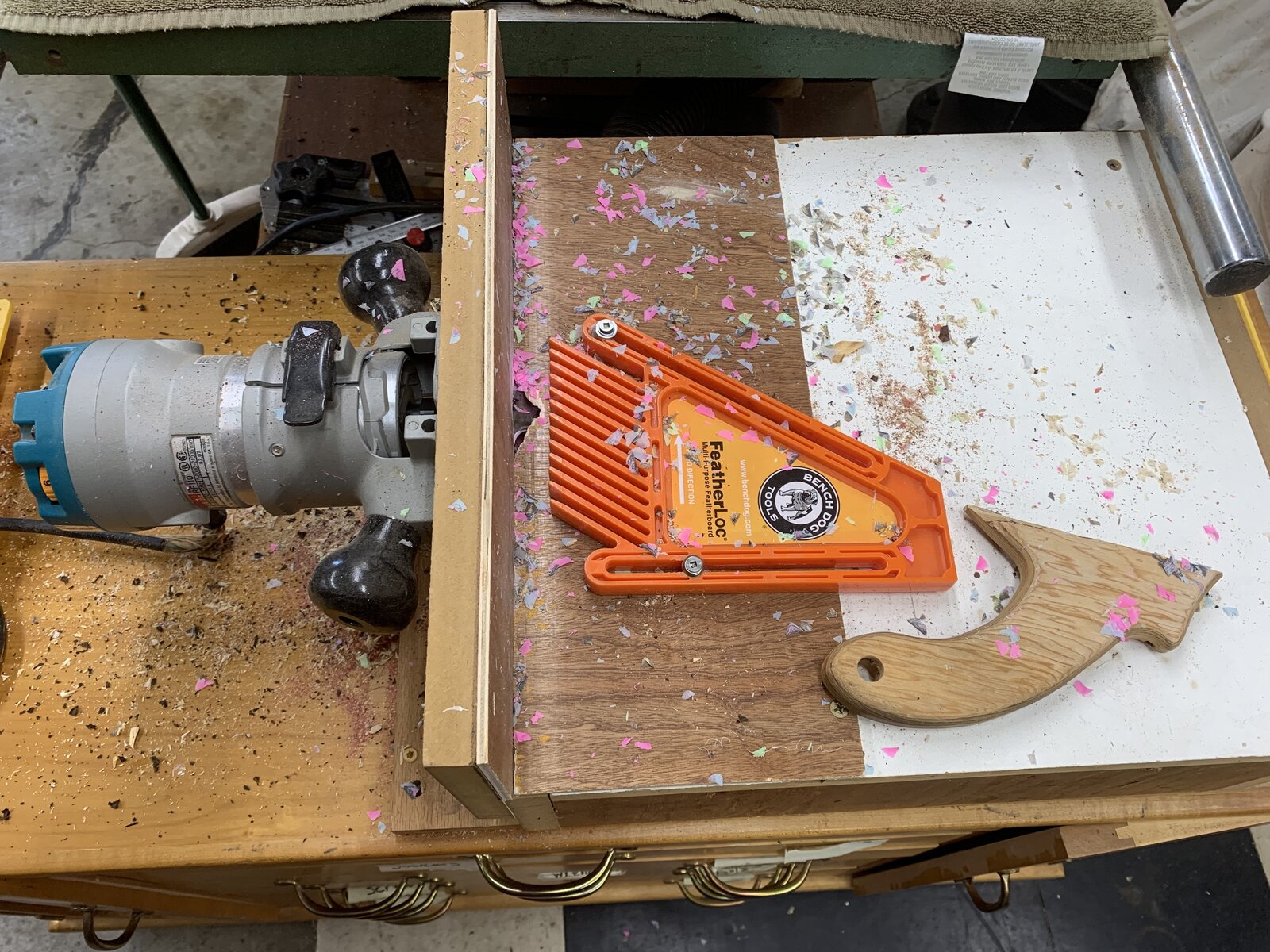

This is what I use. A big time saver if doing a group of blanks. Center drill the blanks while square, run through 4 sides, then two passes on the lathe between centers and the blank is ready for a collet.
the horizontal router table is very useful. Plans from fine woodworking.
