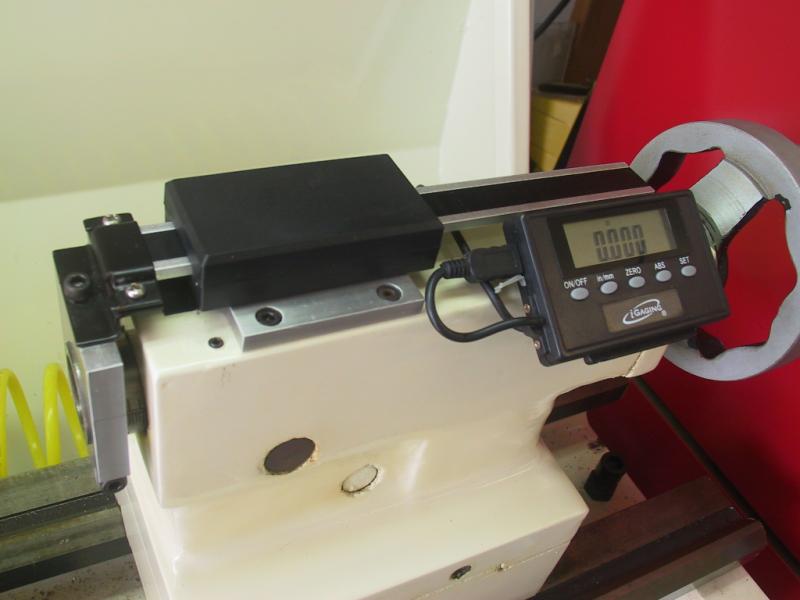

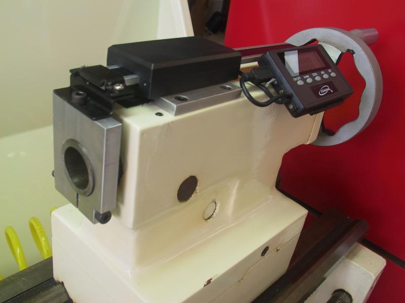

Considering how many of us drill to a specific depth I though some folks might be interested in this modification I made to my tailstock. I don't know how others do it but I used to either put a sharpie mark on the drill bit or wrapped masking tape around it. But that was tedious and not as precise as I'd would have liked.
So I got this digital scale with a remote display from Grizzly. I made a couple brackets, one for the tailstock quill, and one for the reader, and tapped a couple holes in the tailstock. It works great and it's way more accurate.

Nice Idea, DRO's are great, except for the stupid spindle DRO, WHY?? did they bother with them. but I like you tail stock DRO, I want to get a new 13 or 14x 40 with DRO on both axis and putting one on the tail stock is just too handy to do with out.

Thanks for posting this Mike. I'm using the Sharpie method currently. I wonder if there is a DRO to fit my Microlux. I should check on that.

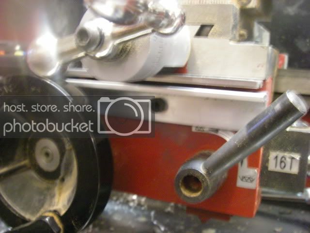

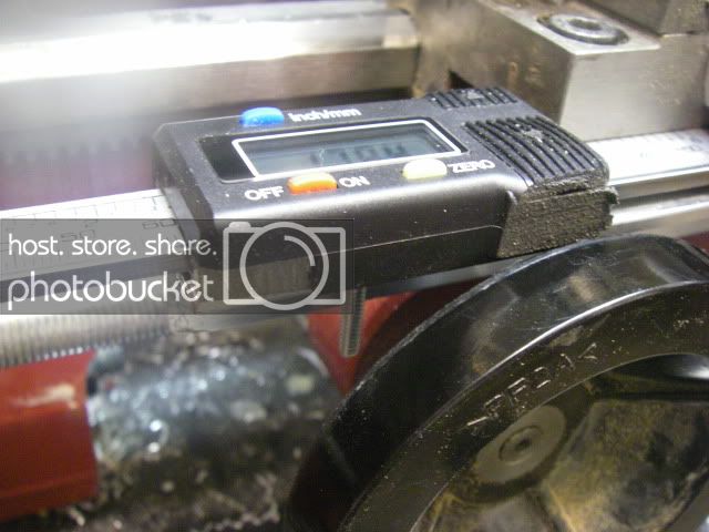

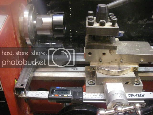

Definitely on the want list. I rigged up a DRO using a digital indicator from HF to measure depth of cut on the cross slide. I read where there is a magnet attachment available to go on the indicator that could sit on top of the TS and all you would have to make was a stop for the plunger. I still have plenty of sharpies left in the garage, but yours looks too good to resist. That is some nice workmanship. I saw that Shars had some of these available that were fairly affordable too.

Cris, I'd like to see how you rigged the caliper for the crosslide. George (texatdurango) want to do the same thing on his 9x20. I know it can't be that hard but people are always talking about the room they lose getting the tailstock up close.
The magnets for holding the indicators are pretty cheap. I've got one but right now it's being used like a fridge magnet:) Using an indicator for the tailstock is fine for shallow holes. Most of the indicators only have an inch of travel so it wouldn't help much for drilling pen blank holes that are between 2 and 3 inches deep.
With the indicator you still have to make the part that's clamped to the tailstock quill for a stop. As long as you've gone to that trouble you might as well mount the caliper to the tailstock and be able to measure all the travel.

I did something similar to this:
http://www.machinistblog.com/a-homemade-dro-for-the-7x-mini-lathe/
I used a scrap piece of 1/2" aluminum round stock. I should have got some square, but that is another story. I drilled a hole in the bar and epoxied a bolt and some neodysuperstrong magnets from ACE hardware to the end and bottom. I attached it to the back of the carriage. Also took a small shelf bracket and made it fit between the bolts along the right side with some more magnets. This part moves with the slide and pushes the indicator. Pros: it does work and is cheap and easy. Cons: you cannot overshoot your target diameter. Best thing to do is sneak up on it slowly.

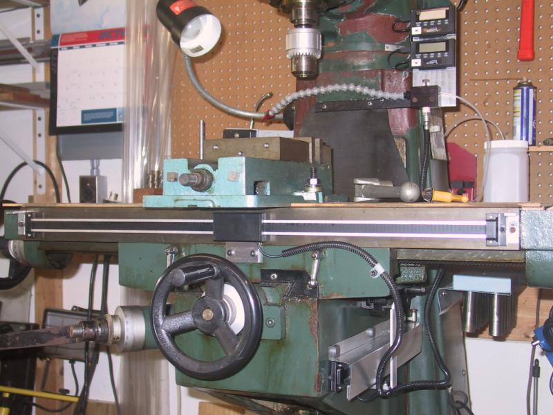

I really like these things. George is right, you can put them on all kinds of tools. I have a DRO that came with my metal lathe. I always wanted to put one on my vertical mill but for $600 or $700 that wasn't gonna happen anytime soon. After putting this on my tailstock and seeing how well it worked I figured why not try it on the mill. They have these in 12" and 24" models too so I bought one of each.
The picture of the X axis might be of particular interest because this is pretty much the setup to put one on X axis of a lathe. Normally there's a swarf cover (fancy name for a piece of aluminum roof flashing) to keep the crap off the scale. There's also a picture of the displays mounted up where you can read them as you work.
The displays come with little brackets you can mount to anything and clip the displays on them, or you use the magnets that are on the backs of the displays themselves. Again, way easier to pop off the backs of the displays to change batteries rather than disturb the scales.

That is very nicely done Bluwolf. I have for some time been trying to convince myself to spend about $500-600 on a glass scale DRO setup on my DM45 (RF45 clone) mill.
I have seen the scales you used and wondered whether I should just put them on, I think you have concinved me to go that way, very neat.
How do you find the accuracy?

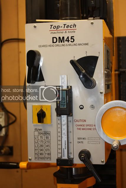

I already have a small DRO, a butchered digital caliper, on my quill and it works fine.
bluwolf
Oct 2, 2008
995
SW Florida
Fred, I find the accuracy to be just fine. But then I'm not building space shuttle parts either:biggrin: And as you said, it's a big jump in price to get to glass scales.
When I finished putting the scales on I tested it by sticking a squared up block of metal in the vise, and a Thompson shaft I use for checking runout in a collet in the quill.
After that I touched off and zeroed each display. Then I just ran the table around a bit as if I was machining something and then came back and touched off each axis a few times. The repeatability was great.
BTW, I did the same thing on the quill of my mill. Considering how much slop is in the "fine" feed of these things it really helps a lot. Everybody says they like pictures, so...
BigShed, do you have TWO milling machines? A bridgeport and a XX-45?

I installed the one Barney mentioned from Grizzly over the weekend.
http://www.grizzly.com/products/Mini...out-Kit/T10118
It was a little long so I had to cut the bar so it would fit the tailstock.
Works great!
