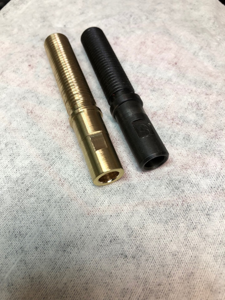

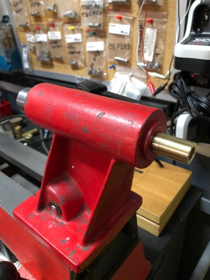

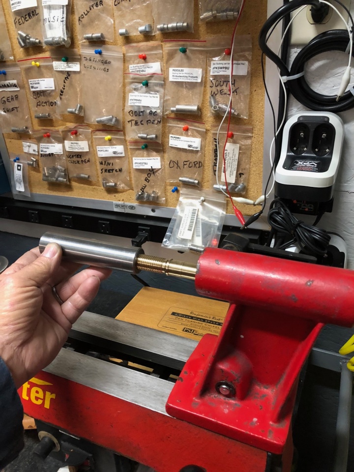

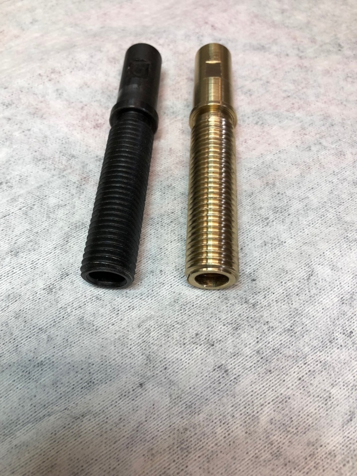

The Turncrafter lathe that I bought with all the tooling and gobs of bushings, blanks, pen set and on and on it goes was a deal that I had been hunting for, I was ready to by a starter kit from PSI when I found this, guess it fell over once in it life and the tail stock Quill was bent,(look at Photo 2 you can see that it is bent from the shoulder on) may try to straighten it later, not real bad but had a wobble and slack in the housing on the tail stock out board side, I decided to make another one, this one is made out of Bronze, make it slight over size to take care of the play in the tail stock, it is 2MM thread and left hand also, that thing took me about four hours on the metal lathe but works perfect, cost was zero got the shaft from an old boat, Pen Joe
