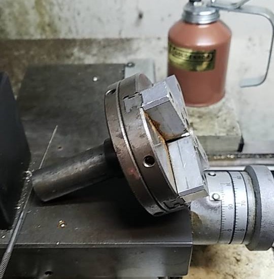

Rather than make or buy a 1 1/2 x 8 to 1 x8 adapter. just make a straight shaft with 1 x 8 threads and chuck it up in your std 3 jaw chuck. By indexing everything you can keep your accuracy.
attachment.php
