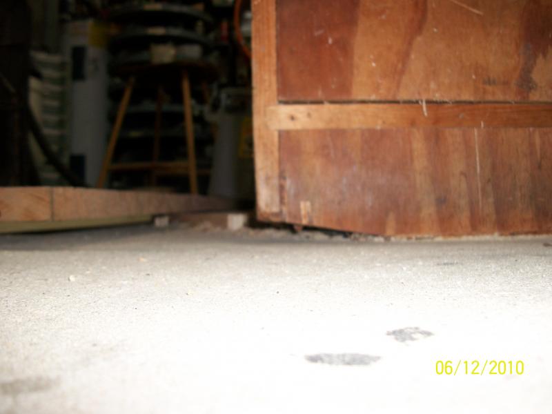

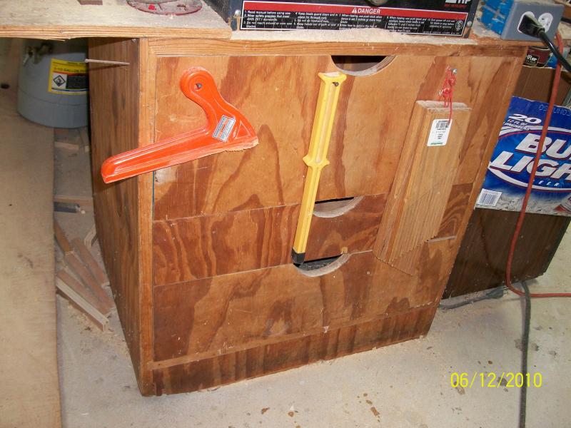

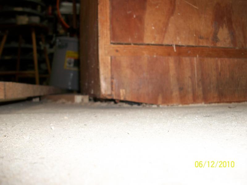

Here is the base I made from a plan in Wood magazine. The angle on the bottom is where the casters are. Tilt the base up and the wheels hit the ground. Makes for a very stable base. Hope it helps.
