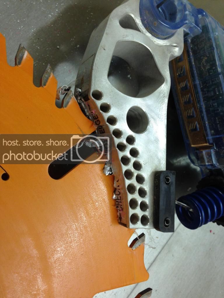

The fit and finish on these saws are amazing, it is like tools you used to be able to buy. I could not beleive the dust collection, if you are ripping a board there is almost no dust. The fence is rock solid and accurate. They are a very nice saw. And from my picture you can see that they do work. I was cutting a piece of Tru-Stone that was a little to small, other than the noise and the sudden stop I didn't know that it even touched my finger.

I am a profession contractor and have owned just about every table saw out there...I currently own a bosch and sawstop.....Lets just say the bosch never gets used.....Sawstop all the way...expensive but well worth it...I had a friend of mine that is in the cabinet business. One of his employes had a table saw accident. He had all guards in place and everything was inspected as per code. Sill cost him 6,000 dollars. After that he sold all of his table saws and bought 4 sawstops....Just make sue if you do get the sawstop to get a good moisture meter. Again its hard to put a price on your health. plus the saw is top notch quality.
