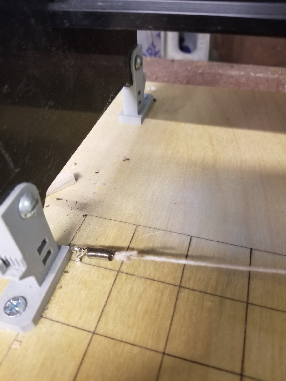

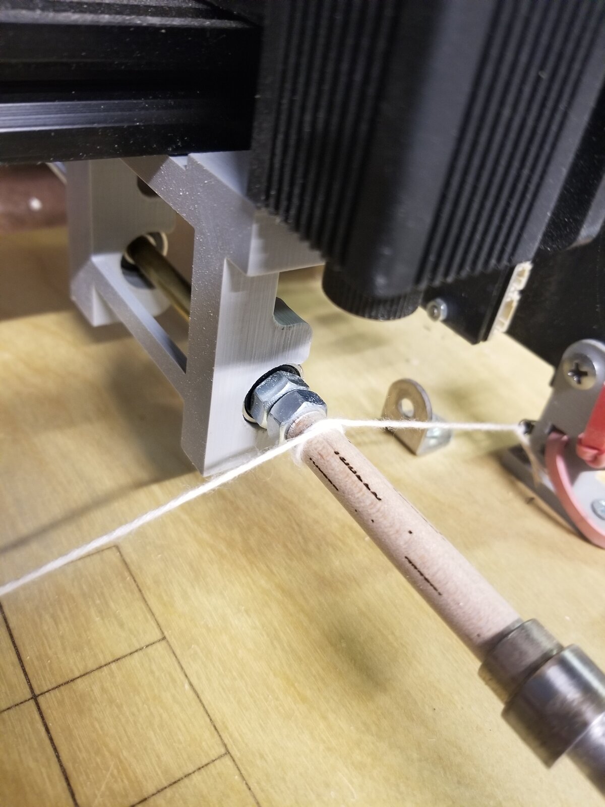

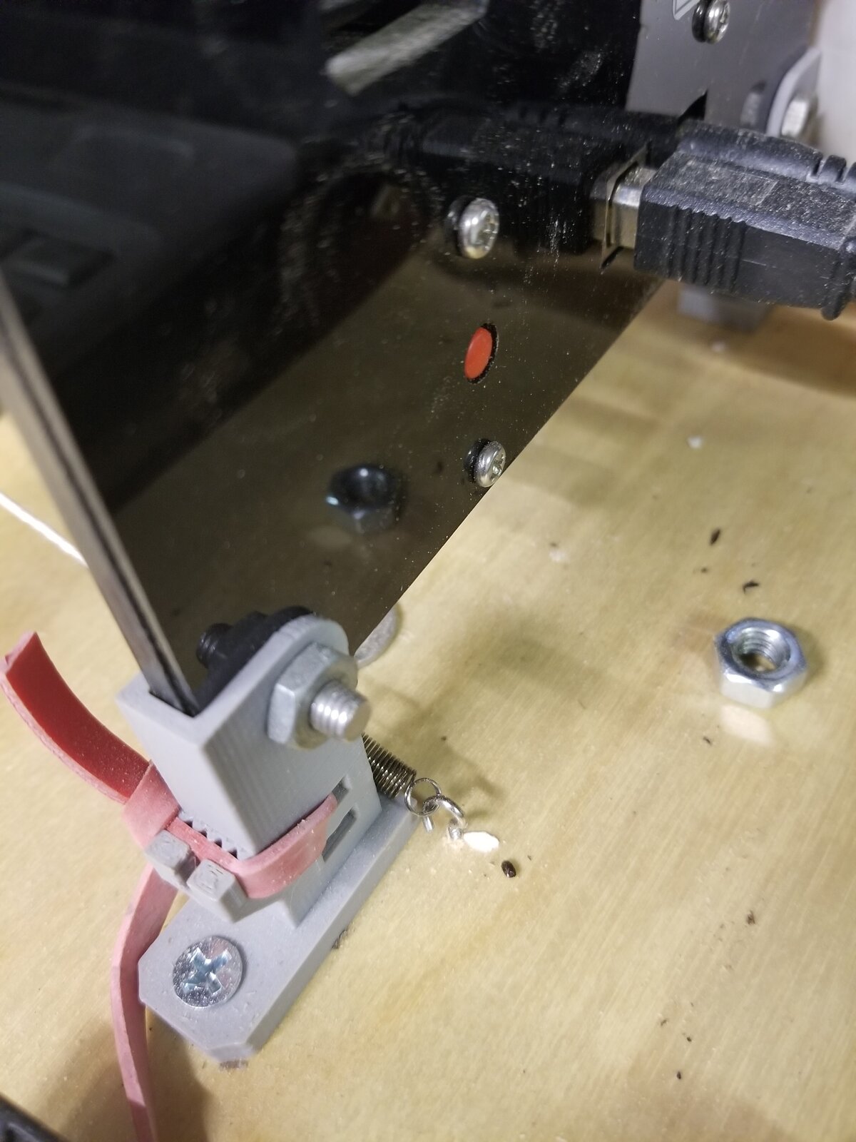

I have the t shadow but have got a couple of eye hooks and a string to drive the pen vs the rubber band like the benson pace jig. That solves all my issues with lines and odd starts to the tops of the letters when engraving.

15917942185233193622782778431639.jpg1591794179092710642613455670047.jpg15917941986683824516181192030667.jpg15917942185233193622782778431639.jpg
Here are some pics of the setup. The springs were from home depot the item number is 471 864 spring assortment kit. And the eyelets are ones that I use for Christmas ornaments.
