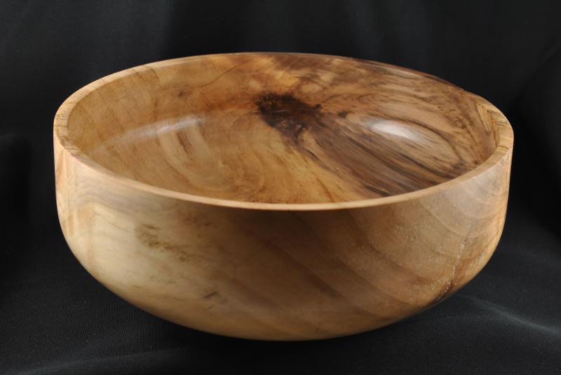

Since it was snowing in Bossier City today :eek: left work early and headed to the shop. Decided to work on a bowl. Sweet Gum, about 7" dia. x 3" tall.
Finish is BLO + paste wax mixed together and applied while sanding.

Really nice work. I'm going to get back into bowl making experiments as soon as it warms up. I'm no bowl turner, that's for sure. I really need lessons from someone.

John, Nice looking bowl!!! I have plenty of sweet gum trees here in Alabama that I'm going to cut down. Have been burning but now I might turn a bowl. How long did you wait before turning that bowl? Can you turn them green? I would think there is plenty of water in them. Gary

I turn all my Sweet Gum bowls green then return them months later. Unfortunately it is not a local tree for me so I have to buy the stuff, but it is well worth it for the fantastic look.

If you turn sweet gum green and plan on finishing it out when it gets dry, you better leave about 30 to 50 percent more thickness than you would with most hardwoods. The stuff warps like crazy and tends to crack more than most woods too. But the ones that survive like that one are really pretty. Good Job!!

Rangertrek ... Very nice bowl you have made and I like the finish too.
