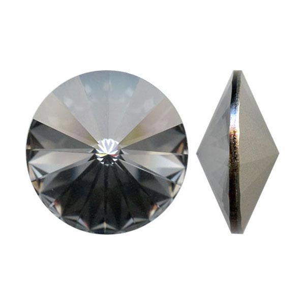

Thanks John. I've custom cut one with wood and will no doubt do more of them. My concern here is that the crystals are already smaller than the opening of the stock finial by about 1 mm. I'll have to just try it and see how it works out. If I drill it out just right, I can probably use the chamfer from the bit to make sure it's centered (most have the pointed back) and just hope the extra space doesn't look too awkward there.
This is what I plan to use, but in a 10mm. The 12s are too large and I definitely don't want to try trimming one of them. I do have a couple with flat backs, too.
