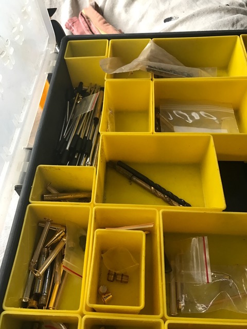

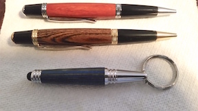

My friend finds things in our neighborhood along side the road. Long story short he found some pen stuff and asked if I would like to the lot of it. I said sure and am trying to figure out what I have. I believe some of it is pencil and the other pens. Trying to figure out what is what. Anyone well versed to be able to tell what I have......so I can figure out what if any pens I might have.
I can post a picture of each item identified. Appreciate the help seriously.

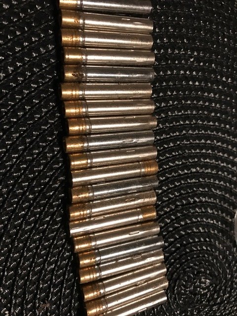

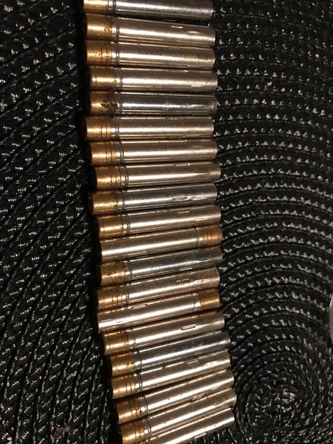

Here is what I understand to be a pen transmission.
Not sure if most pens use the same type of transmissions.

parts
Well from what I can see I have 20 of them.

Transmissions are for slimline.

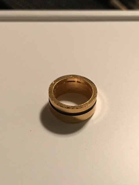

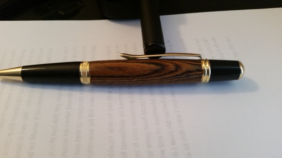

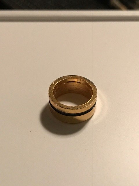

The ring could be for one of a number of kits ... looks like Flat Top American or a pen similar to that one.

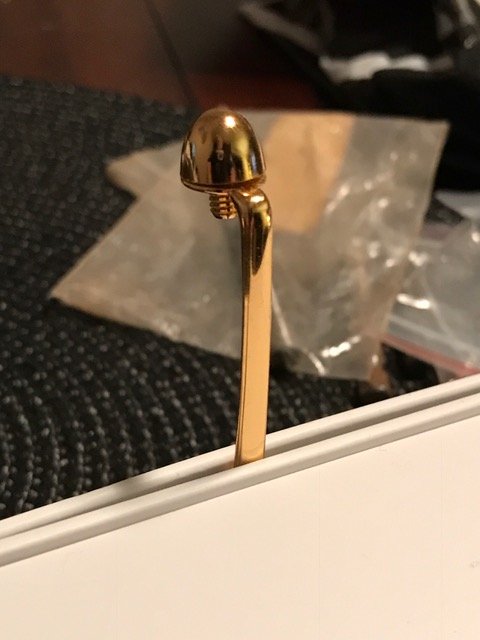

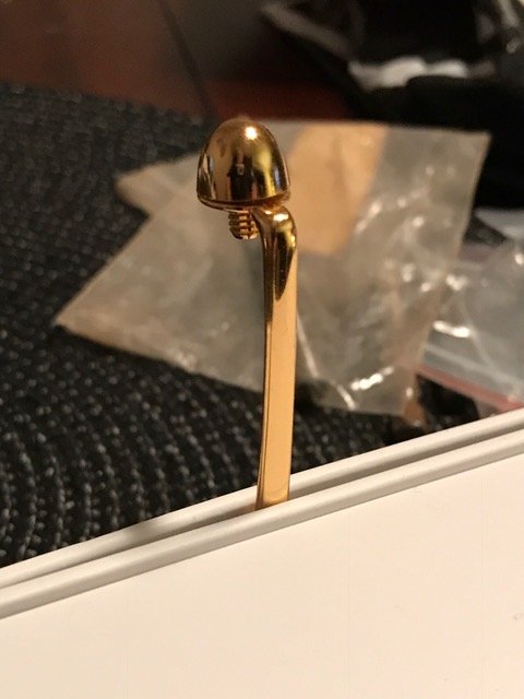

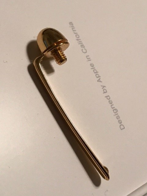

Know this pen top?
Ray
That top is a "Designer" or "Euro" pen kit top. I believe the center band is also part of that kit.
Edit: Oh, I see that's already been answered.
I agree - that cap/clip is not a Streamline or Trimline part. It could be from a Creekline but that is unlikely given the other parts he has.
