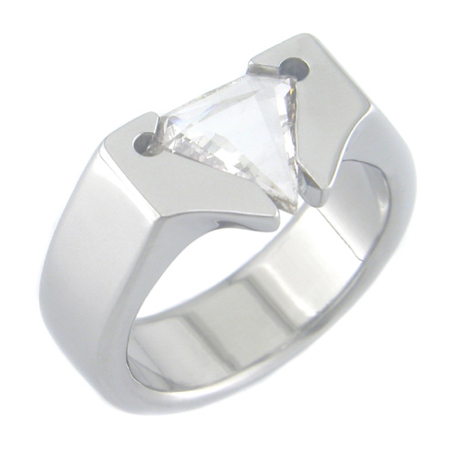

Here's a new ring I did that has a strange diamond, almost in the shape of Superman's emblem. The ring is made from titanium and the diamond is very flat and has no girdle at the pointy end. It was quite a challenge to make and have the stone fit properly.
Very different. I think it looks pretty cool in person.

That's a stunner for sure!! Did you have the diamond cut like that, or buy it because of it's shape already? I'd love to see the tiny cutter that you use to cut the retaining groove.

That one was a custom one to match a stone that a customer had bought. I had a hard time visualizing what he was talking about until I saw the diamond myself. I've certainly never seen a stone like that before. We talked back and forth and came up with a design that he liked.
The undercutting tool was like a tiny sawblade on a shaft. It was about 2.5mm diameter and .5mm thick. I had to make the retaining groove get wider as it got to the point. It got to almost 2mm wide near the point.
