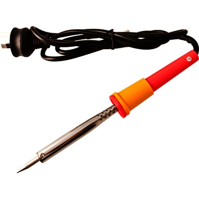

How about using BradG's etching method on a piece of aluminium or brass. Depends how deep the etching needs to be, and if it can be done without too much undercutting. Or do an initial etch and then deepen it with a Dremel and fine milling bit. You could also apply a paint on resist(nail polish or paint ?) to the sides of the etch and then re-etch to get a deeper etch without undercutting.
You could even insert it into a simple soldering iron if it is made from a rod of the right diameter. Or make a bugle shaped piece so one end fits into the soldering iron, the other would give you a round stamp. If you don't want round it can be filed rectangular, or any shape you want.
